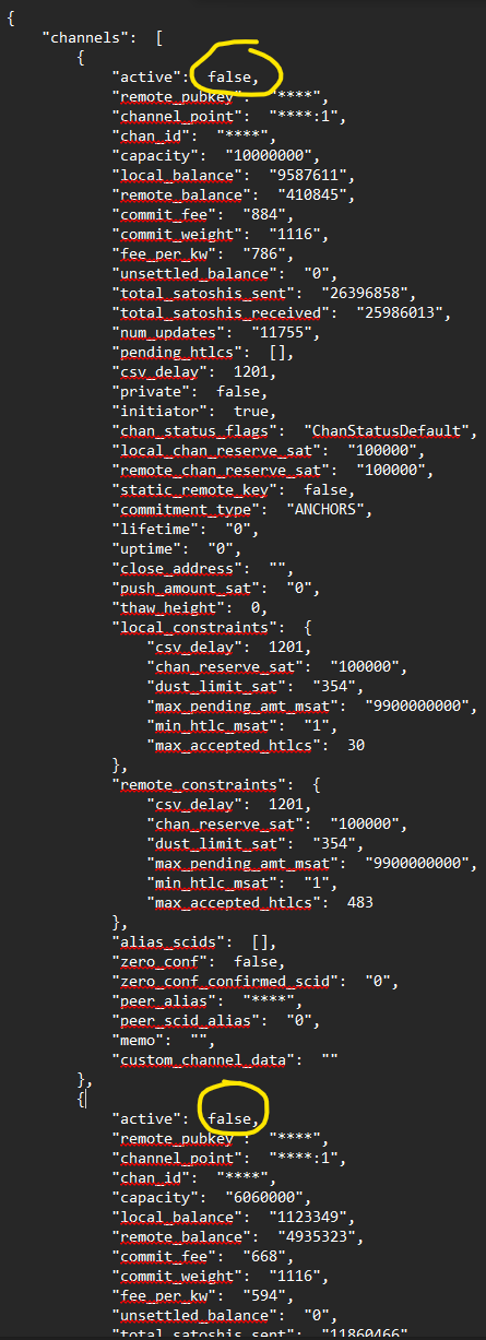

Can you help me understand what this means? Any thoughts on what I should do next to resolve the “server” not having “started”?
lncli --rpcserver lnd.embassy getinfo shows this:
"version": "0.18.5-beta commit=v0.18.5-beta",
"commit_hash": "***",
"identity_pubkey": "***",
"alias": "***",
"color": "#***",
"num_pending_channels": 0,
"num_active_channels": 0,
"num_inactive_channels": 131,
"num_peers": 0,
"block_height": 904106,
"block_hash": "****",
"best_header_timestamp": "****",
"synced_to_chain": false,
"synced_to_graph": false,
