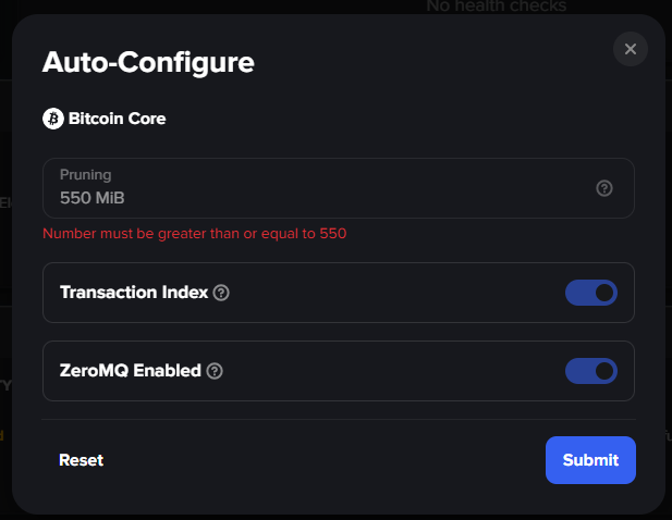

I updated Fulcrum and Mempool to the latest versions and now both services think that my Node is pruning.
I left the setting empty on my Bitcoin Core settings screen:
But the services seem to think that it needs to be set to a number at least as big as 550 (so empty does not seem to do the trick here).
Am I doing simething wrong or is this due to the updates?

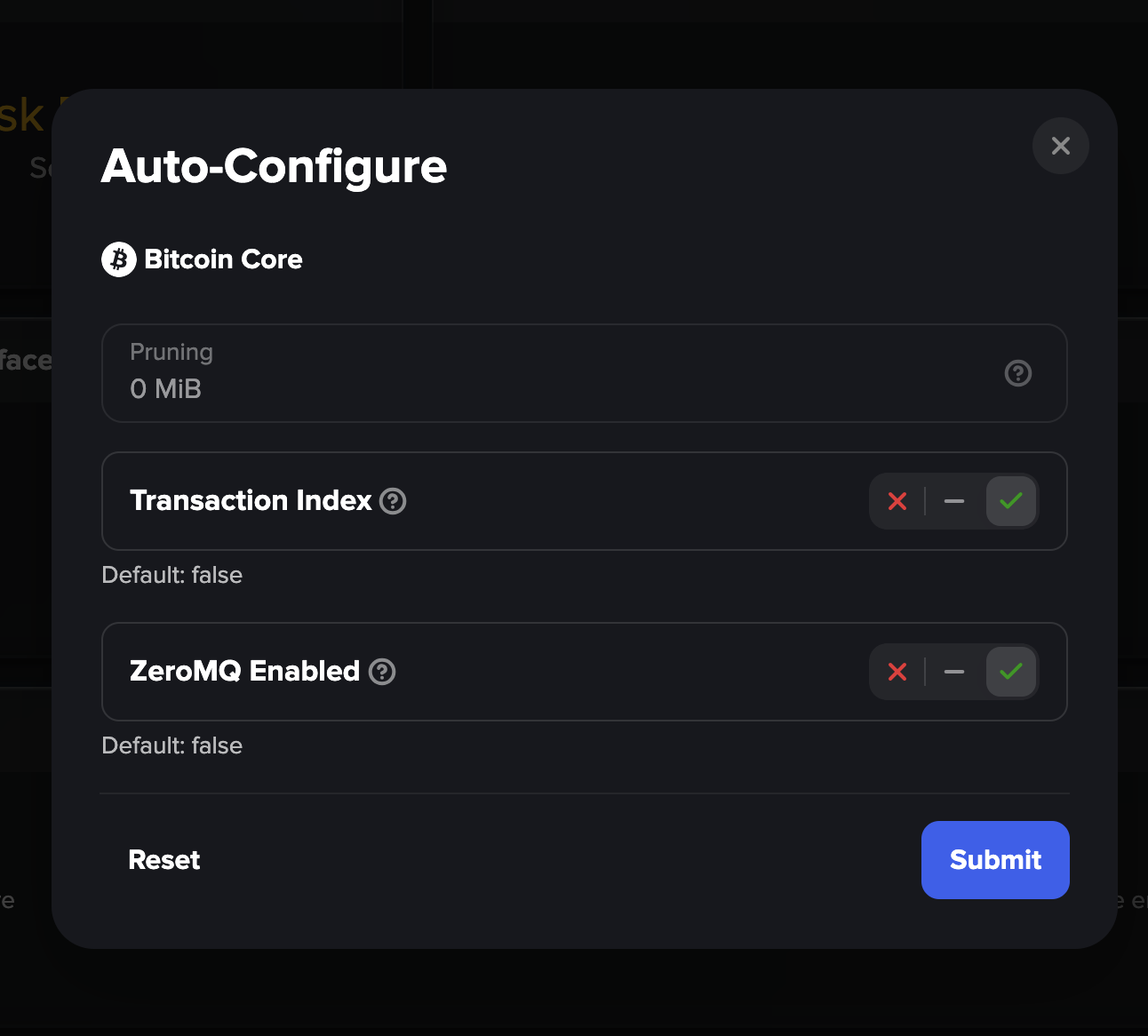

Looks like you’re testing Beta software… with last weeks builds.
You’d need to update to the latest versions… but also keep in mind the the latest versions introduce another bug, this bug would mean that you’d need to stop services that depend on Bitcoin until Bitcoin is fully started up.
Yes, I’m running beta-7. The services in question are displaying “Task Required” with the uptime timer showing zero. This indicates to me that the services are indeed stopped. Bitcoin Core is fully synced and running.
The task button within the services does not allow for a submission of zero or empty for the pruning setting.
This would suggest you’re not on the latest versions.
The task in Fulcrum 2.1.0:9 works just fine…
Please update the three services in question.
Unfortunately, it’s not the solution. I’m on the latest version (2.1.0:9)
And the ’pruning’ setting is still greyed out with the 550 MiB warning.

You say you’re on the latest version of Fulcrum, but you’d need to upgrade to the latest of Bitcoin.
Okay, understood. That’s unfortunate, as I am running v29 on purpose. But thanks for the patience.
