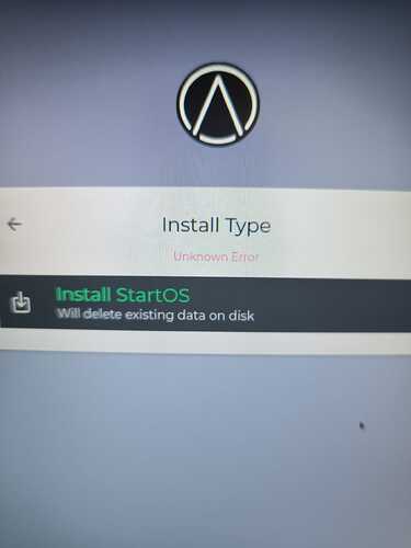

SOS = just can't install StartOS on Optiplex 7040 - systematic "No Bootable Devices found" error

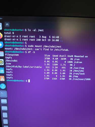

What output did you get from this command when you ran it? If there were no errors, see what you get when you run this:
ls -al /mnt

Maybe we can check if it is really mounted (or maybe it is mounted somewhere else). After running the “sudo mount /dev/sda1 /mnt” command, see what output you get from:
df -h

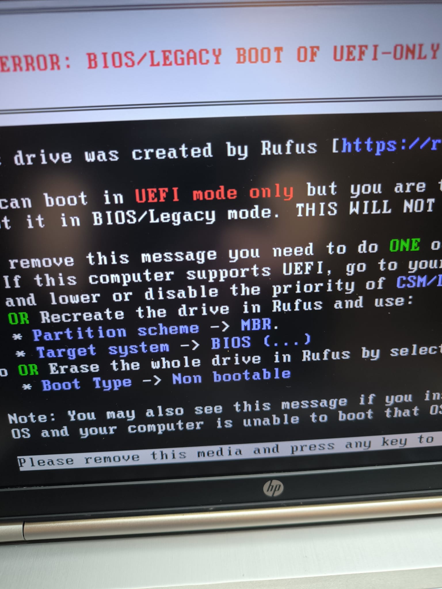

First I used “GPT” to build the Ubuntu live system USB-Stick. But I got this error when booting:
Then using MBR, it worked.
this time I have got an error:
You missed the space between /dev/sda1 and /mnt
oops…
But now it’s this error:
Weird. I assume it worked before? Do you get the same error after reboot? If so, try re-installing StartOS, then boot up into the Ubuntu USB thumb drive again, and before running any other commands, see what you get with:

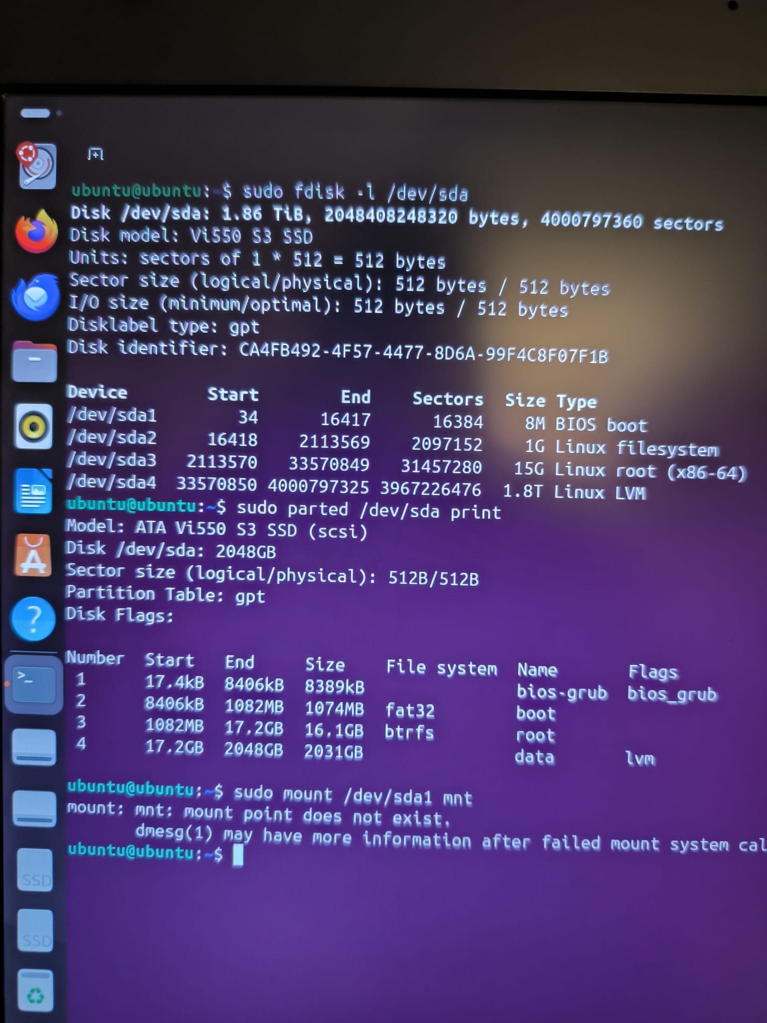

Yes it worked before. I reinstalled StartOS and booted into Ubuntu USB-Stick.
With the first 2 commands I got some output. And an error on the 3. command:
You missed the forward slash in front of “/mnt”. But anyway I can see from the first output that in fact /dev/sda1 is not type “EFI System” like you mentioned it was before. It now says “BIOS boot” the way I would expect it to. Maybe StartOS will boot now?
But I found the EFI-System entry. No, it still doesn’t boot.
Sorry, I don’t understand what you mean by “finding” the EFI-System entry. In your screenshot there are 4 partitions. “BIOS boot” (8M), “Linux filesystem” (1G), “Linux root (x86-64)” (16G) and “Linux LVM” (1.8T). That looks like a normal legacy BIOS setup, not an UEFI system. In any case, the process outlined by the OP is not applicable in a non-EFI setup.

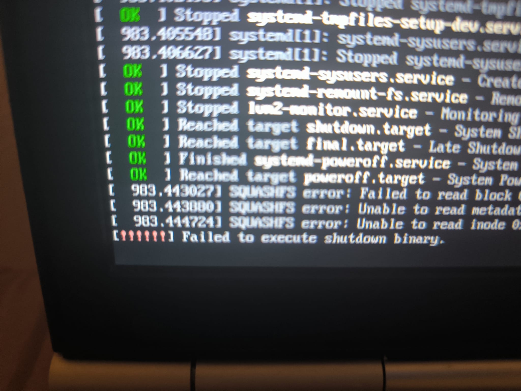

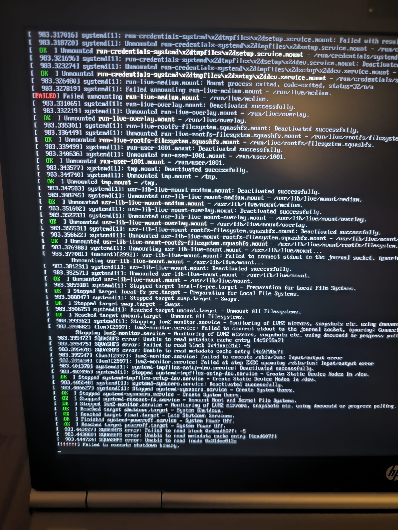

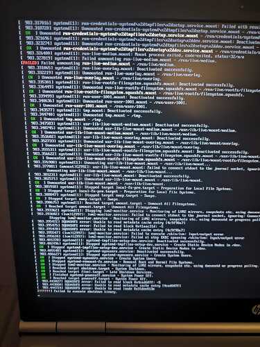

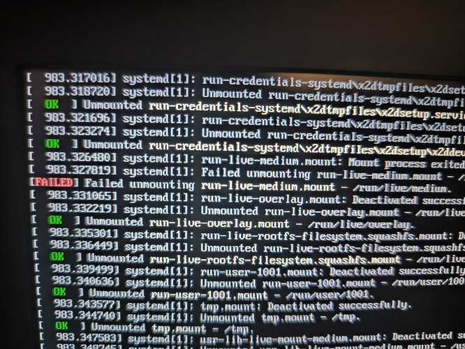

Here are photos of what my monitor shows when starting without USB-drive, I have no idea what it means:
Yeh, not sure. That output looks like a shutdown sequence, not a startup sequence. I don’t see anything useful in there myself (including what might have triggered it to shut down, which would have been earlier in the output presumably).
I made the shutdown by holding ESC key after the failed reboot.
Anyway, thank you very much for your time and for trying to help me!

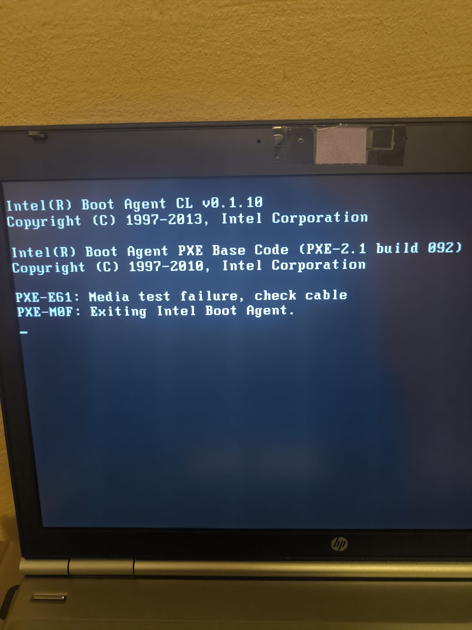

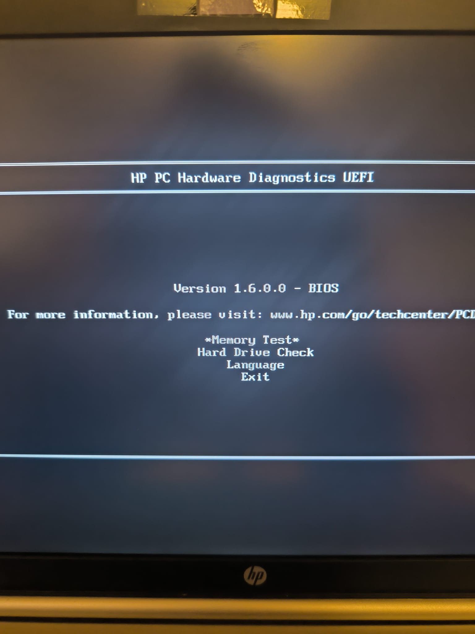

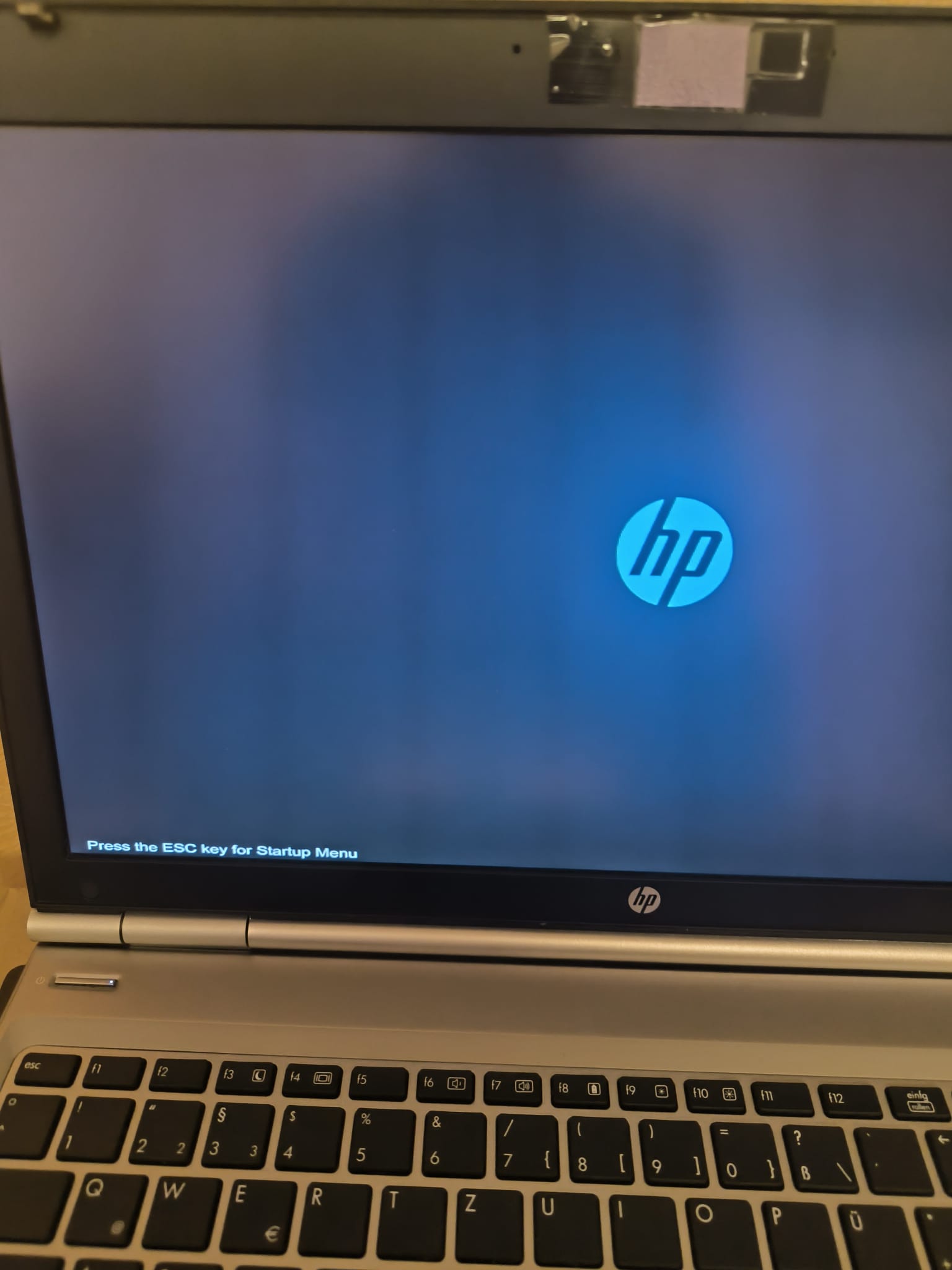

I see. To be clear, I wasn’t interested in what happens when it shuts down, though, but rather what happens when it starts up (from the hard drive, not from the installer). What do you get if you power down, unplug all of the USB thumb drives (including the installer), hook up the monitor, and then power on the device? What does the monitor show at this point (prior to shutting down again)?

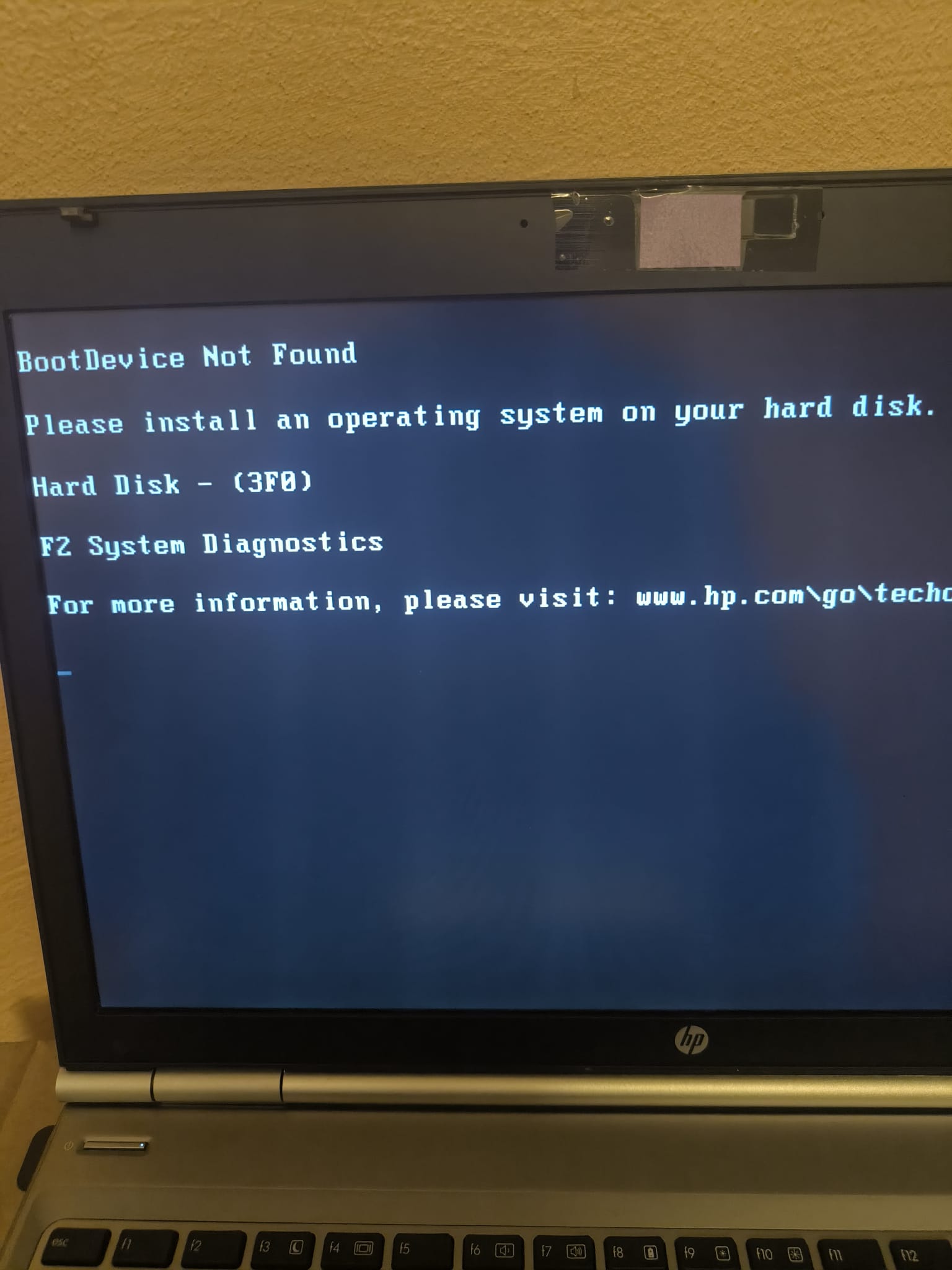

Sorry, I thought it did a shutdown. Now it shows this screens:
(UEFI in the headline of the last picture?)
Interesting, that is strange indeed. What model is your laptop? I’ll see if I can find anything online about it.
