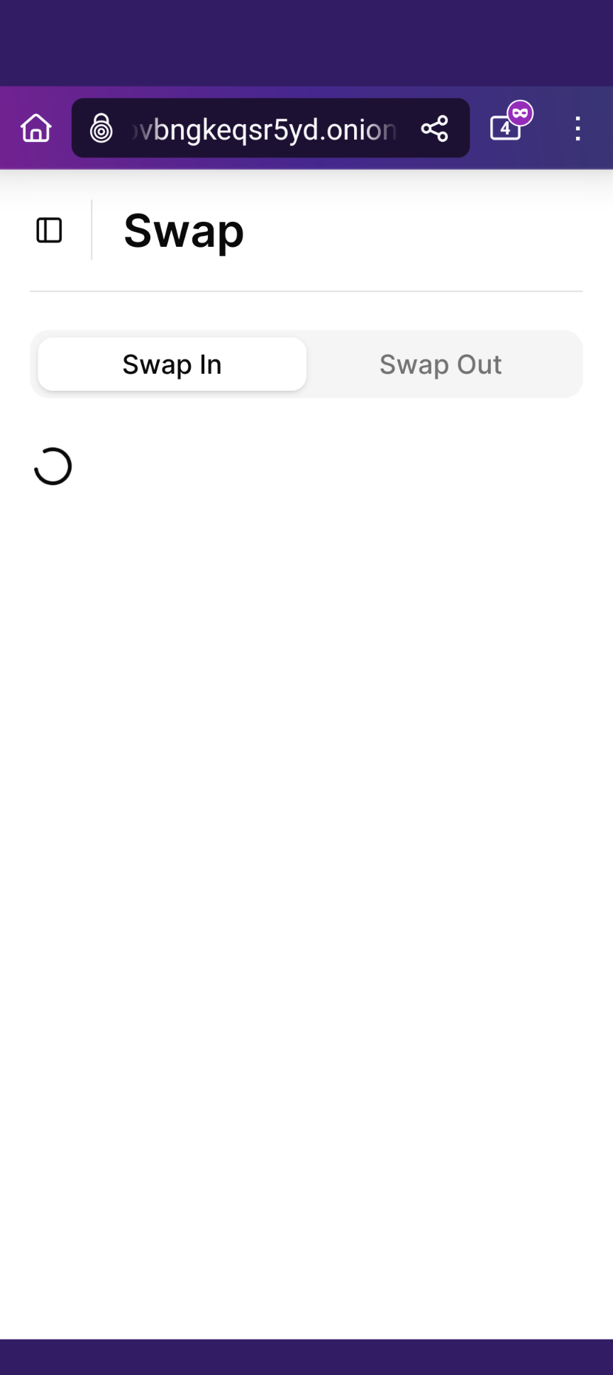

A couple months ago I did a swap and it worked fine however today the swap in/out page just keeps loading and showing the spinning symbol. The app is self hosted on my start9 and even did a restart but still not working. Any ideas on what else I could try?

Same issue ! Since a coue of weeks I’m trying to swap but it doesn’t work. It’s frozen before to show qr code. Any idea ? Until last Alby upgrade it was working well

Just want to point out that start9 registery in the marketplace has a new update for alby hub. Version 1.22.2 which was released May 25th. I’ve updated to this version and it fixed my swap in/out issue. Give the update a try and let me know if it worked for you as well.
