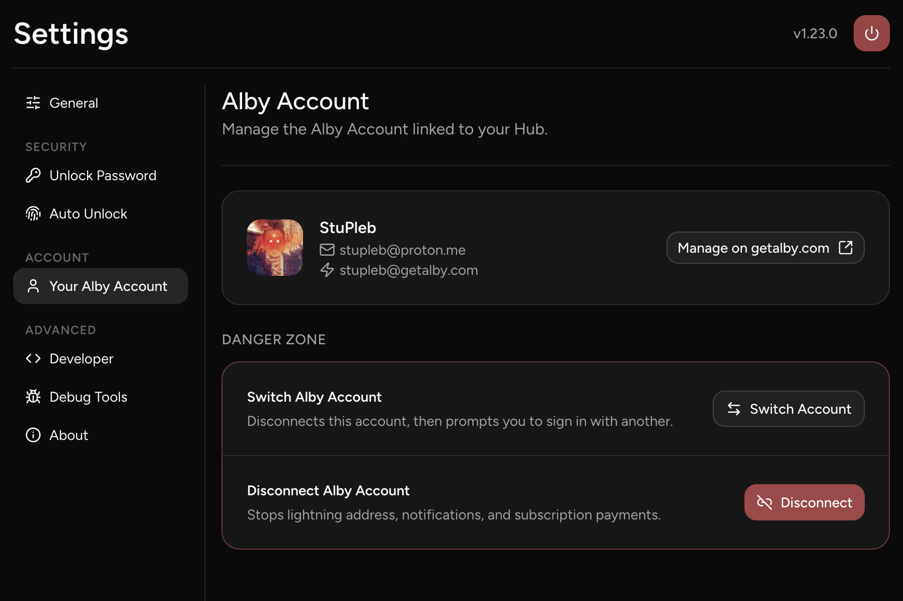

Within the Alby Web UI there’s a configuration setting to save the password so that when Alby restarts it auto-logs in. This would deal with power outages though, not internet outages. If the Alby service is never stopped on the server, it wouldn’t need to log in.
Anything else you’re describing, about authentication code, reconnecting with a remote hosted Alby account isn’t explained by the internet connected disappearing and reappearing. I’m struggling to see how it it could be related to the service on StartOS.
The Alby Account, while options, is baked into the service:
There’s no mechanism to unset that if the server is disconnected from the internet. The only possible way a bug like that could appear is if the service wasn’t persisting the data, so it sees a fresh Alby UI each time you restart the service. I take it that doesn’t happen?

AlbyHub Settings and enabling Auto Unlock fixed the problem for me. This was off by default. Now Albyhub / Alby Go is working on system / network reboot. Hope this helps.
