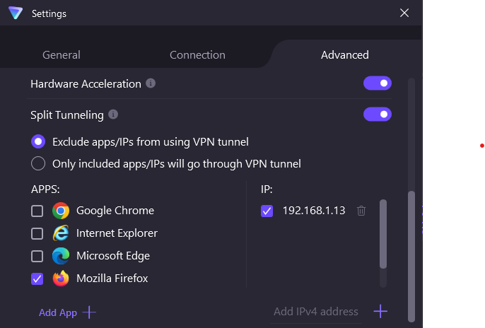

Im also unable to access start9 with ProtonVPN running.
I only use firefox for accessing my server, so I have told proton to not use firefox for VPN traffic.
try going under settings > advanced
Add whatever browser you want to use as an exclusion
I also added my routers address for the server as an exclusion
