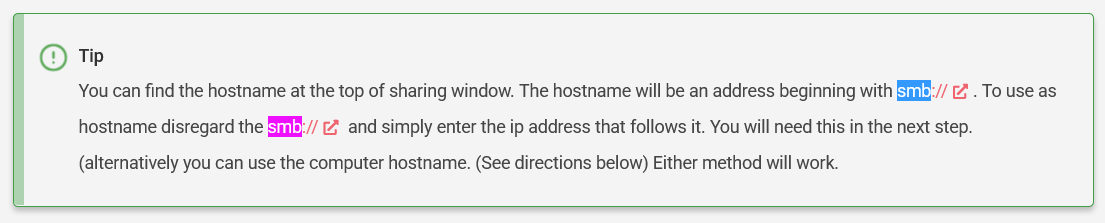

Hi - Also running into an RPC error when trying to add a new backup connection in Start9. I’m running Mac OS Sequoia 15.5 (24F74), firewall is not enabled, and trying to connect directly to the hostname (in the format of: smb://[HOSTNAME]). I getting the following error: RPC ERROR: Network Error name_query failed to find name
I haven’t tried using IP address approach but will try that next. I was hoping to be able to use the hostname. Eitherway, just wanted to pass this experience along! Thanks.
I think that “and” should have been an “or.”
