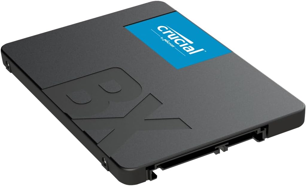

I was running the PI with External SSD and after a couple of years I started having the same problems, out of the blue, I then started checking the SSD and noticed that it was pretty full. My thoughts were that I had some how saved backups on there. I was getting pretty fed up with the flakeyness of the Pi as it can be quite temperamental. I shut it all down and purchased a Small Form factor PC
Lenovo Mini PC Desktop Computer ThinkCentre M93p USDT Tiny Intel Core i5 240GB SSD Hard Drive 8GB. I replaced the SSD with - Crucial BX500 SATA SSD 2TB, 2.5’ Internal SSD - CT2000BX500SSD101.
I downloaded the Start9 image and followed all instructions and its up and running, but seem to be back at the same issues i was having whereby the BitcoinCore just stuck at 92% 92.04% to be exact and keeps Timing out. its been trying to Sync for almost 2 weeks. is this normal??

Replaced the SSD with
once the image (follow start9 instructions, very very easy) is on the SSD and you boot it, it will beep when you start it, it will reboot and beep again and then boot in to the operating system. The Beeps are just saying … hey, you do’nt have a keyboard plugged in, and then it plays honey badger
Up and flying… After stopping everything from running but BTC Core it made a difference, I didn’t think it would. am on a 1gbps line and thought it would fly down but no such luck. Everything is now up and running and very happy with this little PC over the PI. I think its probably cheaper too, and certainly quieter!
