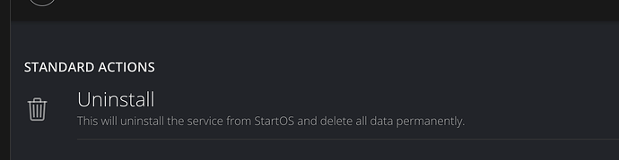

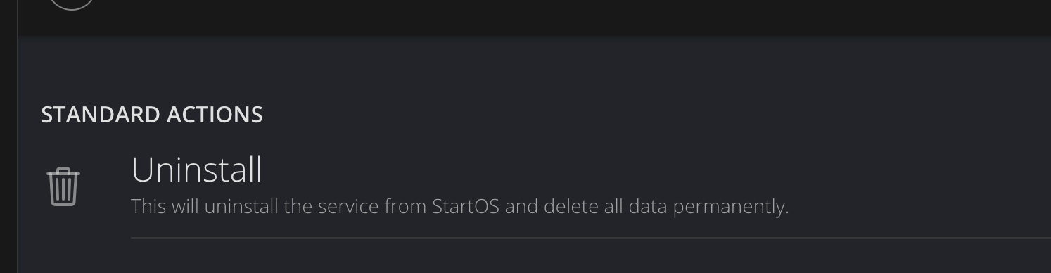

Wish I had never moved over to Knots. I have posted this in my own post but maybe some here can lend some advice? All services just looping.
Just left Knots and reinstalled Bitcoin Core and got below.
You sent me an email but the adress was a no reply so I will send it here.
Thanks for your response I have been up and running since August of 2024. Made a switch to Knots which evidently needs an update as I see others are having issues.
Check no Bitcoin is installed? I use my Server Pure to connect via Tor to Sparrow Wallet. I guess some people store their coins on their servers? Or do you want me to install Bitcoin Core again?
Questions- I guess I need to create a back up of Bitcoin Core before I delete the app?
Will I get a new Address to access my Start 9 server and with that a new Tor Address that I will need to point my Sparrow wallet?
Will I need to export my wallet file over from my cold card again?
Will I be able to use my old wallet files?
Also I have a Bitcoin Core app on my laptop because I had downloaded it to a hard drive to take with me when I travel to China, but it kept getting corrupted so I stopped using. But was just using as a Bitcoin Core not a private electrum server.
