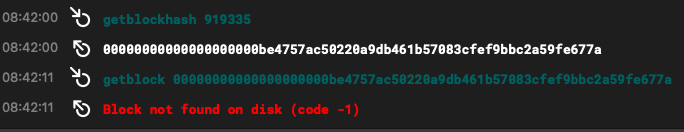

So, like I said before I copied the blockchain (and chainstate) from another host at height 925.225.
Checking the original host on the console this is what I get:
So for some reason the block (919.335) that s9 instance says can’t read from the disk, also can’t be read from the original bitcoin.d host. But apparently this host works without problems. In the original host if I try to consult a different block it works:

So I think the problem occurred at the original host, not because of the SSD or VM, since I can “kind of reproduce” the issue. But for some reason the original host does not keep restarting.
Checking the possible commands in the console I tried to get the block again from peers and here is what I got:
So the solution was to reindex the whole thing. Took a while and not sure if was faster than downloading again.
