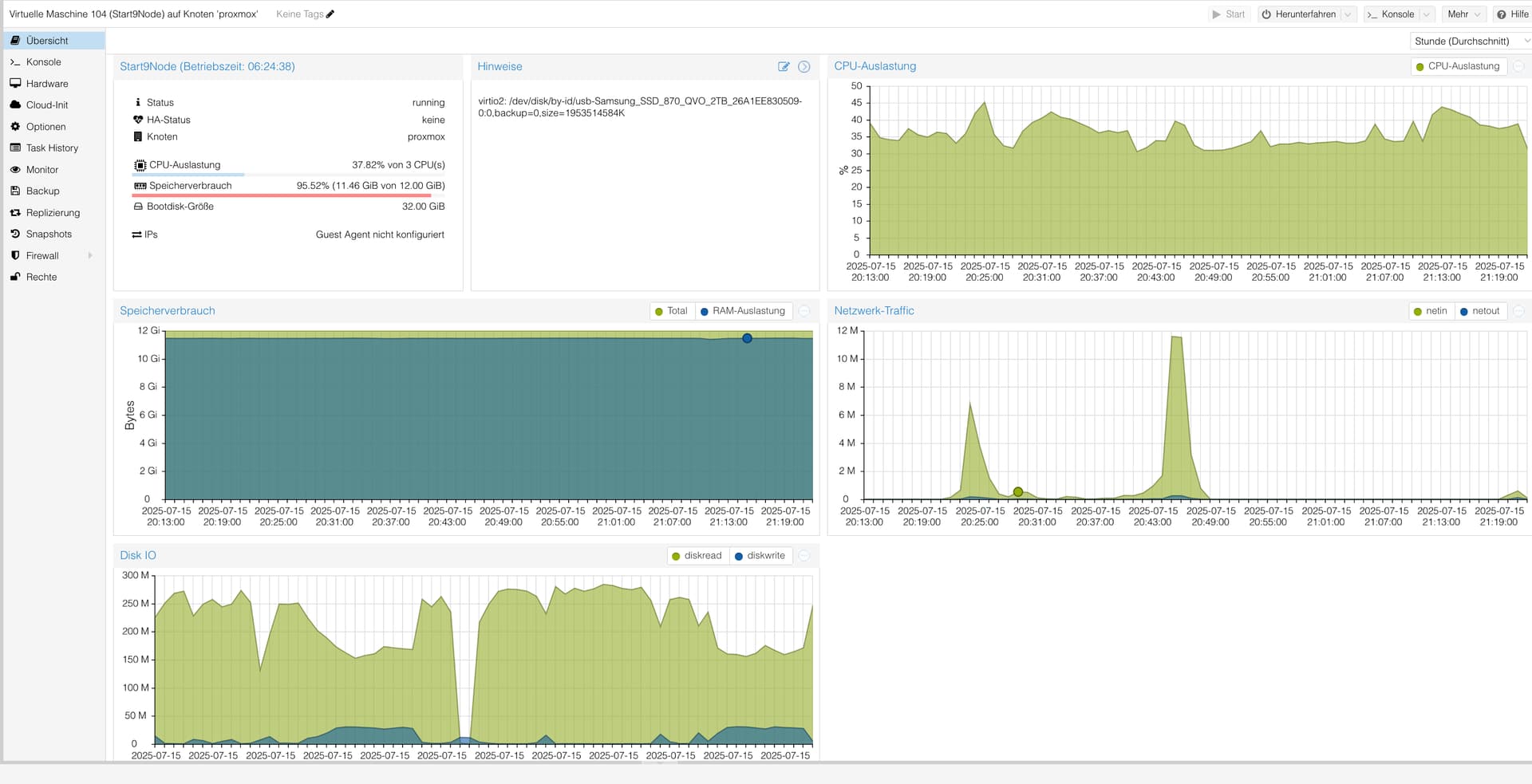

Blockchain has been syncing for 14 days
I bought an Intel NUC.
I’m running Start9 in a VM on Proxmox.
The blockchain has been syncing for 14 days now and is only at 45%.
I don’t understand why.
My internet speed here is normally 240 Mbp/s.
According to the NUC’s speed test, I’m at 80 Mbp/ss. I don’t know why.
But that should be sufficient speed.
Why isn’t the syncing finished yet?
Where could there be problems?
Does anyone have any ideas or can help?

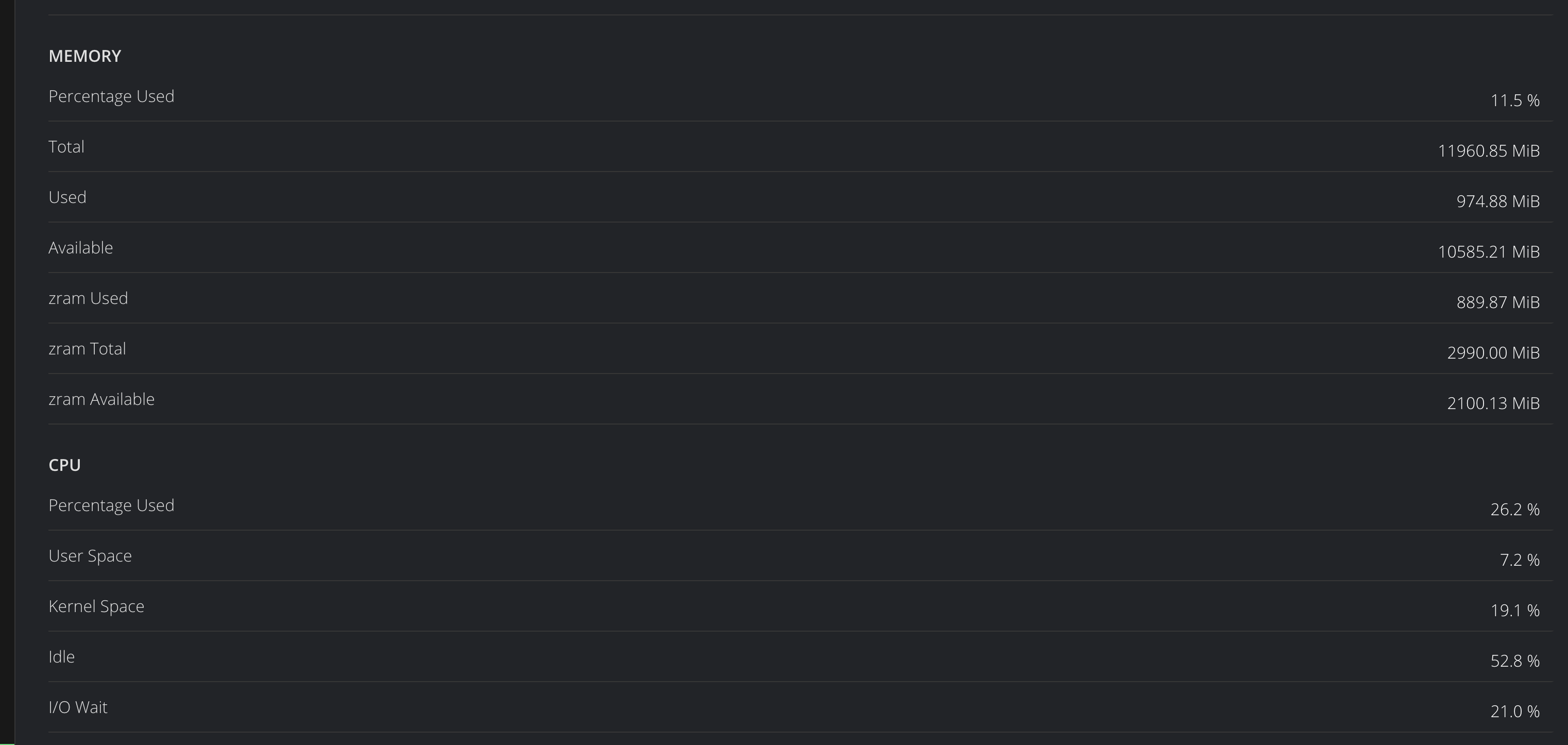

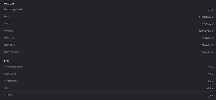

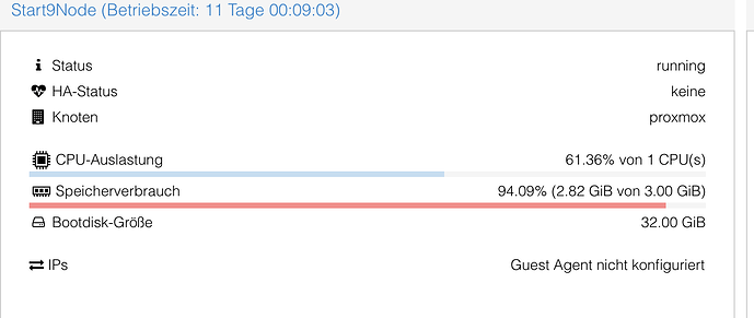

thank you for your answer.
this is the nuc:
Intel Core i5-7260u
16GB RAM
256GB SSD

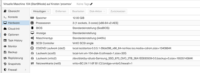

Previously, proxmox ran all VMs on an old laptop. This one had worse performance.

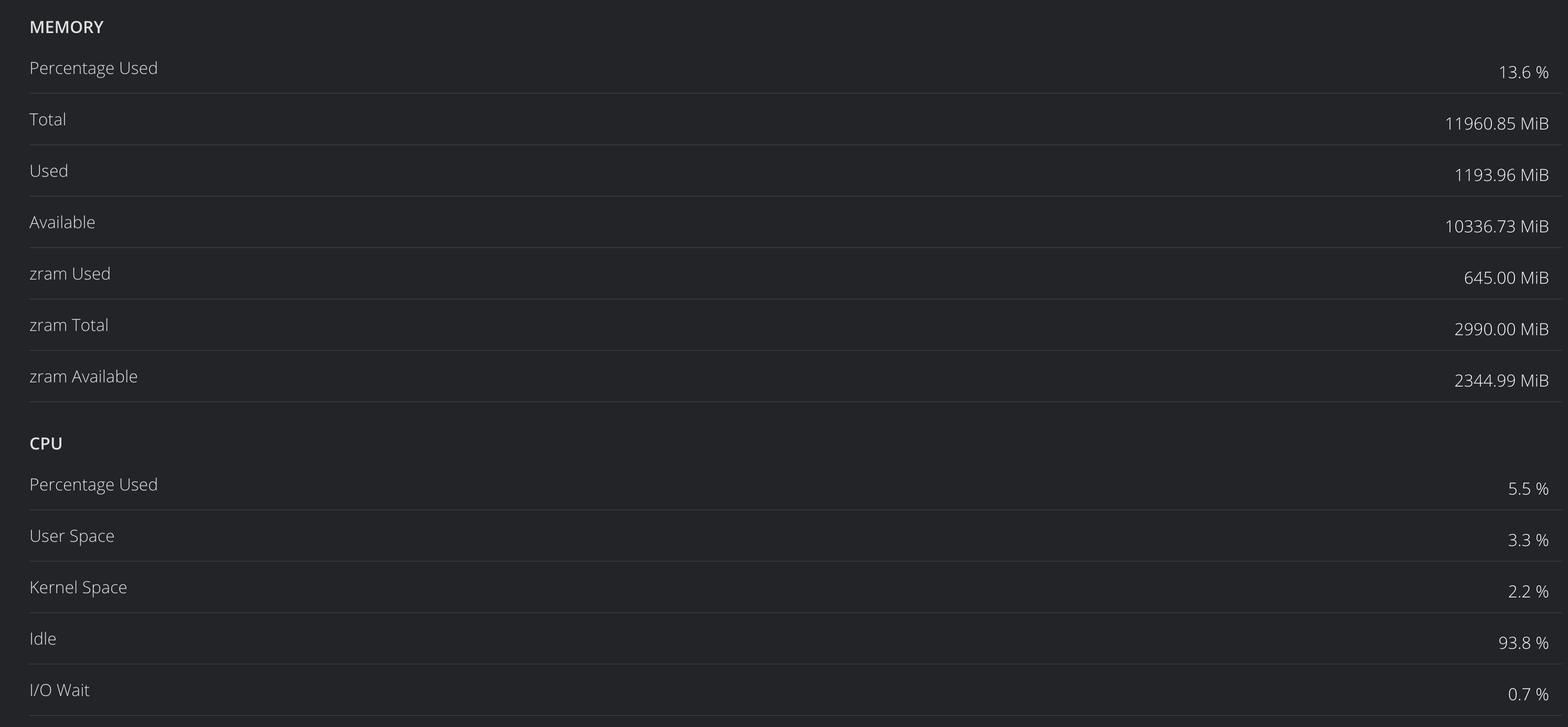

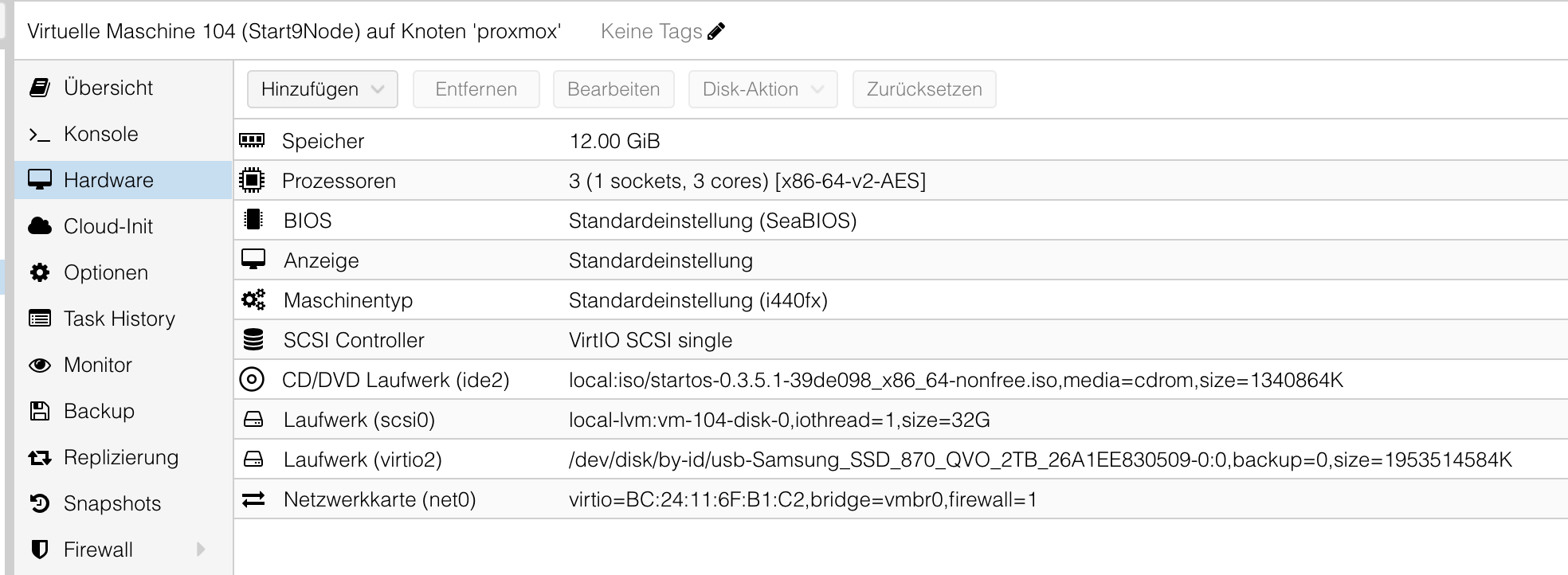

Here are the values I assigned to Start9.
I’ve looked at all the logs in start9, but I don’t have the knowledge to recognize anything here.
you?

You’re trying to run Bitcoin on 3GB of RAM???
OK, I changed the RAM size two days ago.
For about 24 hours, it was progressing much faster. Now I’m only at 84% :frowning:
Why is it syncing so slowly?
You’re in the hard part now. In the last 15% the UTXO set has exploded, the blocks are full, and the transactions are much more complex on average. It’s normal for it slow down towards the end. It’s not about network speed.
Ah, okay, I understand.
So could I reduce the allocated RAM again now?
You have also given it only 3 CPU cores, this is really limiting.
I’d suggest giving it at least 16GB of RAM and 8 CPU cores, preferably more.
After the initial sync, you would still need at least 8+ or preferably 16 Gb of RAM to process new blocks and transactions.
