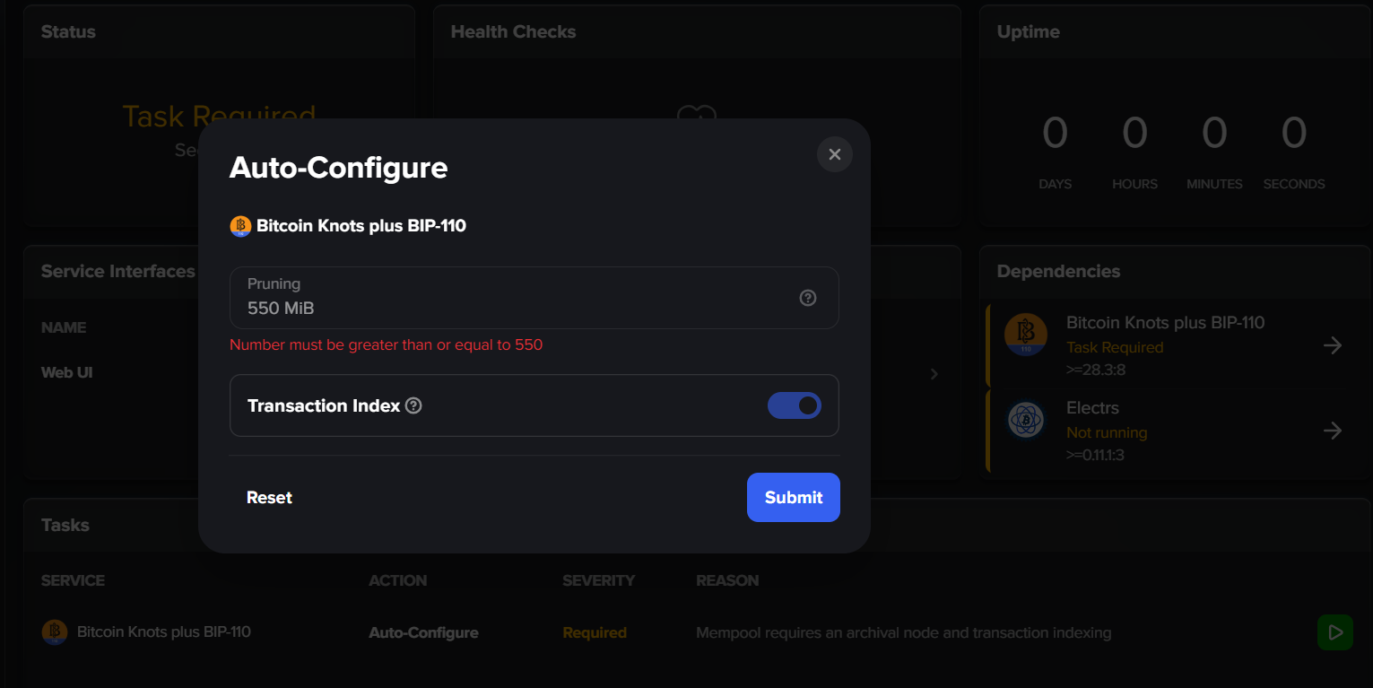

I have Bitcoin Knots plus BIP-110 running as a fully synced archival node (full IBD complete, ~1072 GB used). Electrs is installed as a dependency. This hasn’t been an issue until the last two weeks. It was working fine for well over a month until now. Subsequently, this affects my mempool service as well, which has the EXACT same issue. Even if mempool didn’t have the same issue, it still relies on electrs as a dependency so I imagine it would still not run properly.

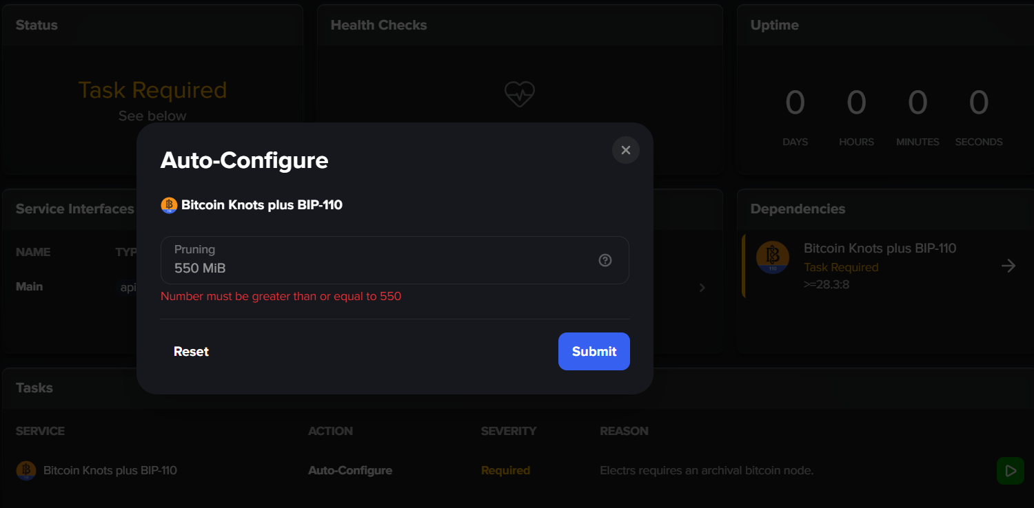

The dashboard shows a Required task: Auto-Configure on Bitcoin Knots, with reason “Electrs requires an archival bitcoin node.” When I open the dialog, it shows a Pruning field pre-filled with 550 MiB and an error: “Number must be greater than or equal to 550” — even though the field already shows 550.
I checked the actual bitcoin.conf at /media/startos/data/package-data/volumes/bitcoind/data/main/bitcoin.conf and there is no prune= line anywhere in it, confirming the node is correctly running in archival mode. The config also has txindex=1 set.
So the node is already in the correct state for Electrs, but the auto-configure task is stuck and won’t clear. It appears the auto-configure logic doesn’t handle the “no prune line present” case correctly and gets caught in a validation loop.
Steps to reproduce:
  1. Run Bitcoin Knots BIP-110 as a full archival node (no prune= in config)
  2. Install Electrs as a dependency
  3. Auto-Configure task fires as Required — opening it shows the pruning validation error despite the field value already meeting the stated minimum
Expected behavior: Auto-configure should detect that pruning is already disabled (archival mode) and either clear the task or complete without error.
Actual behavior: Stuck in a validation loop. Task cannot be completed or dismissed.
