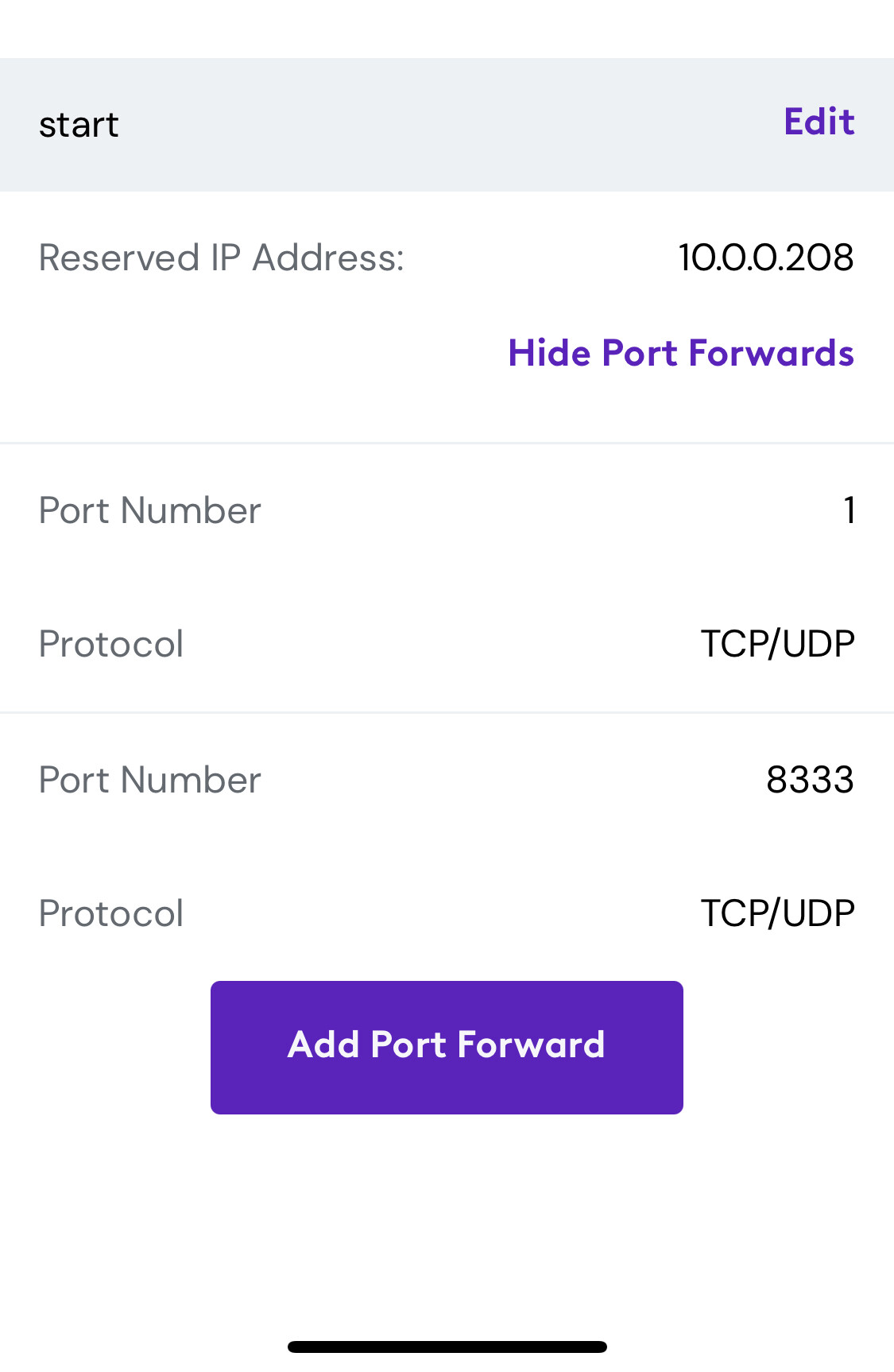

I see that you have an IP address reserved for your server, so it shouldn’t change. But being unfamiliar with your router, I don’t know if we are looking at an active device, or just a reservation for a device. Do you see any indication in the router that the device is actually active?

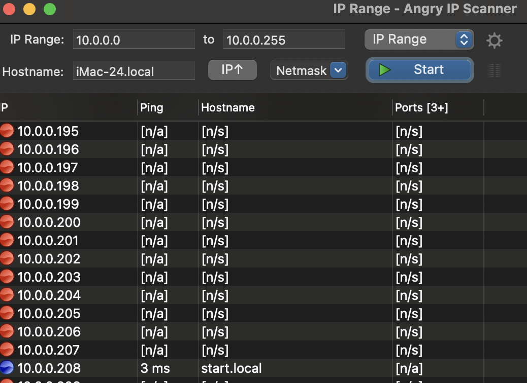

Angry IP scanner recognizes Embassey at:
https://10.0.0.208/
The router still doesn’t show a connection.

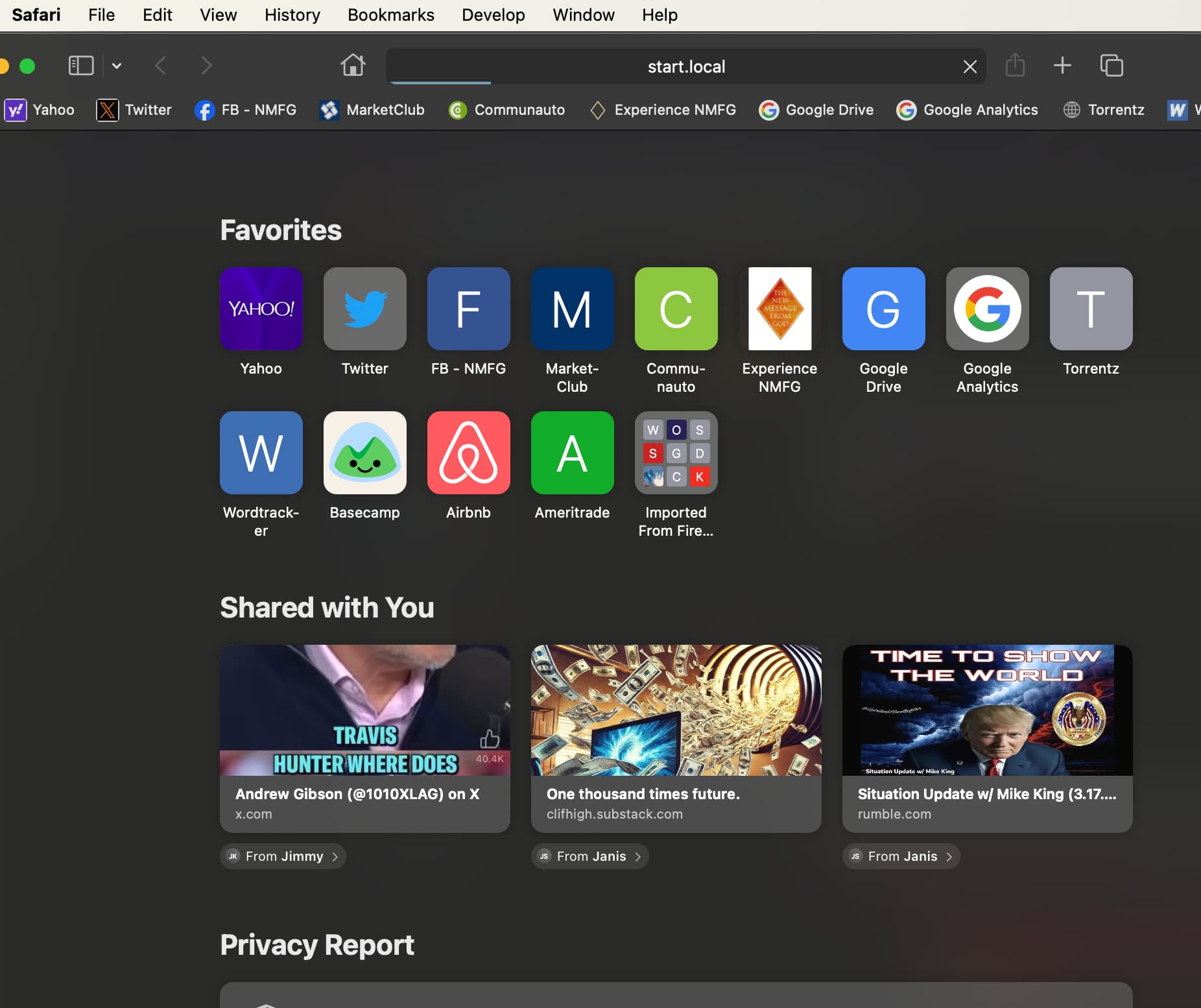

It looks like your server may be in diagnostics mode. I’d like to know if the Mac you mention above was the same machine that you just ran the Angry IP scan with. If so, try using Safari, and type start.local in the address bar. If that doesn’t work, I’d like to know the error message. You might also try specifically http://start.local, or http://10.0.0.208. Again, I’d like to know the exact error messages.
Yes, the Mac I mention above is ghe same one that ran Angry IP. when I try to access http://start.local/ from Safari, it just hangs. No error message:

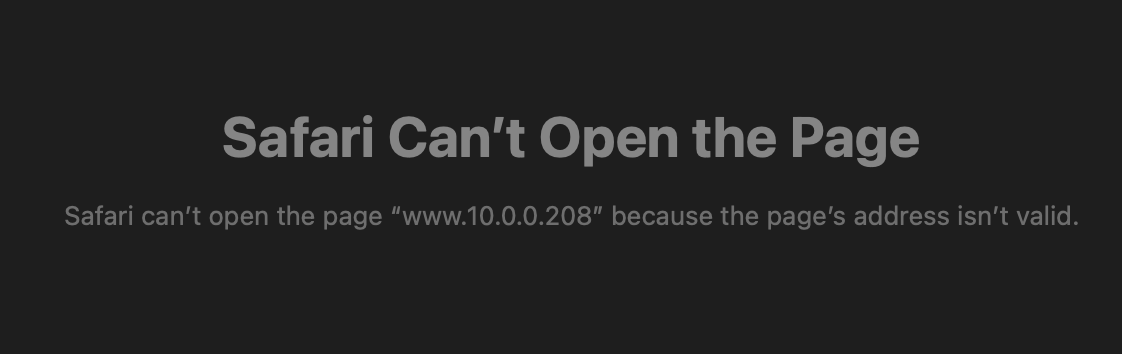

This is the message I egt from Safari when I go to: 10.0.0.208/
I’m not clear on why it’s adding the www.

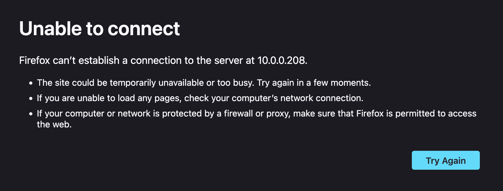

Try specifically http://10.0.0.208
Try the same in Firefox.
Since we can’t get it to respond at all, I do think at this point you’re going to need to re-flash your server. Your SD card may be failing, so I’d recommend re-flashing to a new SD card. If your server is an SD card only model, you can attempt to transfer the service containers during the setup process, using an SD to USB adapter. If your server has an sd+ssd drive setup, you’ll simply choose “Use Existing Drive” during the setup to restore your server back to as it was.
