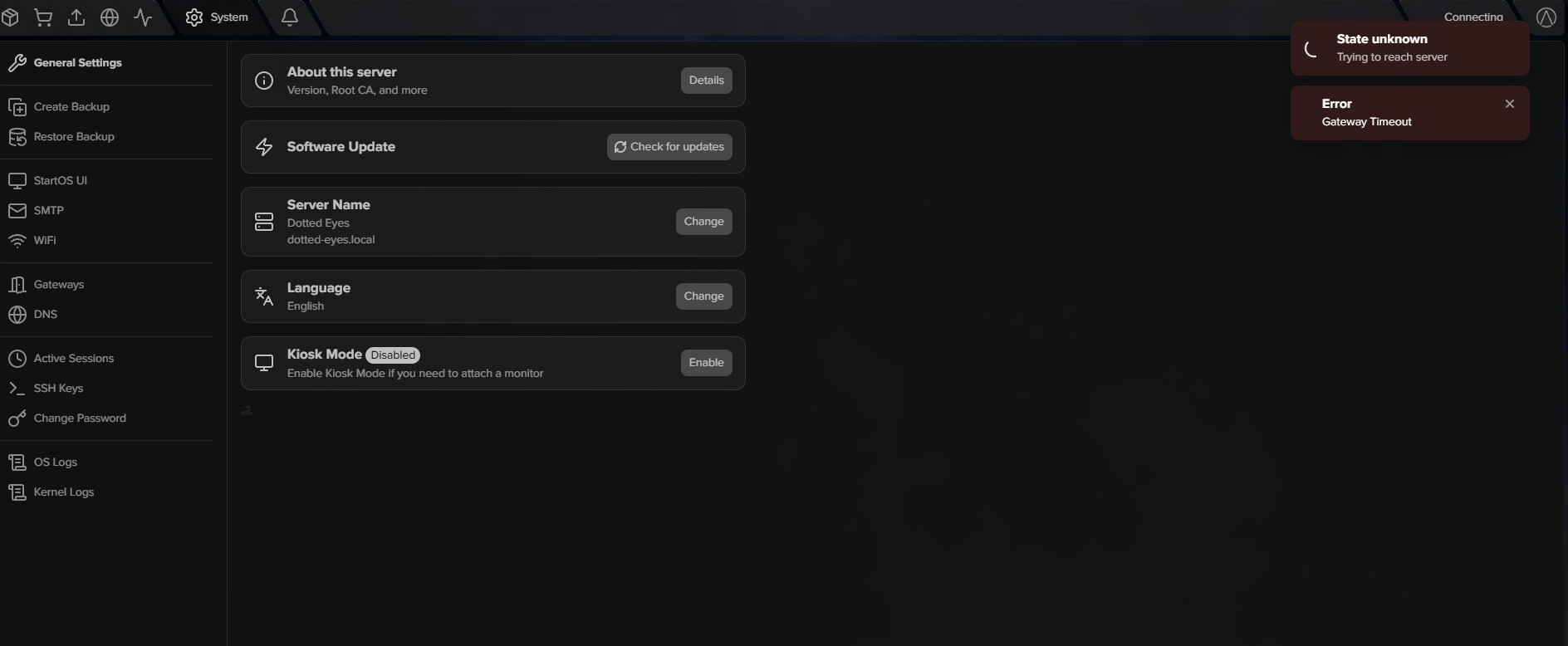

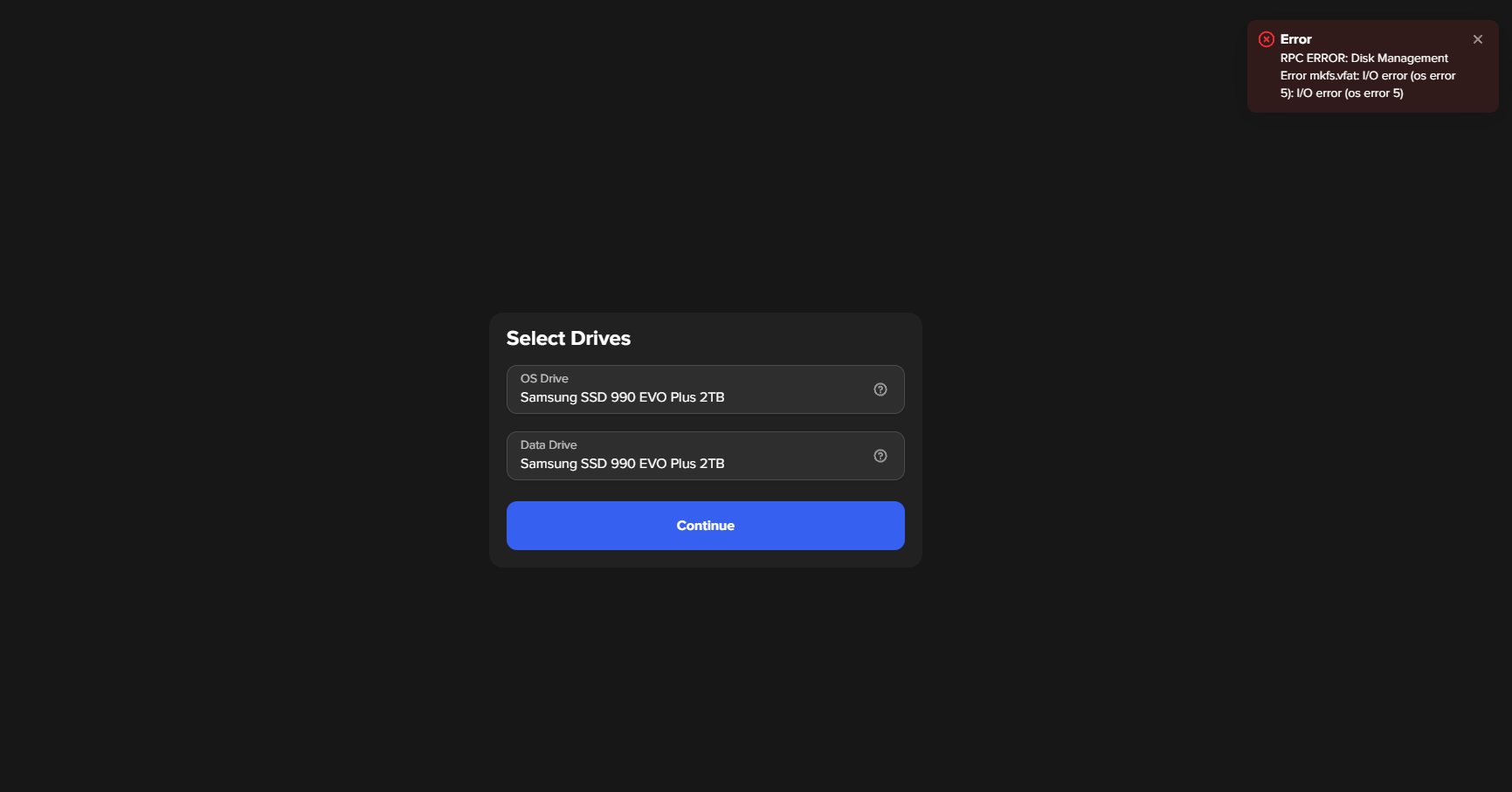

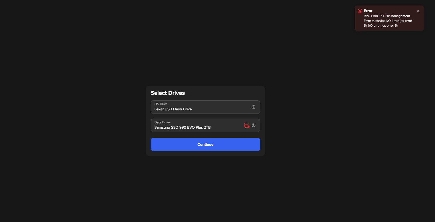

The 0.3 to 0.4 update issue I called it a bug but technically idk what to call it. Im in the process of trying to flash the new OS but i get this alert when I select the OS drive(usb) and data drive (samsung ssd. In the Start 9 server)

You can’t install the StartOS onto a USB drive you are already using to install the OS. Or on any USB drive for that matter.
Install the OS and keep the Data both on your internal drive, the Samsung.
the instructions call for the OS to be flashed onto a USB drive using belena etcher then to reboot the server from the USB in the upper field and the server in the lower field.

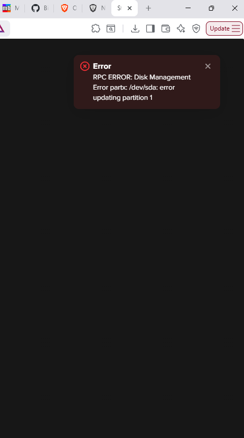

just trying to give more context idk if this helps

I was having issues with my electrum server and figured out the OTA update didnt go over well. So thats when I started to follow guide to flash OS onto the server pure. Once I unplugged the server and booted it back up with USB in it I got to where the screenshots are at.
its an old cheap USB drive so maybe thats the issue?

I do not think the USB drive is the issue. From the screenshot you posted, it looks like you successfully completed the upgrade from 0.3.5.1. The error message in you last screenshot simply indicates that the browser has lost connection to the server. I’m not sure if you are still at this exact place, but if so, a hard refresh of the browse is the next course of action. ctrl+shift+r on Windows or Linux, cmd+shift+r on mac. It’s also possible that your server is not present on the same network as the client machine. Check the connections, and make sure your client machine is not on some sort of guest wifi.
