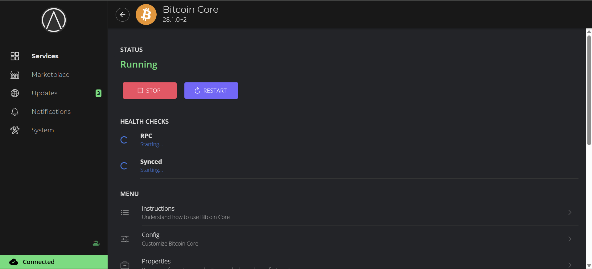

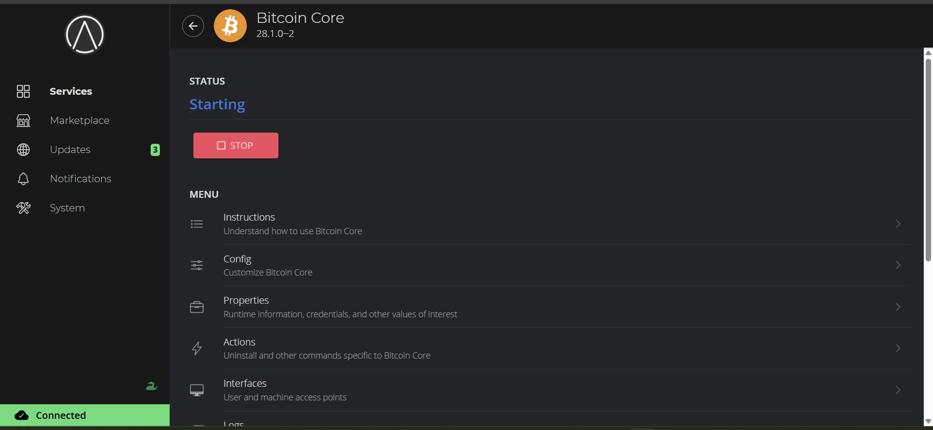

I had installed this server back in August and it worked well. It took a few weeks to sync. Then it was good. I also had the issues of traveling often. And I wanted to have access to my Bitcoin Node and Electrum server when traveling. I used TOR and it worked well for a while. Then it went down. And I had to have someone go to the server to reboot it since I was far away. However this only worked one time. And the next time it would not reboot. We discussed the problem on here. And it was decided that when I returned home. I would reboot and we would discuss how to fix it so it would be more stable and not have to reboot all the time. And when rebooting it would actually come back up. I have returned home. And tried to reboot, while I had a local connection. It did reboot, and started syncing again. It was at about 98%. This went on for a while but then it stopped. And I could not log in locally. It had the error “RPC Error, Database error. Pool timed out while waiting for an open connection”. I rebooted again and I got it to say starting. But it does not start. It keeps cyclling between starting and syncing on Bitcoin core screen. I will attach screen shots. Am I on the right track? Should I just leave it and let it cycle through? Or should I force another cold boot? Your help is greatly appreciated.
It looks like your Bitcoin Core Service is stuck in “Starting” state.
The first thing you should do is take a look at the service logs you can find on that very page, tight below “Interfaces”.
That will provide further details as to what is causing this.

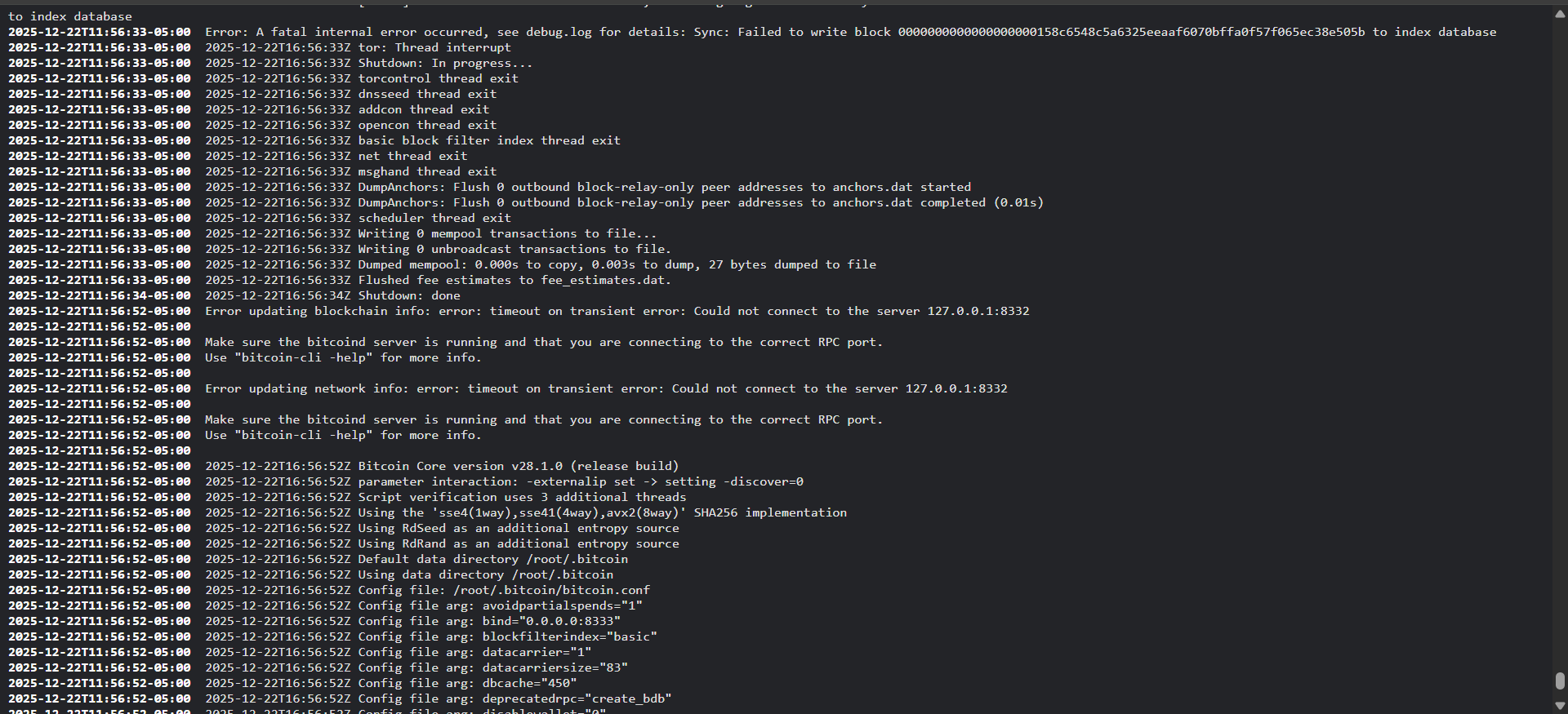

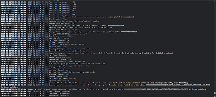

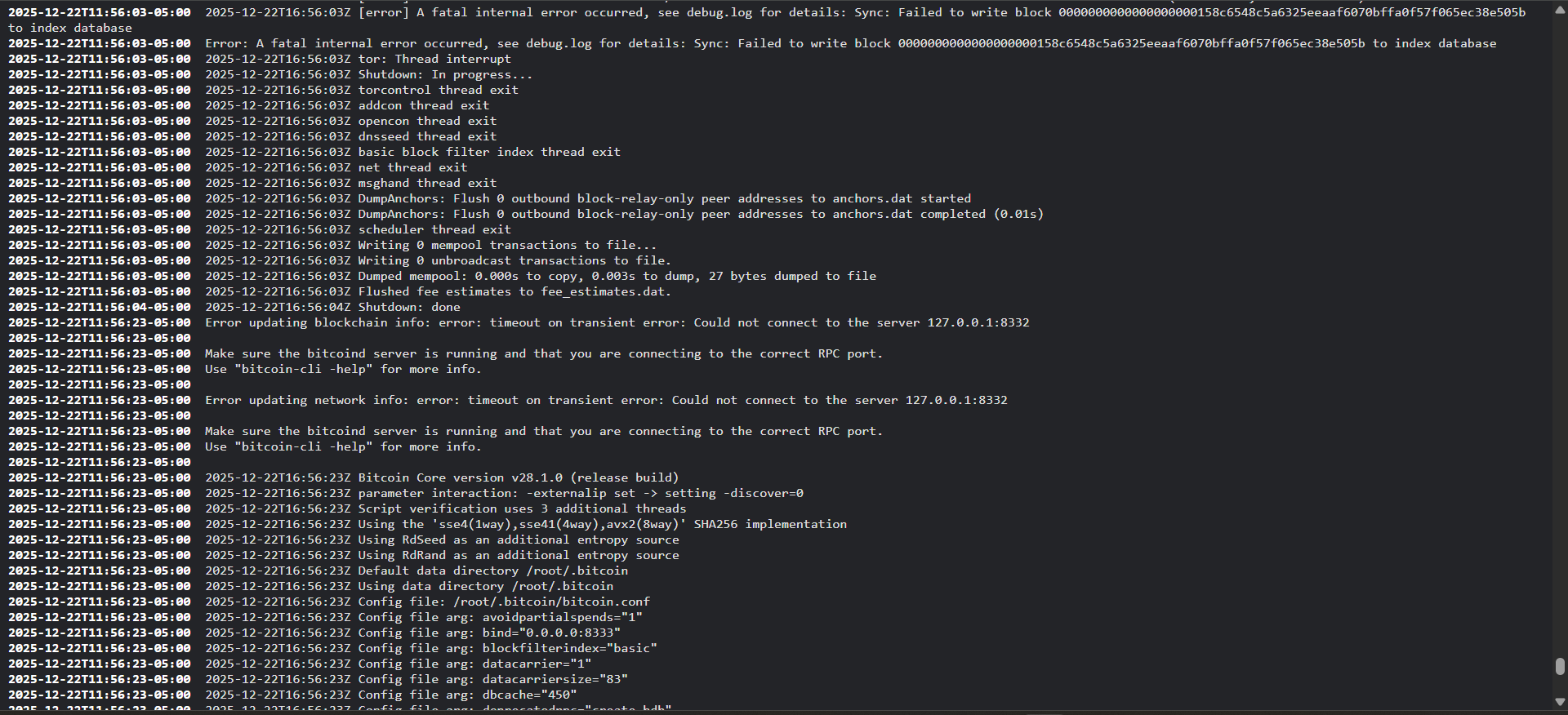

This is what I found so far. There are a lot of logs scrolling by. I did notice one error that caught my eye “A fatal internal error occurred. See debug.log for details: Sync: Failed to write block”
There are many other errors. But its hard to read them. Stuff is scrolling rapidly.
Another error is :Error updating blockinfo: error: timeout on transient error: could not connect to server 127.0.0.1:8332"
“make sure your Bitcoinnd is connecting to the correct server, and that you are using the correct RPC port”
There is a lot of other stuff. But I really don’t understand what I am reading. Or what I should be looking for.
Any thoughts?

I downloaded the logs. And I did a search on the word error. And this set of logs was repeated many times. It appears near the top of this set of log statements there is a reference to a fatal error. Not sure if this is the actual cause. What do you think?

UPdate: OK I did the system rebuild. ANd it completed. However it has not changed much. I also stopped the electrum server and mempool service. Just to let BItcoin Core try to come up by itself. But it made no change. It just keeps trying to cycle through the health checks.
Any ideas on what I should try?

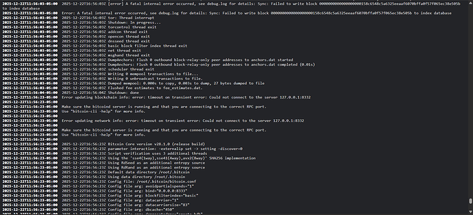

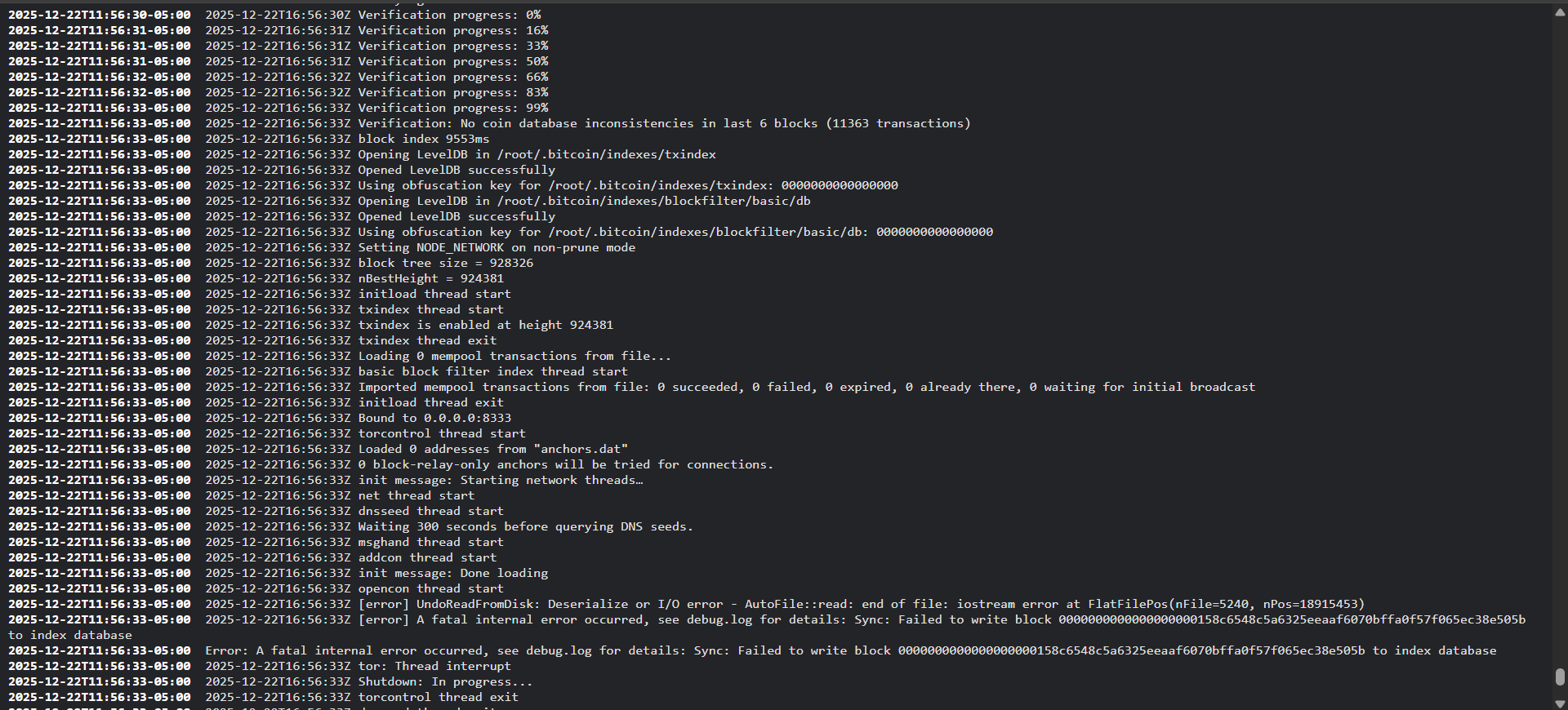

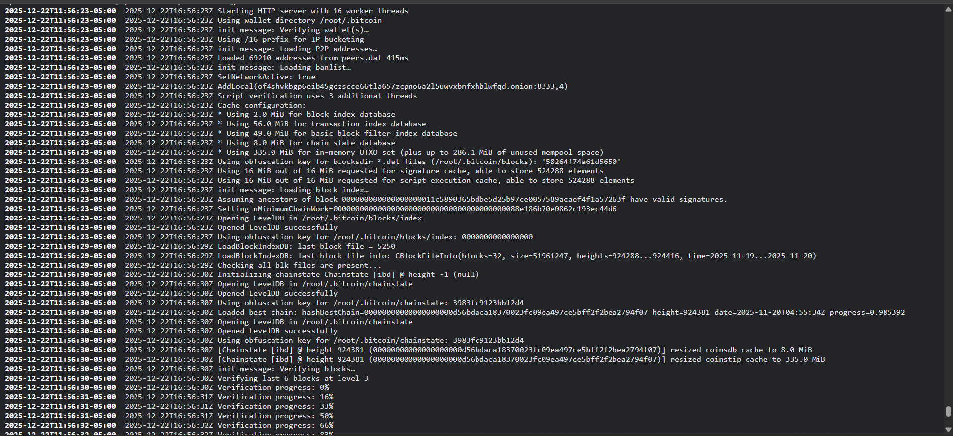

Ok. I tried to do a cold boot to see the errors on the command window at startup on the server monitor. Trying to take some pictures. But it didn’t show anything monitor went blank and then login screen appeared. And it did boot successfully to the point of starting Bitcoin core. At this point it started repeating the problems from before the upgrade. It goes through the RPC health checks. So I got logs downloaded from service logs. I attached them below. As you can see the fatal error occurs. Then it goes through the starting process again and again.
Please let me know if this helps? And any suggestions on logs or other troubleshooting steps?
