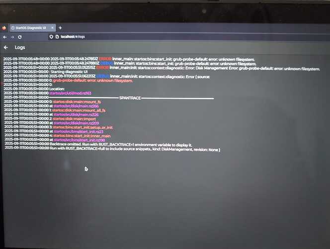

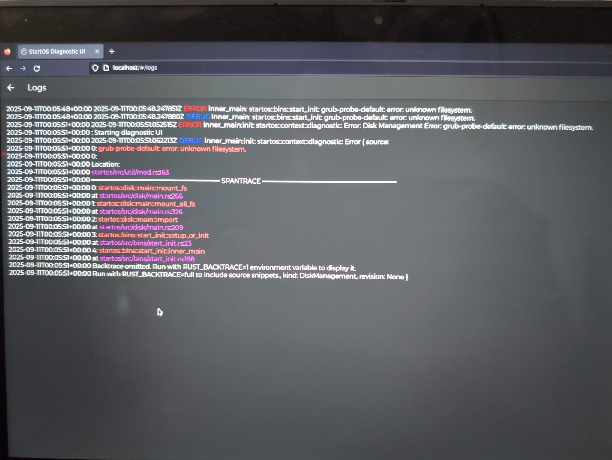

One day, after coming home the server had stopped working and I got following Errors in my log:
StartOS Launch error:
Disk management error.
grub-probe-default: error: unknown filesystem.
I tried all the suggested options after restart: restart sevrer, system rebuild and repair drive with no success.

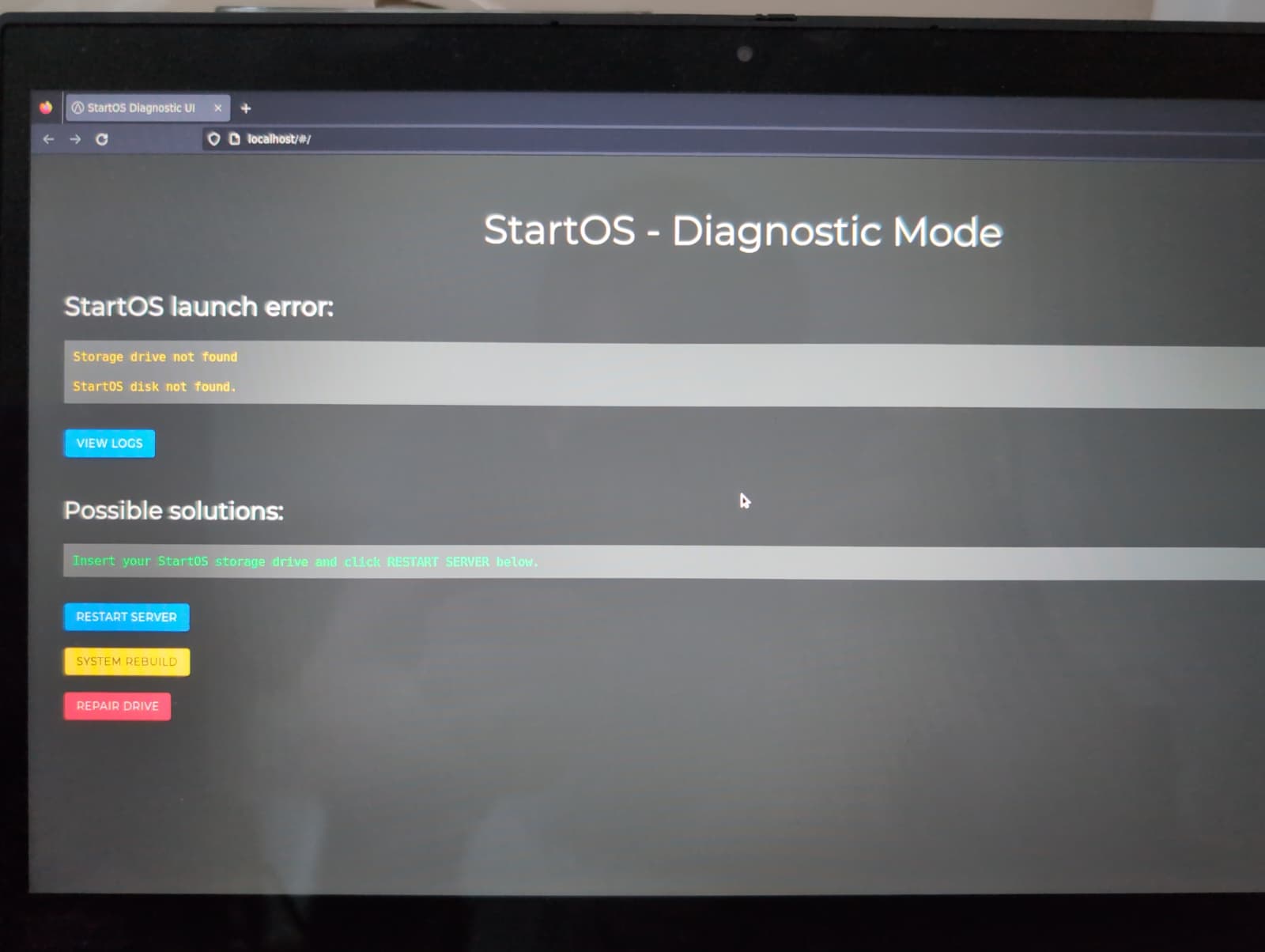

After removing external drive and booting up the machine it gives me additional StartOS disk not found error as well. Does it mean I flashed it on my external SSD partition? I wiped the original machine clean from any OS and data before installing StartOS. I thought installed the OS on the machine’s internal drive. The startOS logo and stuff pop up when I boot up the machine. This is what I get when booted up with no SSD:

  • When I found my machine in the bad state I had Disk management error. displayed in the StartOS - Diagnostic Mode. My external SSD was still attached to the machine.
  • When I removed the external SSD and tried to boot into StartOS the StartOS Diagnostic Mode displayed 2 StartOS launch errors: Storage drive not found;, StartOS disk not found

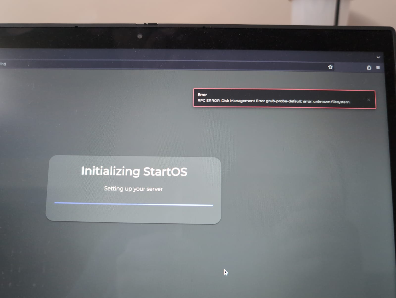

  1. Installed StatrtOS on the server internal drive
  2. Booted the server → attached external data drive → Selected “Recover” → “Use excisting Drive” → and during the initializing I got the same RPC ERROR: Disk Management Error grub-probe-default: error: unknown filesystem
The initializing screen is stuck: Setting up your server. Where should I go from here?
This looks to me like the data partition, if not recognized as ext4, is likely in a bad way. I’m not sure of there’s a next step, at least within the StartOS context. Outside of StartOS, you’d need to look at possible specialist recovery techniques I’m afraid.
