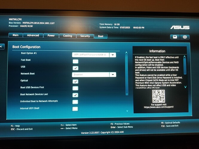

I did some playing around with this, i tried to look for settings on the Asus bios that may disable peripherals and then enabled/disabled some settings.

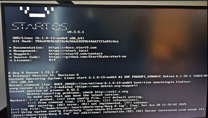

I can’t seem to access Start.local on another PC during all the tests and all attempts that i could at least view the screen ended with terminated error 1 message after start 9os loads, takes about 10 seconds of checks and then fails.

What i have noticed if this is supposed to be or not but the Nuc doesn’t show up as a wired client in my router settings, if this is because there are no drivers loaded yet.
I no others have stated using a USB to ethernet and plugging Ethernet into usb but i am unsure on this
I posted some images from the bios boot menu.
Let me know if i need to clarify, any help is appreciated otherwise i will
keep experimenting,
I’d add more images but i can only add one
Thanks

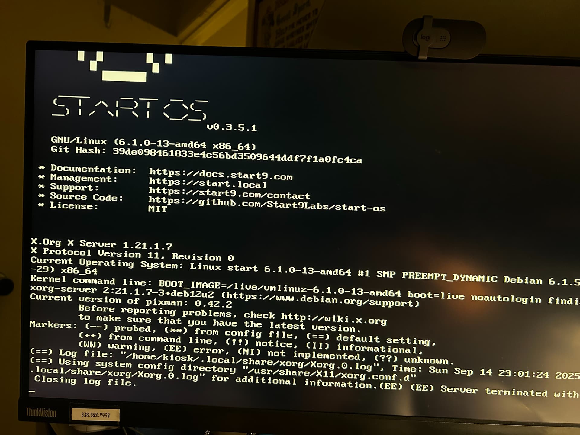

It just gives same kind of error message every time when I try to install StartOS from USB stick on Umbrel Home as in this picture:
That’s fine, and addressed multiple times in this thread.

Hi everyone, I’m new here and I’m having trouble installing Start9 on my new hardware setup. I am receiving the error 1 message during the installation process, and I am unable to access http://start.local. My Hardware Configuration: Mini PC Intel NUC 14 Essential N250, Kingston 16GB DDR5, Western Digital Blue SN5000 2TB.
Initially, my router couldn’t even see the NUC N250. Following the method described by luke69, i used the TP-Link UE306 USB-to-Ethernet adapter. The NUC is now recognized by the router and has been assigned an IP address, confirming network connectivity through the adapter. I used the non-free.iso installation file, secure boot is disabled and I tried booting both with and without the HDMI display and keyboard connected. Despite achieving an ip address with the adapter, i still get error 1 message and cannot load start.local or connect using the specific ip address. I think that the NUC N250 model might not be supported.
The error message in your photo is very specific to having a monitor attached, so isn’t super helpful as in your case you’ll definitely need to not have a monitor attached.
Now, if there’s a different error on bootstrapping StartOS without the monitor attached, we’ll never know what it is without the monitor.
