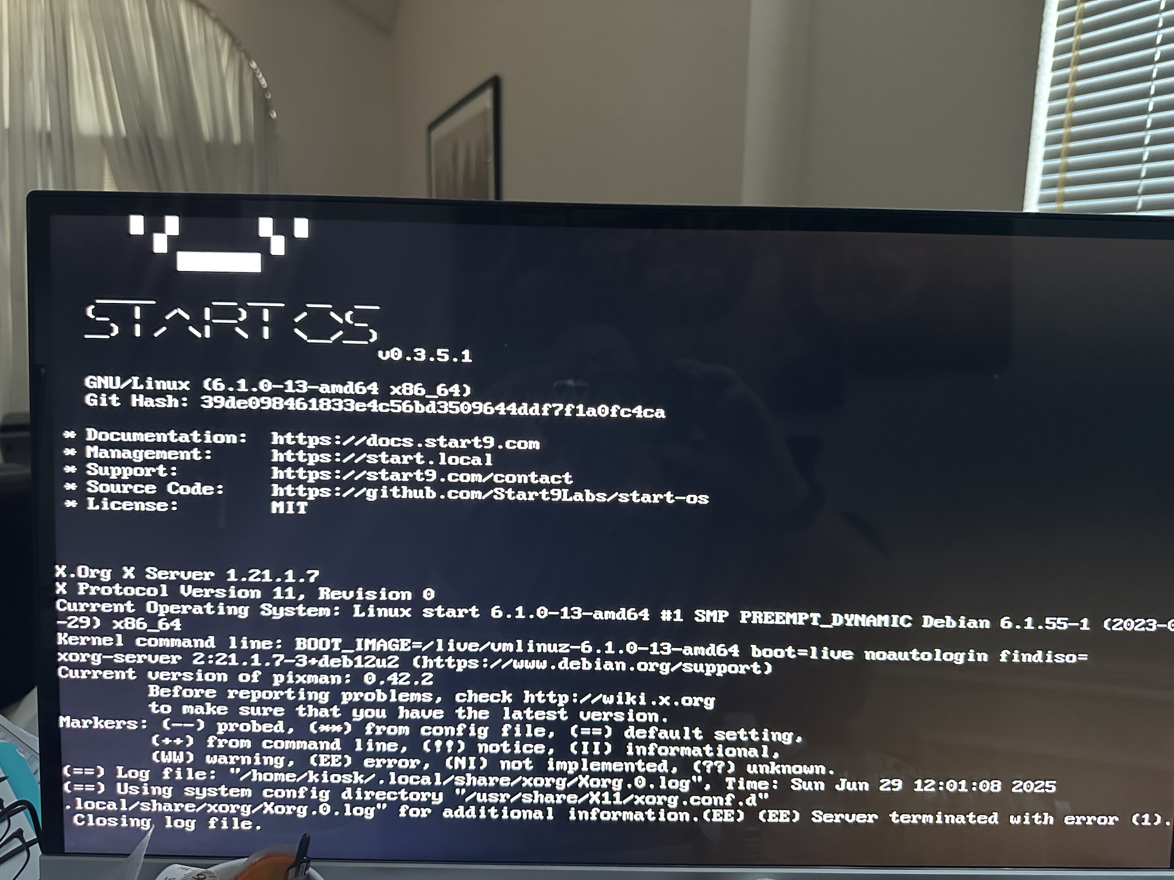

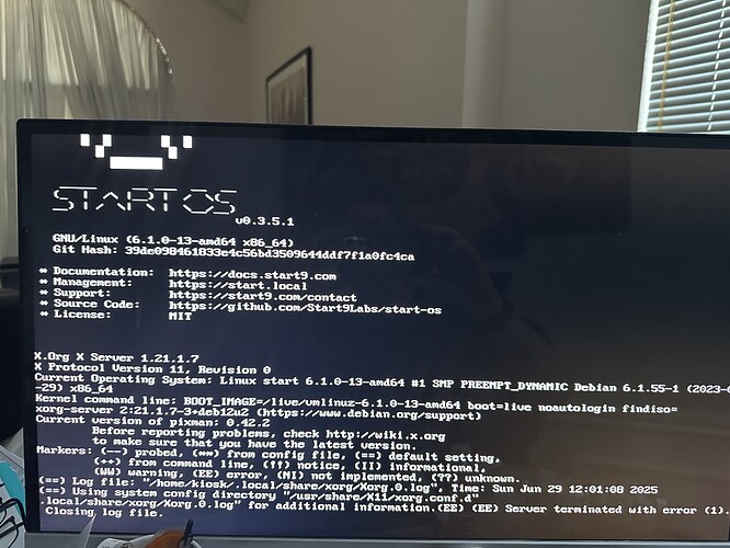

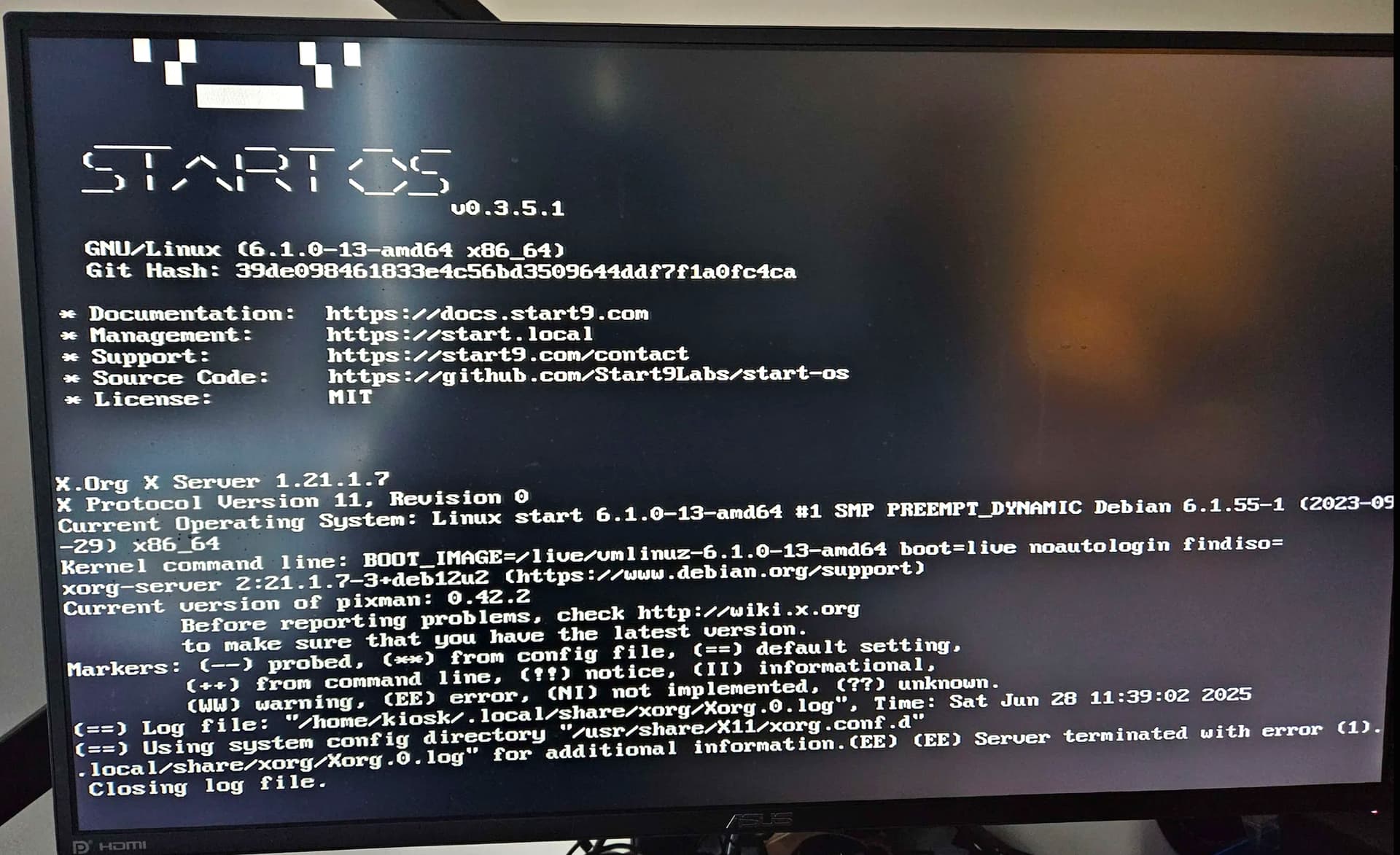

not sure if i should make a new post but have the same issue here. Im not able to buy the start9 product so went with a NUC in my local area. NUC14RVH with SAMSUNG 990Pro NVME. here is the error. i reah the install step in the guide. from my reading it could be due to the intel ARC new CPU iGPUs thats causing this issue.
How do we fix this?
Make sure to use the “-nonfree.iso”, which includes more drivers (also for intel boards, which should work on an Intel/Asus NUC).
I tried that…no go…also tried disconnecting monitor and peripherals…no go
Same problem here with the non-free iso. Would be interested to know if there’s something else we can try. I also purchased a USB to Ethernet adapter with no change.

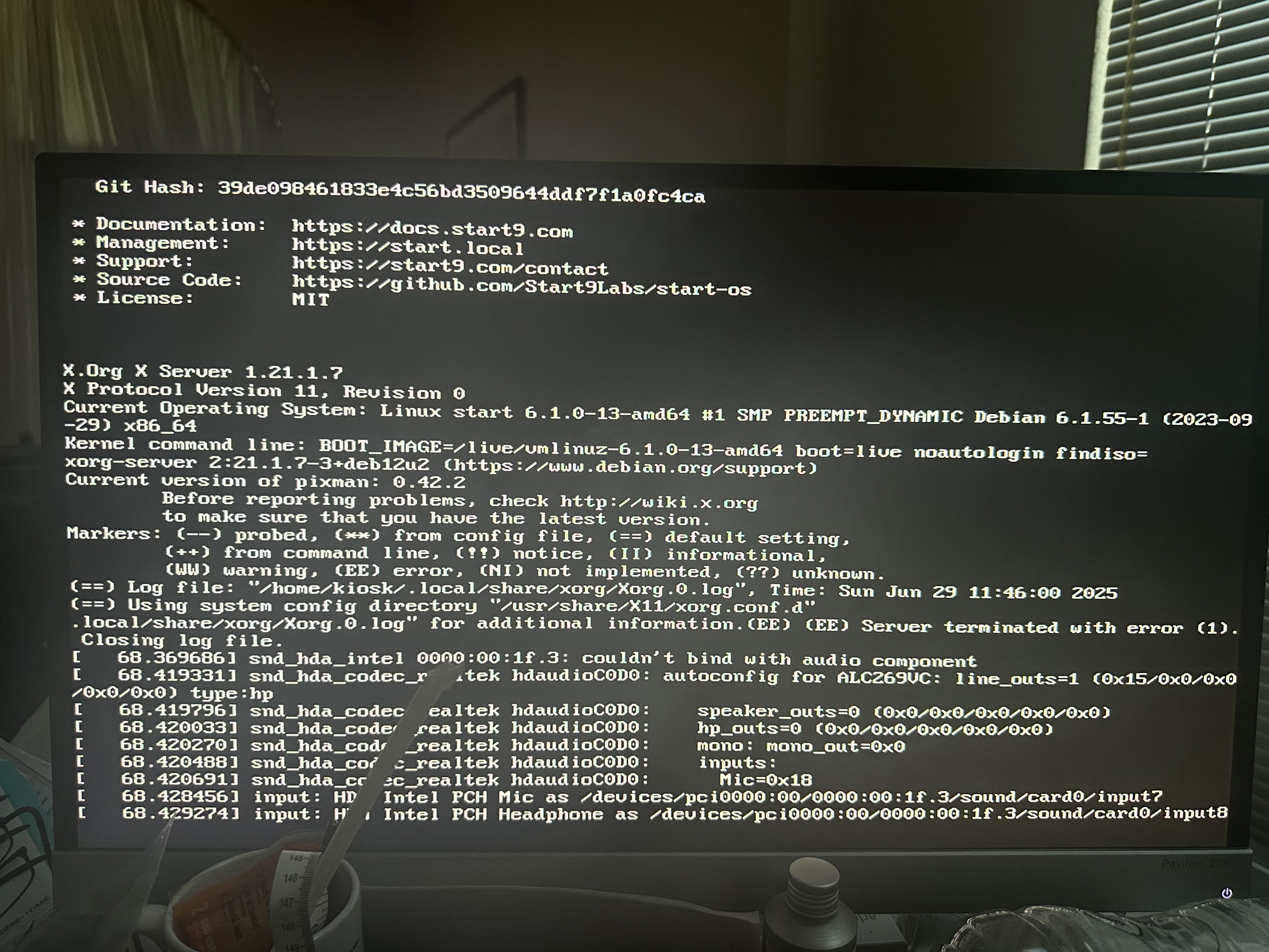

It refreshes that screen every 15 sec 4-5 times, then I see this screen once about an audio component:
then it goes back to refreshing the previous screen over and over about every 15 seconds.
Just disconnect the monitor and boot…no peripherals…then go to stat9.local to finish the install
Thanks for the response! So, you got yours to work? Did you also disconnect keyboard and Ethernet? How long did you wait to connect your monitor again? Are you suggesting start9.local from a different machine, or same machine after boot and reconnecting the monitor?
It’s start.local. Not start9.local.
Just the monitor mouse and keyboard. If you disconnect the Ethernet, you will not be able reach your server from the other machine. Though keep in mind that most desktop PCs will stop an a keyboard error if you turn on without a keyboard. There’s usually an option in the bios that can disable this, or you can just leave a keyboard connected.
In some cases the problem is a missing display driver. By booting the system with no monitor, it boots into headless mode. Since the display is not used, no display driver is needed.
