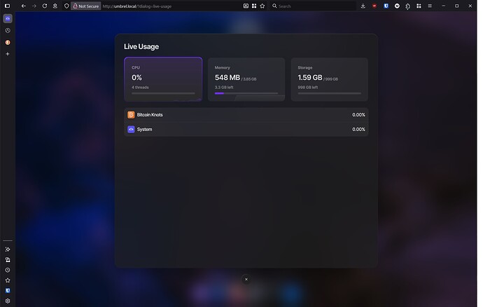

As I have mini-PC Elite LIVA Z2V ECS N4100, 4 GB, eMMC 64 GB, , 8TB Internal SSD (Samsung 870 QVO SATA III 2.5-Inch), linked to a router by the cable LAN, all available for experiments I installed and tried Umbrel 1.4.2 to run BTC Knots.
It synced 100% within 5 days with visible progress with CPU 4 threads load variations between 7%-75% and RAM use up to 3 GB from 3,8 available. However after Knots version updated the web UI was lost and the UMBREL 1.2 system became dead …

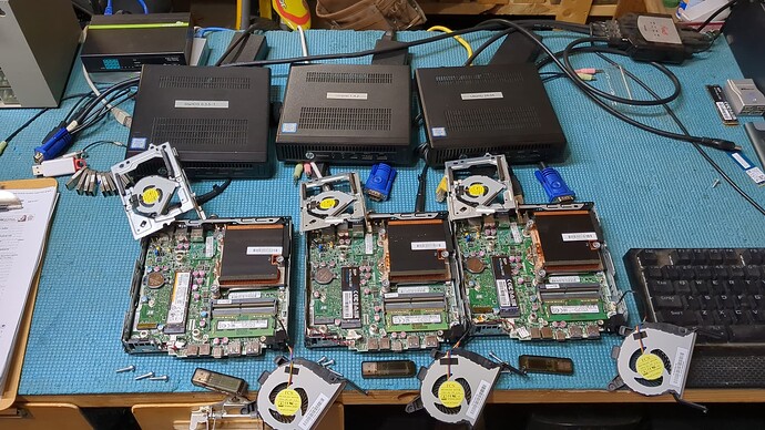

I am interested to know the difference, and still plan to test this. But I’ve had limited time. Here is where I am so far:

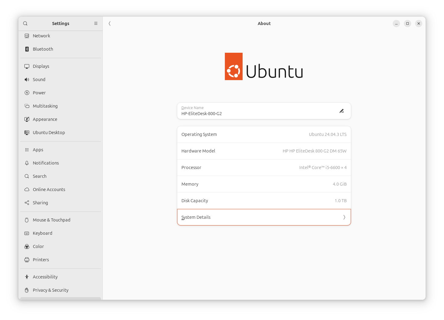

Three machines, as identical as I can, with available hardware. These are the HP Elitedesk 800 G2 Mini PC
They have an Intel Core i5-6000
4GB PC4 RAM
1TB NVMe SSD
My plan is to run Bitcoin Knots 28.1.0 on each
Ubuntu 24.04
Umbrel 1.4.2
StartOS 0.3.5~1
I’ll be doing the IBD with default settings, – Clearnet enabled.

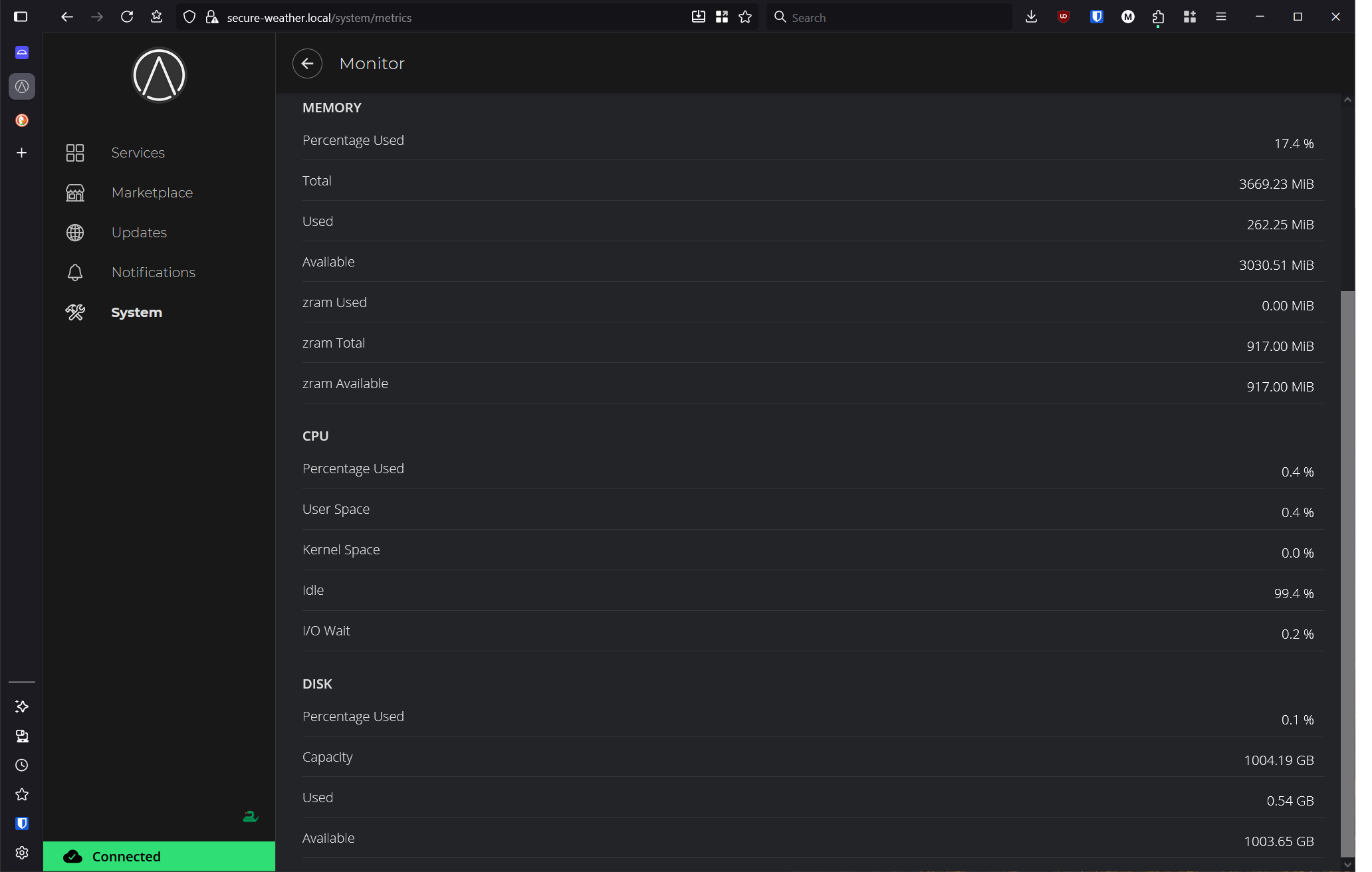

Okay, I ended up going with Bitcoin 29.1. I would have preferred to use 28.1 since that the version we were on then this conversation started. But Umbrel doesn’t provide an easy way to install a previous version.
I’m on a 1GB/s Internet connection, so I’m planning on just starting all three of these at the same time, and see how it goes. Fresh install on Bitcoin Knots 29.1, with default settings:
Ready to commence.

These three Mini PCs don’t have wifi, but I can add usb wifi adapters if you want me to. I think I have three identical adapters I could use.
I’m going to start the IBD for all three of them at 03:00 UTC. I can always delete, and start over if anyone wants me to make any changes to the test environment. But I’d prefer to know before I start.
We’re now a little over 9 hours into this test. As we would expect, we’re making rapid progress, all three of them around 10% complete. This gives us the false impression that the IBD should be complete in 2 - 3 days.
