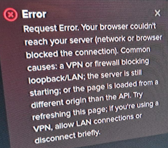

I had 0.3.5.1 running but the upgrade to 0.4.0-beta-9 is failing after starting the upgrade. Old OS won’t start now, so I guess I need to press forward getting 0.4.0 installed.
First error was “Disk Management Error: mkfs.vfat: I/O error (os error 5)” in the red background Error popup. This happened repeatedly at first.
A week later now, I am again trying to install 0.4.0 again and the error is different. I pick the 500GB os drive and 4TB data drive (nvme) and press Continue
I tried the install w/o network and w/ network plugged in and both produce this error
Reloading the page just restarts the install wizard.

The screenshot you show is not a StartOS migration error, it’s a browser error, where something between your browser and server is being intercepted and blocked. The solution is fully within your reach, but I don’t know where to tell you to look other than the suggestions in the message itself. Remember you don’t need privacy tools enabled to use your server securely – you don’t need to secure yourself from yourself. Your server is a trusted device.
Thanks for the reply… but this is an error from the Start9 installation wizard. That wizard presents a browser window, so there is a browser. No obvious server, though, since I am installing that server in the browser provided by the boot ISO.
I heard a rumor that my problem may be due to using Ventoy instead of a flashed USB. If so, I hope that is something Start9 could fix.

I appreciate the assistance, but I am not sure how this discussion got so far from the OP. The original problem I reported was an error during the install process from the boot ISO to my PC – not a kiosk, not talking to a server.
In any case, the OP was encountered after selecting target disks for the OS and Data. I was booting the Start9 iso using a usb disk and Ventoy (a boot manager for USB drivers - awesome tool overall).
The install worked after I switched to boot from a directly flashed USB. Same iso, same UI sequence, same disk selection, but no error and the install succeeded.
I wanted to post this to clear up what the OP was and that ventoy was (somehow) the trigger. I’ve installed many OS’s using Ventoy (mint, pop-os, ubuntu, windows 10, …). I would love it if this were fixed, but I’ve worked around it for now.
