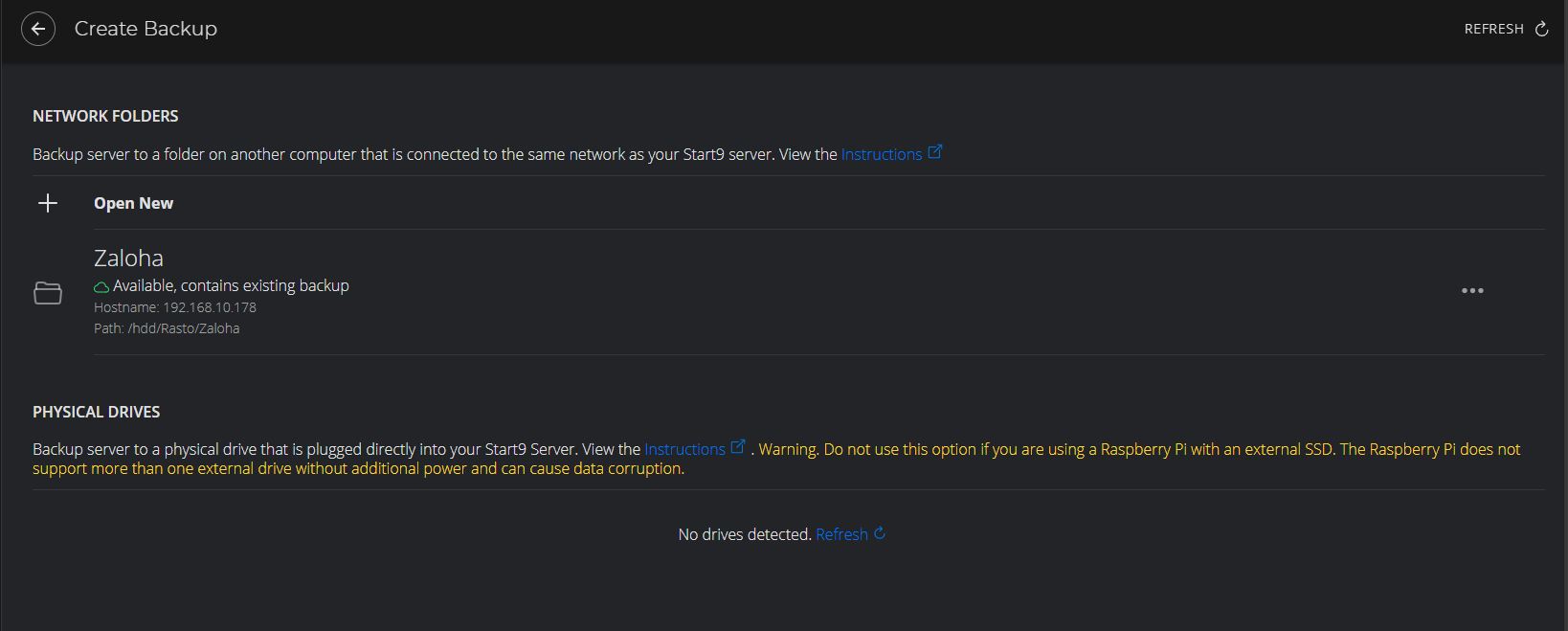

Hey,

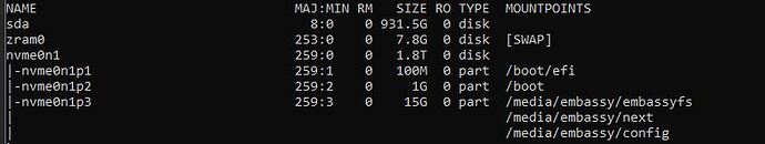

I wanted to do backup and plug in external USB cady with 1TB 3.5inch drive, but my StartOS does not recognize it.
Through the terminal I formated the drive again to EXT4, mounted it , but still was not recognized.
Any help please

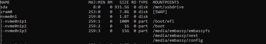

The adapter is fine, I can see and mount the drive through terminal

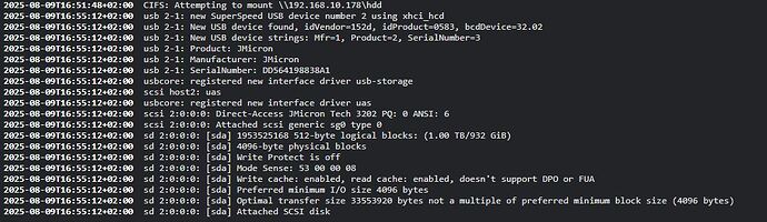

Next thing to have a look at are the kernel logs when you attach this drive for the first time. It might well say what the issue is. If it doesn’t, I don’t think I have a next step for you.
This is the kernel log. Which says it does detect the sub drive. But no physical drive shows anyway. Only my network folder is there.

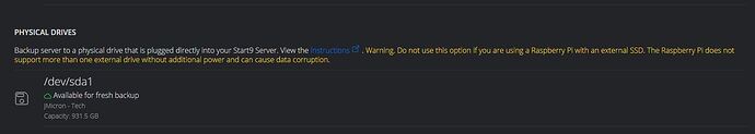

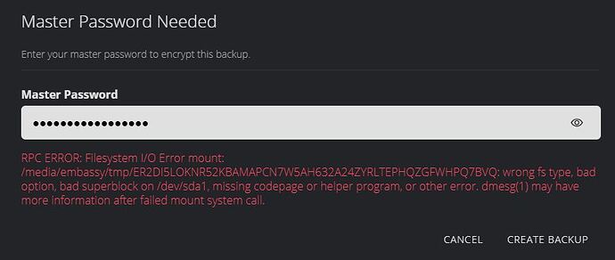

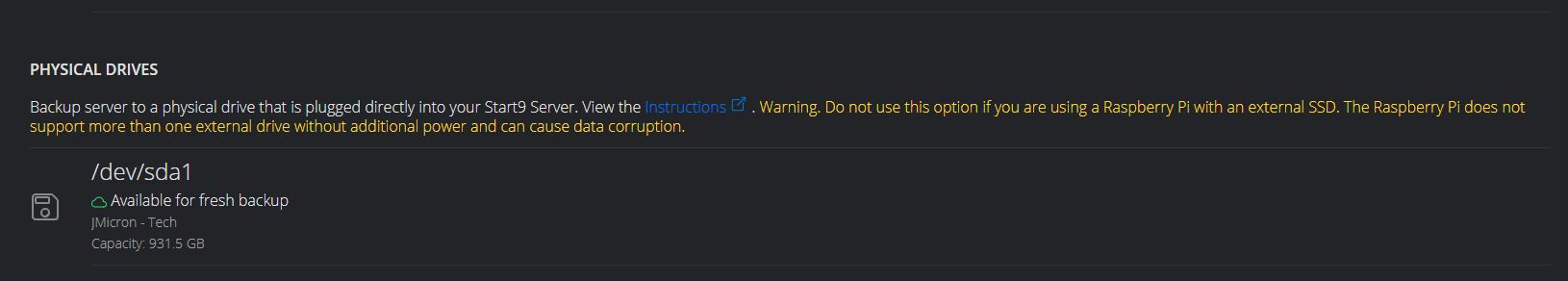

Update:
All good, I did not format the new sda1 partition. Now all works. Thanks ID3757
