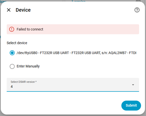

The Problem: When trying to set this up natively in the Home Assistant DSMR integration, the USB cable successfully shows up in the device dropdown menu (/dev/ttyUSB0 - FT232R USB UART). However, after selecting the correct DSMR version (Version 4) and hitting submit, it always throws a “Failed to connect” error in the UI.
Checking the Home Assistant Core logs confirms exactly why this is happening. While the host OS sees the port and populates the UI, the container itself lacks the actual device passthrough mapping to read it, resulting in this error:
2026-07-22 10:36:39.577 ERROR (MainThread) [homeassistant.components.dsmr] Error connecting to DSMR
FileNotFoundError: [Errno 2] No such file or directory: ‘/dev/ttyUSB0’
