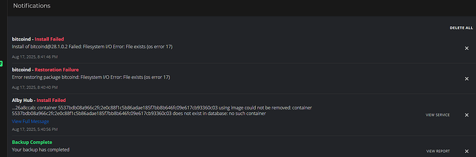

After trying to update Alby Hub my server has been performing terrible and Bitcoin Knots will not start. I uninstalled Knots and tried restoring from backup. No luck. Then tried reinstalling completely and now I get this error, “Failed: Filesystem I/O Error: File Exists (os error 17)”. I was also receiving an error when trying to save Knots Config. See attached Notifications. Any help would be greatly appreciated. I have not tried to Rebuild my system yet.

Clarify me, what problem are we trying to solve. In your screen above we have install/uninstall issues (restart/rebuild should fix) and entirely separately we have some kind of issue where the server is restarting over and over?
I was trying to reinstall Knots after it crashed. That was the main problem. I was able to get that fixed with chatgpt help. I deleted/cleared out all the files related to bitcoind on my drive. Then I was able to reinstall knots and it is currently downloading the blockchain. The restart/rebuild did not work in this situation.
