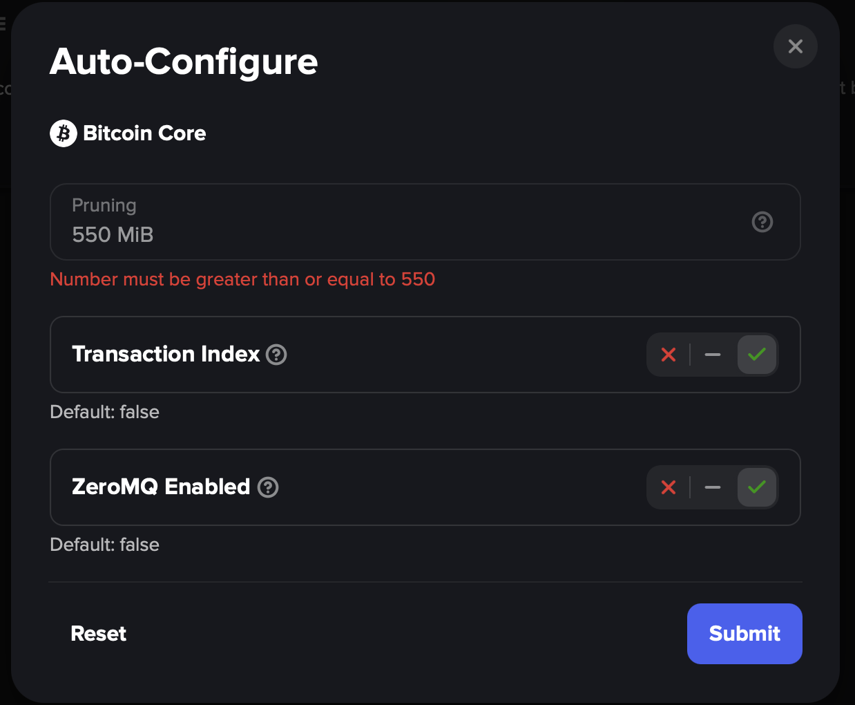

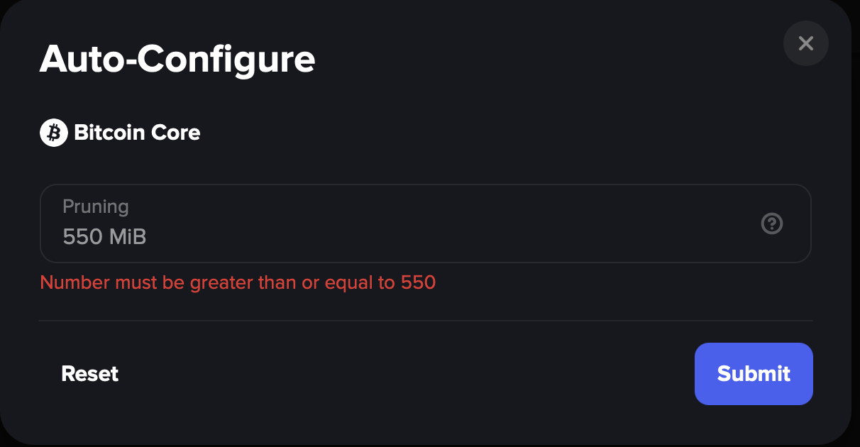

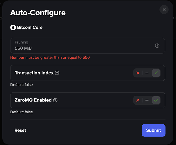

However, after fully syncing Bitcoin Core in pruned mode the Fulcrum service seems to require the pruned setting to be set to 0, which is greyed out - thus not working. Thoughts?

StartOS posts a critical task on Bitcoin Core to apply these settings if they are not already in place. After you install Fulcrum, you’ll need to resolve any critical task that appears on Bitcoin Core to enforce the required settings. It will take some time for Fulcrum to index, as it still needs to index the entire blockchain via on-demand block fetching. You’ll be able to connect wallets to Fulcrum with this configuration, but you cannot run the Mempool block explorer. I would be curious to know how well Sparrow’s block explorer feature works in this configuration.

Right, the critical task requires to set pruning to 0, which is disabled by bitcoin core service I presume. So can’t go forward with this.
