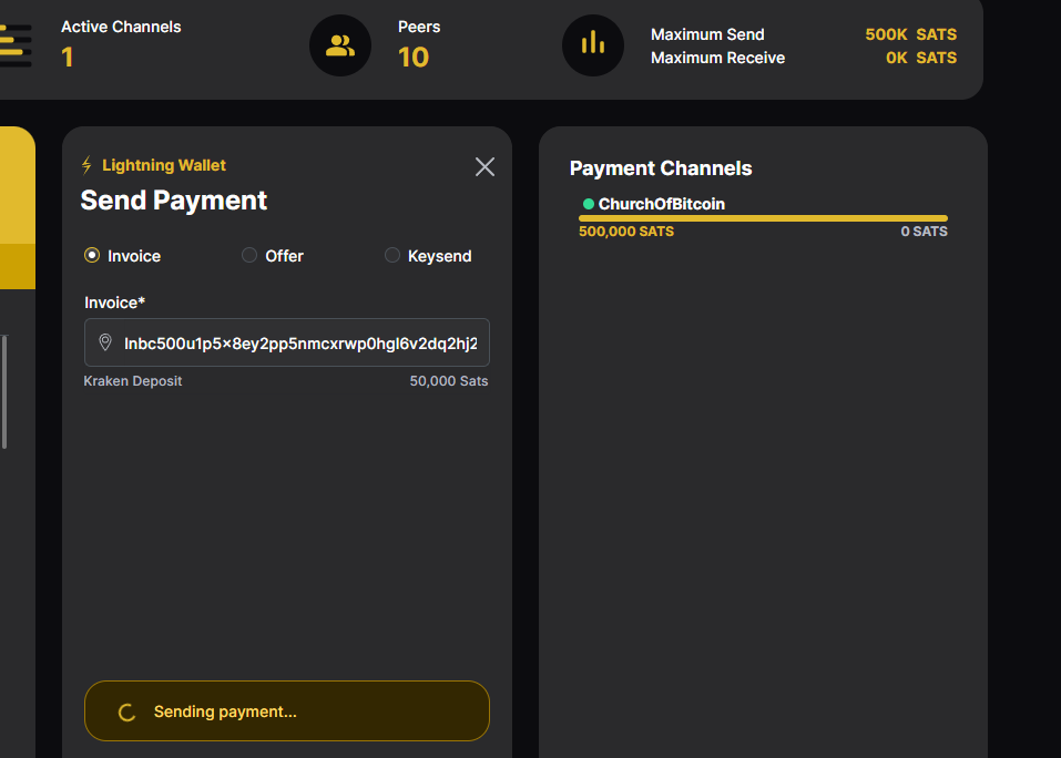

everything set up but my lightning wallet won’t send ant BTC via lightning wallet… keeps on sending, and nothing happens.
Everything on that screen looks good. If there was an issue with the sending, it should fail with an error. Did it fail yet? Is the place you’re sending to also as well connected as ChurchOfBitcoin?
If you go to CLN (in StartOS) and hit Config → Experimental Features, you can turn on XPay and save.
No never failed with error, but stopped sending by clicking the X on top. It is send to KRAKEN exchange, so I think they are well connected… Will try one more time with 100.000sats
started another payment with 100.000sats but same issue. Keeps on turning with sending payment. For like more then 1 hour. I will cancel the transaction. What else can be the problem?
Did you enable XPay?
Sorry, no never heard about Xpay. How do I enable? thanks
Please read the message above.
sorry, which link or message are you talking about?
Please read the answers I give you.
ok, sorry but never read this and can not find it either. But anyway, a big thank you, my payment worked fine and I now have inbound liquidity! hopefully I will receive the payments from ocean now. Again thanks so much for your help.
