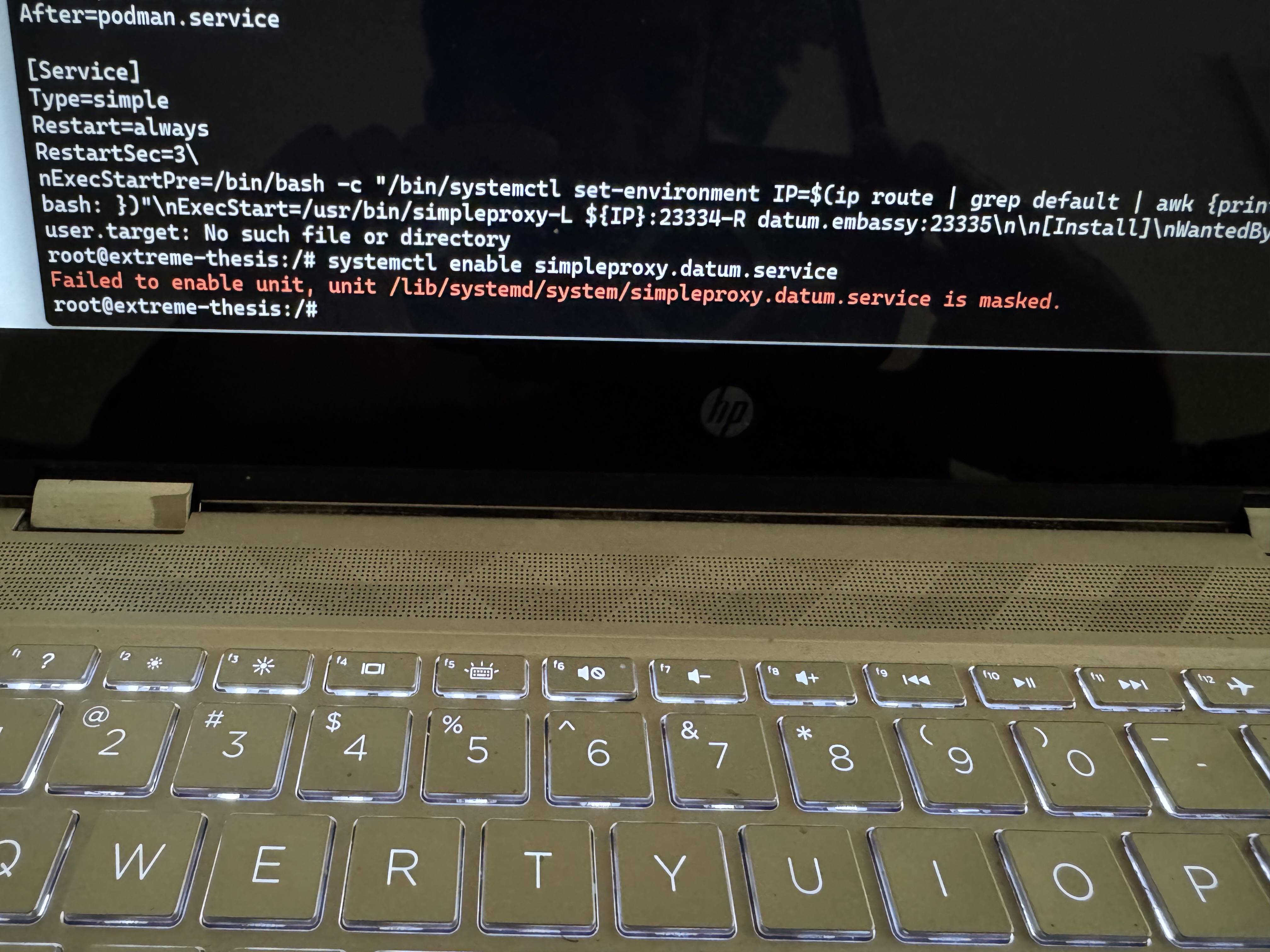

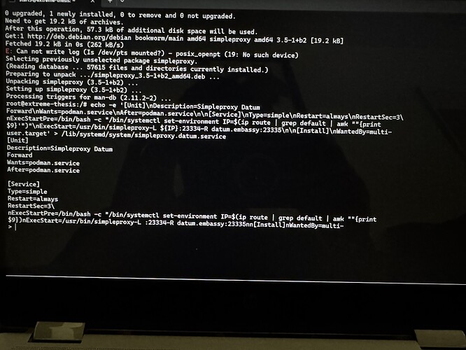

I’m specifically running into problems with the part of the long string of code that begins with echo -e. When I copy paste and enter it into my command prompt I either get a weird message that no such file or directory can be found and the root@start9 prompt doesn’t return and I just get an >

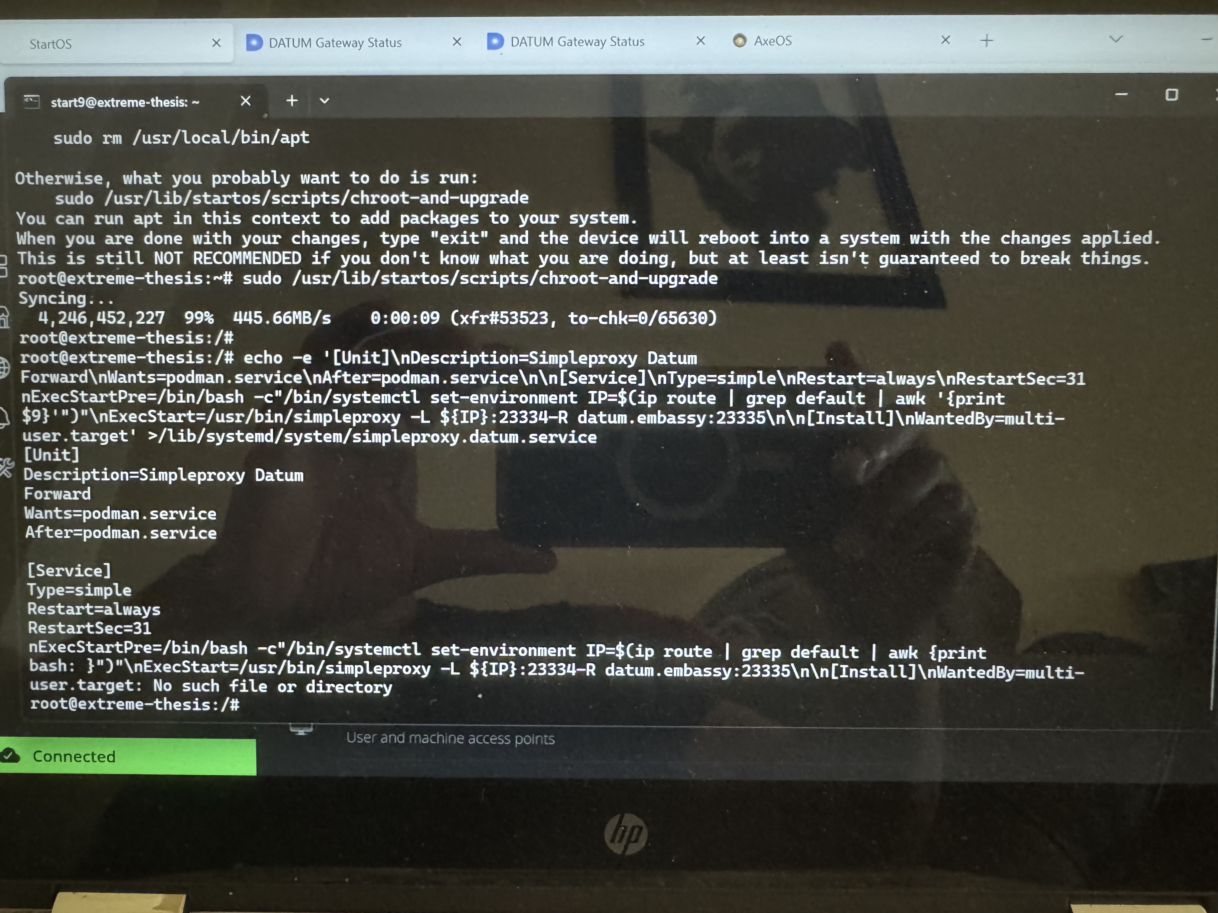

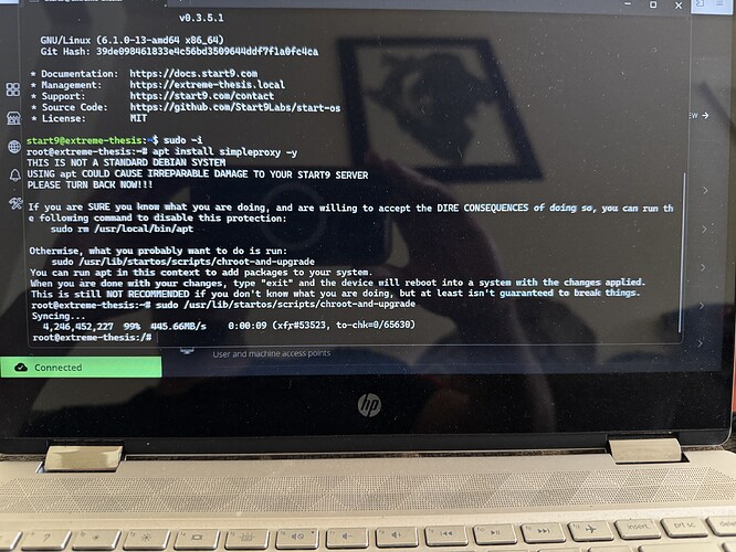

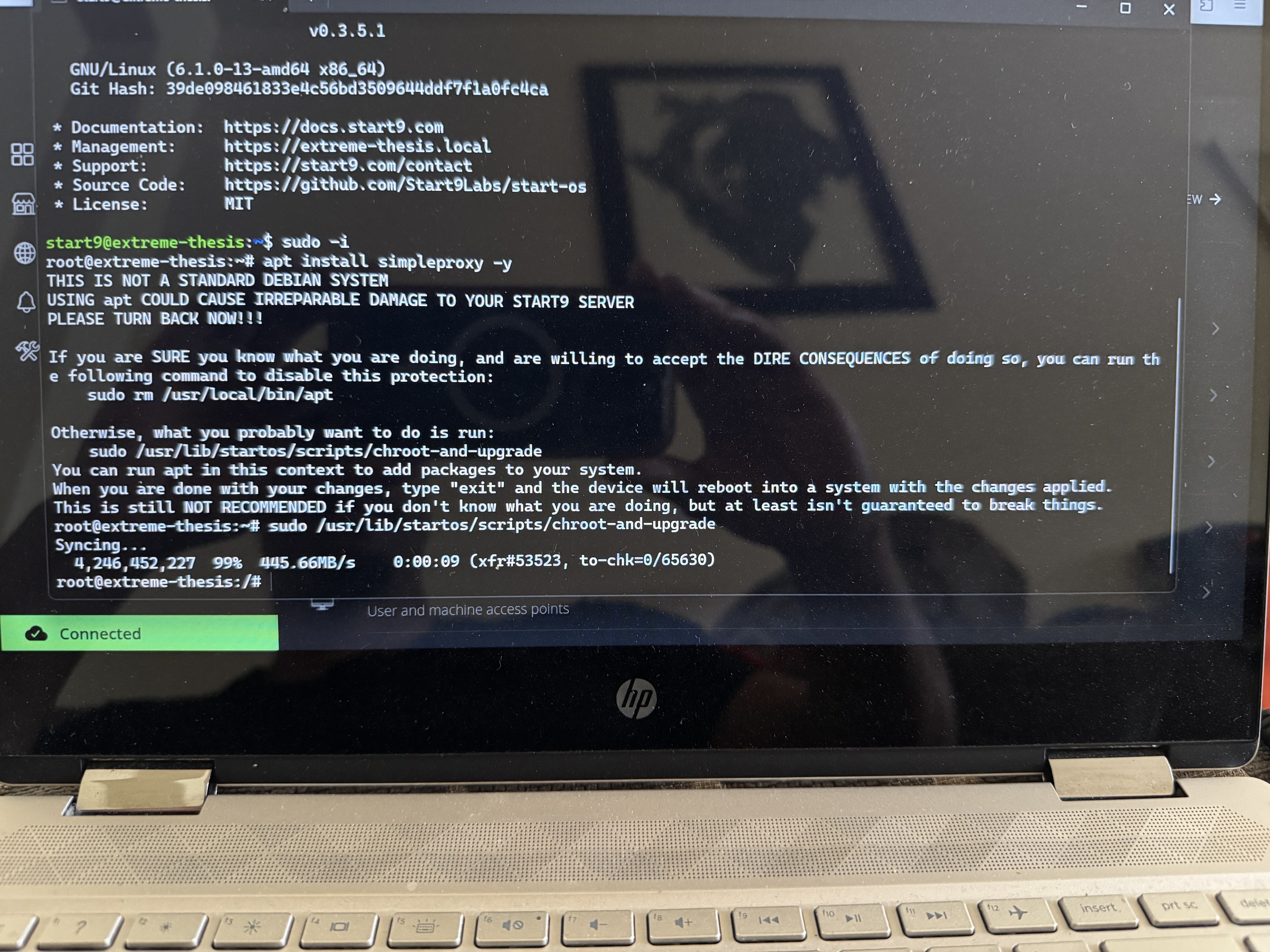

Can anyone help me to figure out what’s going on? I provided some photos to show what I see after entering each line of code up until the echo -e part of the code
I’m not seeing anything obviously wrong, but it’s tricky to follow screenshots that are a frozen moment in time.

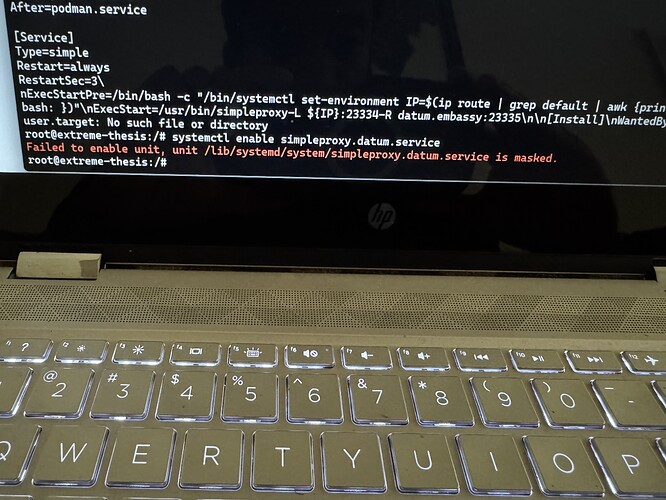

For the service to be masked means there’s something wrong with it. You could run…
cat /lib/systemd/system/simpleproxy.datum.service
…to take a look inside. If it’s malformed or empty, that might explain things, and we can probably do a couple of things to get back on track. If it looks complete fine, then I’m not really sure what has happened.
What I do know, is that you can get into a starting position again with a simple reflash of the OS, if you needed to.

start9@extreme-thesis:~$ sudo -i
root@extreme-thesis:~# /usr/lib/startos/scripts/chroot-and-upgrade
Syncing…
4,246,452,227 99% 432.01MB/s 0:00:09 (xfr#53523, to-chk=0/65630)
Syncing…
root@extreme-thesis:/# apt install simpleproxy -y

root@extreme-thesis:/# echo -e ‘[Unit]\nDescription=Simpleproxy Datum
Forward\nWants=podman.service\nAfter=podman.service\n\n[Service]\nType=simple\nRestart=always\nRestartSec=3
nExecStartPre=/bin/bash -c “/bin/systemctl set-environment IP=$(ip route | grep default | awk ‘{print
$9}’”)"\nExecStart=/usr/bin/simpleproxy -L ${IP}:23334-R datum.embassy:23335\n\n[Install]\nWantedBy=multi-
user.target’ >/lib/systemd/system/simpleproxy.datum.service
[Unit]
Forward
[Service]
Type=simple
Restart=always
RestartSec=3
nExecStartPre=/bin/bash -c “/bin/systemctl set-environment IP=$(ip route | grep default | awk {print
bash: }”)"\nExecStart=/usr/bin/simpleproxy -L ${IP}:23334-R datum.embassy:23335\n\n[Install]\nWantedBy=multi-
user.target: No such file or directory
root@extreme-thesis:/# systemctl enable simpleproxy.datum. service
Failed to enable unit, unit simpleproxy.datum…service does not exist.
So it looks like singproxy is being installed but something somewhere is going wrong. I copied and pasted the exact code from the Datum instructions. Could there be something wrong with part of the code somwehere?
Looks to me like your code block (echo statement) is not correct. For instance there are some missing quotes before the {print $9} . Should be triple single-quotes. Try copy pasting again.
ChatGPT told me the same thing but I don’t get how it could be copying and pasting the missing characters in the code. I’m copying it exactly as it shows on the start9 instructions. My only fear is that I add the wrong quotes and my server messes up on me again. Could you help me with that piece of code and I’ll copy it from here? I’ve tried numerous times and it just won’t work
Try this…
echo -e '[Unit]\nDescription=Simpleproxy Datum Forward\nWants=podman.service\nAfter=podman.service\n\n[Service]\nType=simple\nRestart=always\nRestartSec=3\nExecStartPre=/bin/bash -c "/bin/systemctl set-environment IP=$(ip route | grep default | awk \'{print $9}\')"\nExecStart=/usr/bin/simpleproxy -L ${IP}:23334 -R datum.embassy:23335\n\n[Install]\nWantedBy=multi-user.target' > /lib/systemd/system/simpleproxy.datum.service
This is really the easiest part, because at the end of the day you can just open it and fix what’s inside with…
sudo nano /lib/systemd/system/simpleproxy.datum.service
Here’s the command I used successfully:
echo -e '[Unit]\nDescription=Simpleproxy Datum Forward\nWants=podman.service\nAfter=podman.service\n\n[Service]\nType=simple\nRestart=always\nRestartSec=3\nExecStartPre=/bin/bash -c "/bin/systemctl set-environment IP=$(ip route | grep default | awk '''{print $9}''')"\nExecStart=/usr/bin/simpleproxy -L ${IP}:23334 -R datum.embassy:23335\n\n[Install]\nWantedBy=multi-user.target' > /lib/systemd/system/simpleproxy.datum.service
