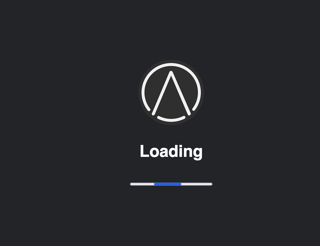

I followed the instructions for the upgrade to 0.040 and it just keeps saying Loading, see the attached image. Any idea what I should do next? I just run a node on my Start9 server so I don't have files per se. I tried to run over TOR along with my local, the local won't even load I am using http://start.local , and the TOR is just 'Loading’ as per the attached.

Hi @Napa, thanks for your follow-up note. A hard reset isn’t necessarily needed yet, this could just be a stuck migration or a stale/cached page.
A couple important notes based on your situation:
1. Migration can genuinely take hours. Expect progress to sit at 85% for a long time - potentially hours. It is not stuck. If your “Loading” screen is actually the migration progress screen (not just a browser hang), just leave it running.
2. start.local is only for the installer/migration screen, not your final address. Once your server has rebooted, go to your server’s own address (adjective-noun.local) - the address you used on 0.3.5.1, not start.local.
3. If you do get a page but it looks wrong/blank/old, that’s a caching issue, not a broken server: if you get the old 0.3.5.1 interface, a blank page, or a “cannot connect” error, your browser is serving you its cached copy of the old UI. The server is fine; the page is stale. Try an incognito window or hard refresh.
4. Basic local connectivity checklist (since you said local isn’t loading at all): Confirm your phone/computer is connected to the same network as the server, not a “Guest” network, not using Tor Browser, and not using a VPN (or that it allows LAN connections). Since it sounds like your update may genuinely be stuck (not just cache), and you’re OK starting fresh: the cleanest path is a flash reinstall with Preserve (keeps data) - but since you only run a node and don’t care about data, you could also do a fresh flash install instead. That avoids waiting on a potentially-stuck OTA update entirely.
If you want me to walk you through flashing 0.4.0 fresh via USB, I can definitely do that too. That’s usually faster and more reliable than troubleshooting a stuck OTA update.

Firstly thank you for your detailed responses. So after 48 hours it finally connected and updated via Tor. I must admit I love the new UI and I will dig into this version in the coming days. Problem solved. Thanks again!
