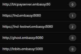

It needs the api key from the tunnel you created in CF, and then you use the CF dashboard to add public hostnames with routes to the internal hostname:port of each container:

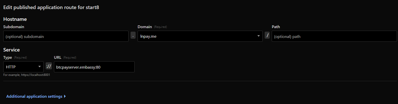

I would also like to get to btcpayserver, and have added the http://btcpayserver.embassy:80 line to published application route of the tunnel, and when I browse to the sub domain on clearnet it does try and open, but the page is blank.
If I view the source I see code is there, but there is also a message: āPlease enable JavaScript to continue using this application.ā
Is there a setting in the tunnel config that you know of in cloudflare that could be limiting the data and preventing it from loading?
Thanks again for your help!
Just checked, but I donāt have any special config in the route:
(everything under āAdditional application settingsā is default)

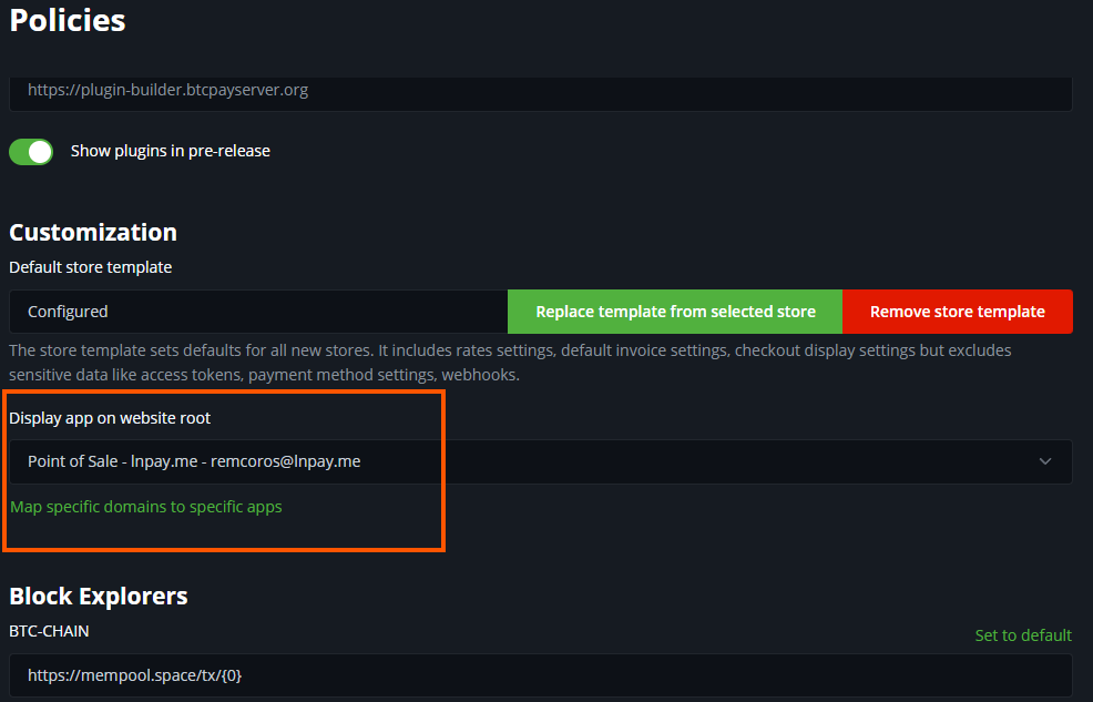

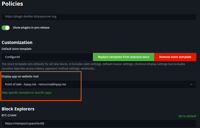

Did you set a ādefault appā inside the BTCPayServer settings? Server Setting ā āDisplay app on website rootā ā choose your āapp/pageā:
I have switched the default page and it still does not display. I know the new page is trying to render as the title is different and source code but the same error.
I tried different browsers and devices with the same issue.

Is there a way to setup a route to a specific store or crowdfund on btcpay server while still keeping the default one active on another subdomain?
I want to setup a few different subdomains to open different apps
Add the subdomain to the cloudflare dashboard and route it to btcpay.embassy, the same way as for the main domain, and then you can map those (sub)domains to btcpay apps in BTCPayServer settings, (see the screenshot above, click on āMap specific domains to specific appsā).
Thank you! works perfectly ![]()
