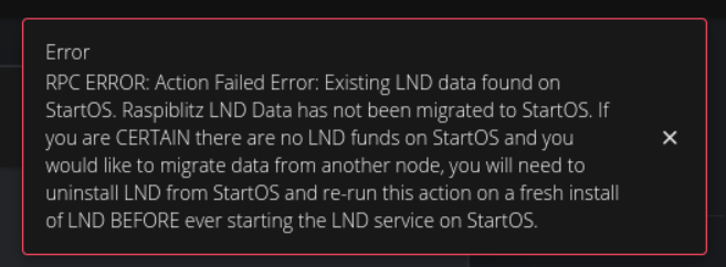

I thought I could migrate the hard drive from the Raspiblitz, but that’s apparently transferred via LAN. I accidentally started LND, then uninstalled and reinstalled it, but there seem to be some leftover data parts preventing the Raspiblitz migration.
The second problem is that the Raspiblitz won’t start anymore – the progress bar has been stuck at 99.8% for weeks!
Is an immigration process even possible in such a case?
I’m not sure of that error message is entirely correct. But if you uninstall LND, all associated data is removed. So as it states, you can do a fresh install of LND, and proceed.
The instructions assume a functioning Raspiblitz node. You have to get there as a prerequisite. So doing that, is your stating point. You may need to seek Raspiblitz specific support to get that running, and then we can help you from there.
