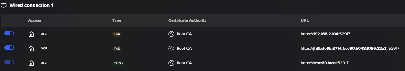

That’s what I’m doing. I tried all of them per the screenshot below, but it still won’t connect.

You can point the app at https://<IP>:<PORT>, but from what I am reading it usually won’t work because the Jellyfin client apps don’t allow for self-signed certificates, and you can’t get a publicly trusted cert for a raw IP address (Let’s Encrypt and other public CAs won’t issue them).
The Jellyfin maintainers have stated: “We will never add the option to ignore SSL errors. If you want to use a self-signed certificate you can add it to the trust store of the operating system.” Samsung Tizen TVs don’t give you a friendly way to install a custom root CA, so the self-signed route is essentially a dead end on the TV. Source: gitmemories
So basically, if an operating system REFUSES POINT BLANK to allow users to trust self-signed certificates or to trust a CA, then any Jellyfin app will not be able to connect to StartOS. Much like Jellyfin doesn’t want to degrade their software to satisfy a hardware manufacturer’s laziness or stupidity, Start9 dismissed adding http interfaces in the OS because it’s insecure.
