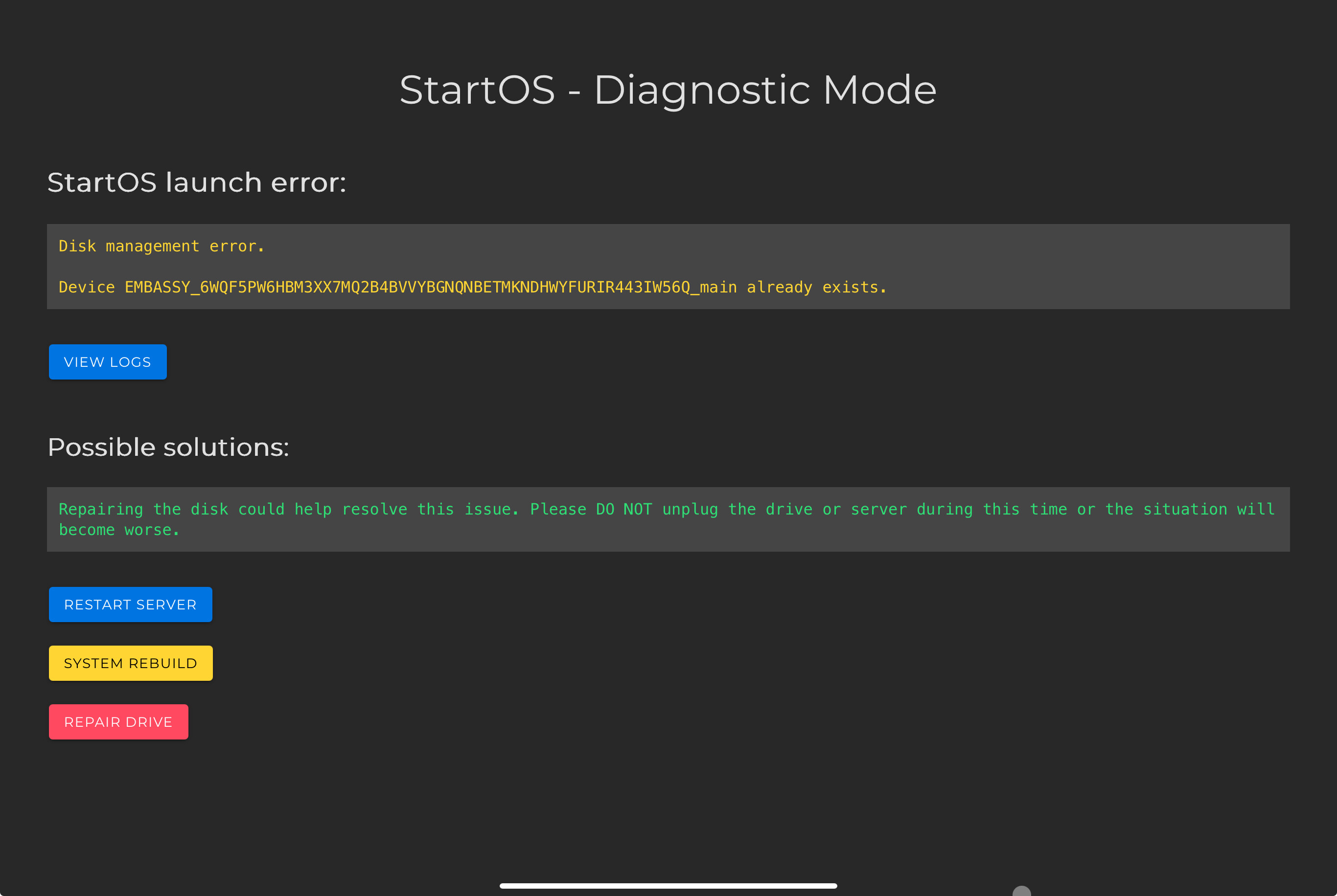

Is my Start9 server borked?
I have tried restarting and rebuilding (to no effect). Should I try repairing?

@Rick It just returns to the same screen after repair.

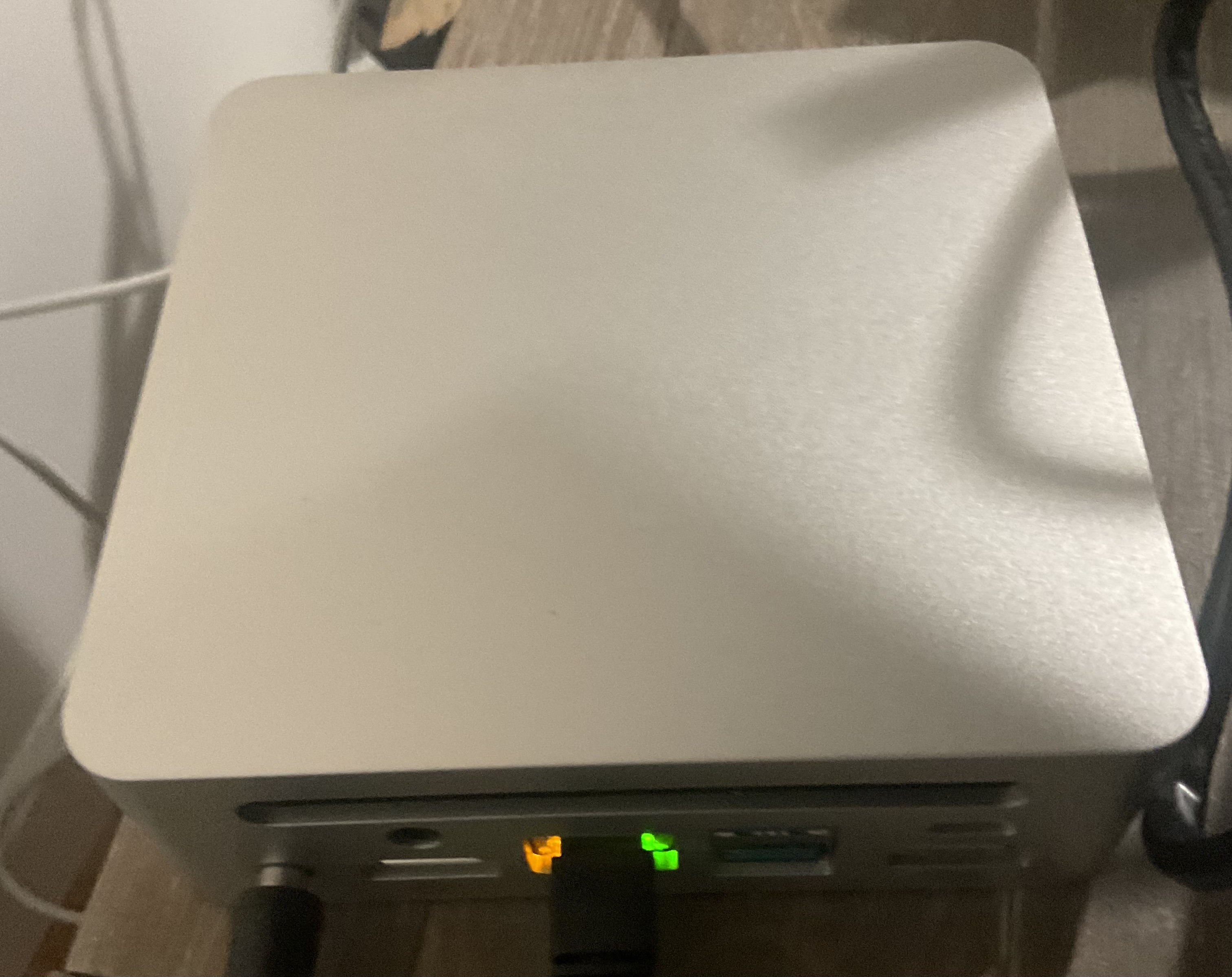

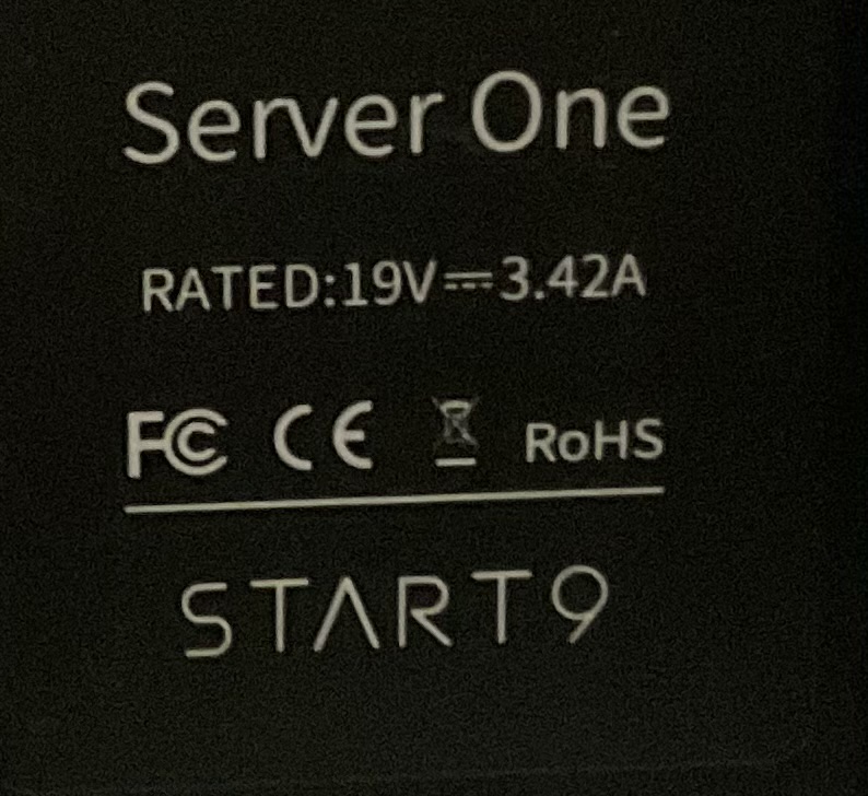

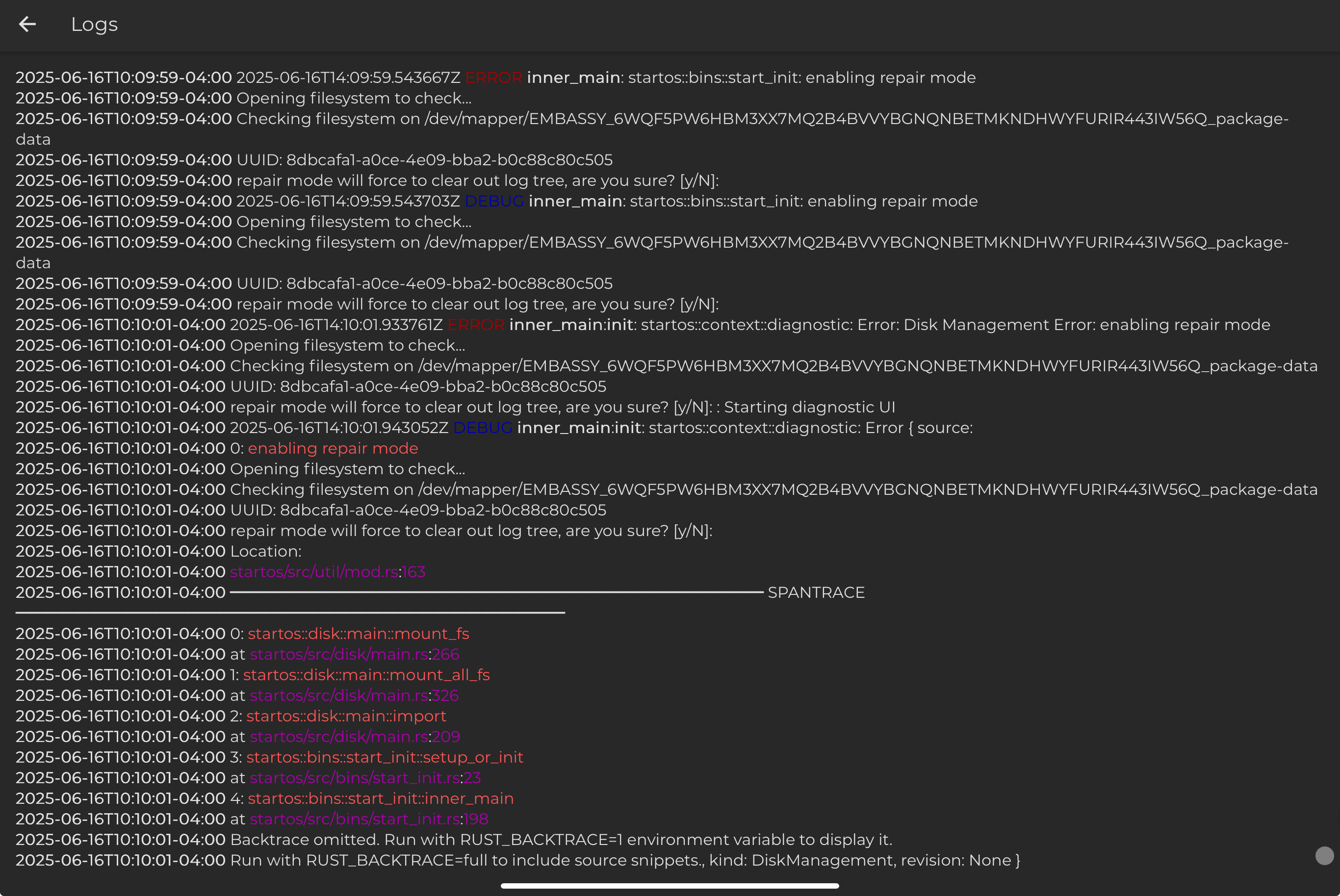

@Rexter I attached some images of the hardware and some extra logs. It’s a Server One unit. It’s connected to the Internet via a pretty solid router with good control over port forwarding, etc. The router is the only thing I’ve changed recently, but the start9 stopped working before I changed the router.
