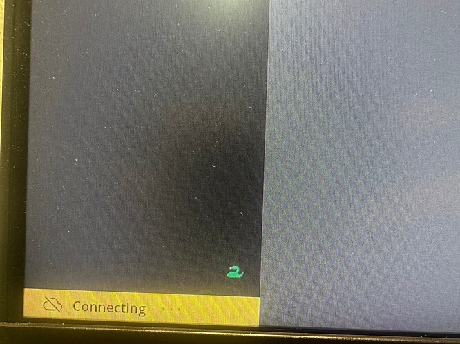

I meant this screen, and Yes, I’ve tried to refresh it, but it doesn’t work
This is the browser window, on the client device, not being able to find the server in the location it was at when the screen was loaded.
It is 100% impossible to see this screen if the browser is refreshed properly, you’d instead see all the screen go away and instead get a browser error screen.
I’d probably go ahead and restore the server again to get your funds back, though you can also try restoring just Jam and Bitcoin to this new install for the same effect.
