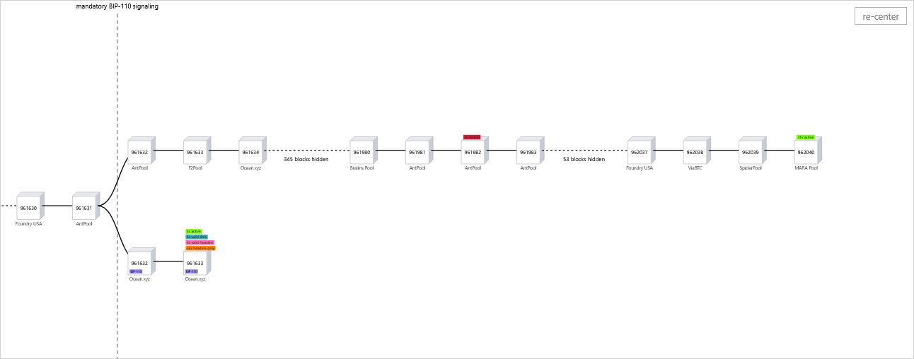

On the Knots/BIP-110 version of Bitcoin (separate, different Bitcoin) you’re on the latest block after the hard fork and the stalling of the separate chain.
You’ve done well to avoid all the discussion on this, especially as someone who chose Knots.
If you want to sync back to the main/majority Bitcoin chain to continue transacting, you’d either have to run the pre-RDTS version of Knots, or switch to Bitcoin Core.
This is the current state of the two chains, at the time of this post:
