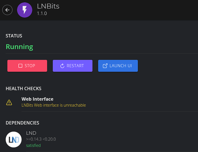

I started receiving this message “LNBits Web interface is unreachable” once I upgraded LNBits to 1.0. Was hoping that 1.1.0 would fix the issue but it is still happening. All other services running are fine.
Any ideas?

I had tried Step 1 already though I went ahead and did it again. Had also tried a System Rebuild. None of those have helped.
I restarted LNBits, nothing on the restart looked interesting.
2025-05-15T09:35:57-07:00 2025-05-15T16:35:57.752697Z DEBUG **run_main** : startos::net::net_controller: Dropping NetService for lnbits
When I try to launch the UI, the following errors repeat a few times and the page dies immediately. No other service is having this problem.
2025-05-15T09:36:39-07:00 Backtrace omitted. Run with RUST_BACKTRACE=1 environment variable to display it.
2025-05-15T09:36:39-07:00 Run with RUST_BACKTRACE=full to include source snippets., kind: Filesystem, revision: None }
2025-05-15T09:36:39-07:00 2025-05-15T16:36:39.053523Z ERROR startos::net::vhost: Error in VHostController on port 443: Filesystem I/O Error: Connection refused (os error 111)
2025-05-15T09:36:39-07:00 2025-05-15T16:36:39.053564Z DEBUG startos::net::vhost: Error { source:
2025-05-15T09:36:39-07:00 0: Connection refused (os error 111)
2025-05-15T09:36:39-07:00 Location:
2025-05-15T09:36:39-07:00 /rustc/cc66ad468955717ab92600c770da8c1601a4ff33/library/core/src/convert/mod.rs:716
Could you please restart then try to access your LNbits service via the .onion and the .local, then send me your logs from:
LNbits → Logs → Downloiad
System → OS Logs → Download
To the email address I’ve DM’d you.
