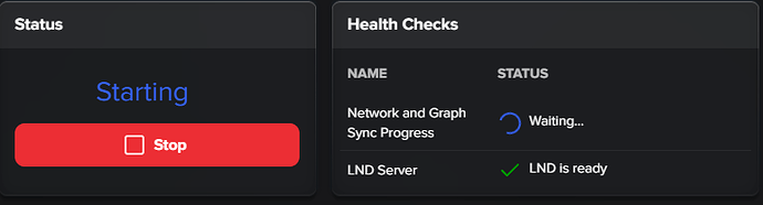

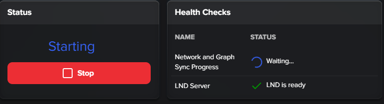

I migrated to 0.4.0 and the LND is starting indefinitely. the logs are stuck on this wanting to unlock the wallet???

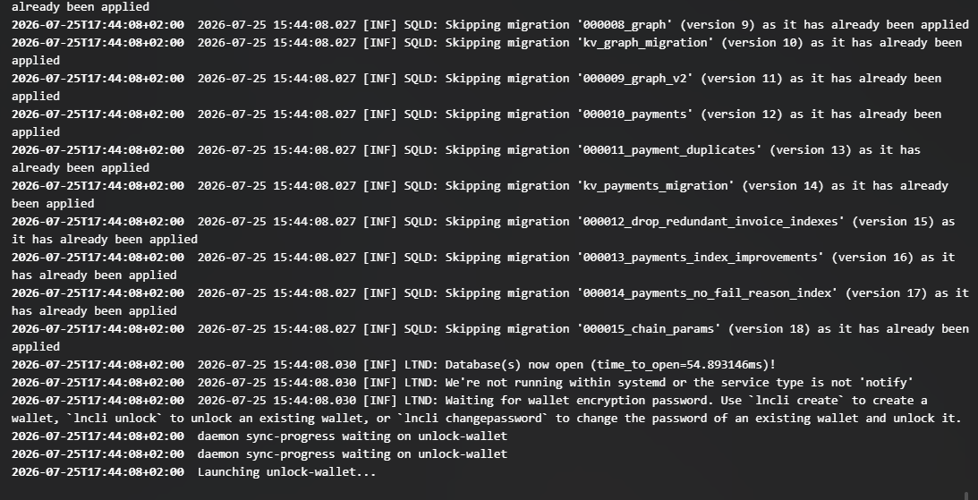

the issue I have is it’s stuck in this
2026-07-25T18:42:43+02:00 daemon sync-progress waiting on unlock-wallet
2026-07-25T18:42:43+02:00 Launching unlock-wallet…
that’s all I see.

2026-07-31T12:22:57-05:00 2026-07-31 17:22:57.960 [INF] SQLD: Migrating SQL schema to version 14
2026-07-31T12:22:57-05:00 2026-07-31 17:22:57.961 [INF] SQLD: Applying migrations from version=13
2026-07-31T12:22:58-05:00 2026-07-31 17:22:58.131 [INF] SQLD: 14/u payments_no_fail_reason_index (170.046474ms)
2026-07-31T12:22:58-05:00 2026-07-31 17:22:58.191 [INF] SQLD: Migrating SQL schema to version 15
2026-07-31T12:22:58-05:00 2026-07-31 17:22:58.192 [INF] SQLD: Applying migrations from version=14
2026-07-31T12:22:58-05:00 2026-07-31 17:22:58.343 [INF] SQLD: 15/u chain_params (151.036502ms)
2026-07-31T12:22:58-05:00 2026-07-31 17:22:58.549 [INF] LTND: Database(s) now open (time_to_open=6.552643453s)!
2026-07-31T12:22:58-05:00 2026-07-31 17:22:58.549 [INF] LTND: We’re not running within systemd or the service type is not ‘notify’
2026-07-31T12:22:58-05:00 2026-07-31 17:22:58.549 [INF] LTND: Waiting for wallet encryption password. Use `lncli create` to create a wallet, `lncli unlock` to unlock an existing wallet, or `lncli changepassword` to change the password of an existing wallet and unlock it.
2026-07-31T12:22:59-05:00 daemon sync-progress waiting on unlock-wallet
2026-07-31T12:22:59-05:00 daemon restore waiting on unlock-wallet
2026-07-31T12:22:59-05:00 Launching unlock-wallet…
2026-07-31T12:22:59-05:00 Launching reachability…
@StuPleb Should I attempt to rebuild LND to see if this will get the wallet unlock issue resolved?
Edit:
Rebuilding the service did not solve the the unlock-wallet issue.
Is there a path here to fix why StartOS is not sending LND the required pasword?
Notice in the logs there are no LND issues at all. Looks to be a StartOS issue.
