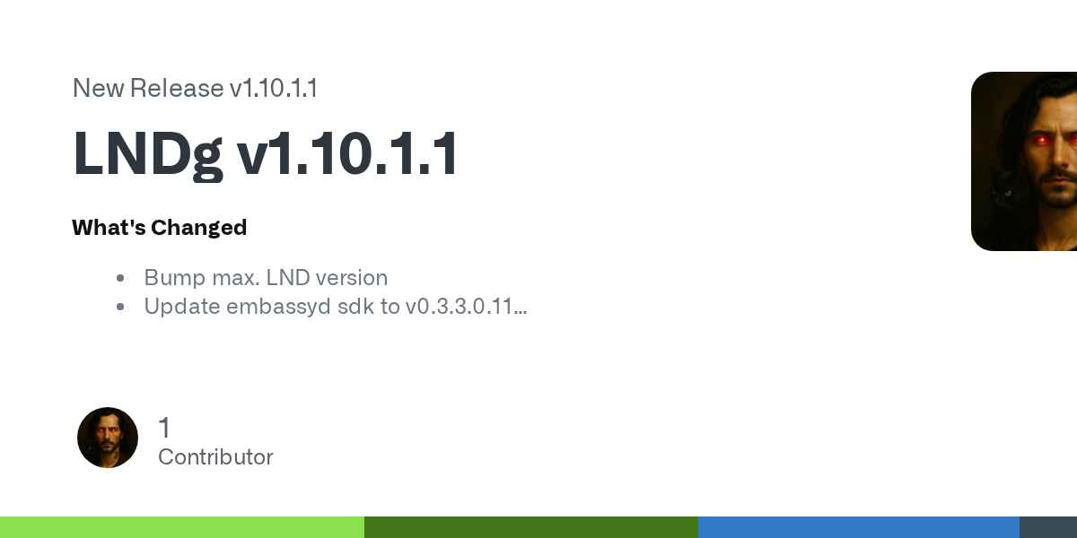

My latest changes are merched but the package is not released yet.
If you want to install this version now, you can sideload my s9pk for LNDg.
If you don’t want to sideload LNDg you can also load it via the GUI from the Community Beta Marketplace.
From your StartOS GUI - go to Marketplace. Under Start9 Registry click where it says “change” . This will allow you to change the registry from the Standard Start9 Registry to the Community Beta registry. Then search for LNDg, click on it and you can install it from there…
Hopefully after a bit more testing in beta, this LNDg version will be promoted from Beta to the standard Community registry.
