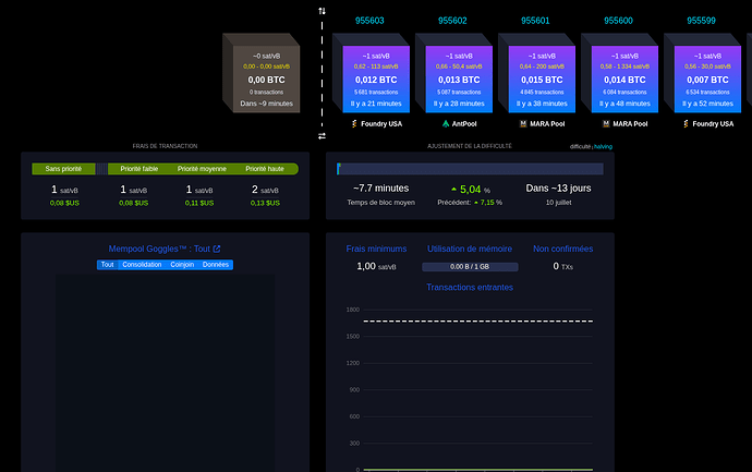

Hello,
I’m running a “backup” node in case something goes wrong with the main one I use.
However, on this backup node, which uses an external SSD and is less CPU-powerful than my main one, the mempool always appear empty.
I can see all the past blocks, I get the newly added blocks, but the “current mempool” or the “blocks to be mined” always appear empty (Attached image below).
There’s a warning in my mempool logs on the backup node which keeps repeating itself. This warning does not appear in the main node’s mempool logs (the one that works):
“2026-06-27T06:00:12+02:00 Jun 27 04:00:12 [2] INFO: Connected to Electrum Server at fulcrum.startos:50001 ([“Fulcrum 2.1.1”,“1.4”])
2026-06-27T06:06:15+02:00 Jun 27 04:06:15 [2] INFO: Core index ‘txindex’ is synced. Best block height is 955601
2026-06-27T06:06:15+02:00 Jun 27 04:06:15 [2] INFO: Core index ‘basic block filter index’ is synced. Best block height is 955601
2026-06-27T06:06:16+02:00 Jun 27 04:06:16 [2] INFO: migrated 0 audits to version 1
2026-06-27T06:06:16+02:00 Jun 27 04:06:16 [2] NOTICE: Migrating blocks to version 1 completed: migrated 0 blocks
2026-06-27T06:15:12+02:00 Jun 27 04:15:12 [2] INFO: Disconnected from Electrum Server at fulcrum.startos:50001
2026-06-27T06:15:13+02:00 Jun 27 04:15:13 [2] INFO: Connected to Electrum Server at fulcrum.startos:50001 ([“Fulcrum 2.1.1”,“1.4”])
2026-06-27T06:16:16+02:00 2026-06-27 4:16:16 5071 [Warning] Aborted connection 5071 to db: ‘mempool’ user: ‘mempool’ host: ‘127.0.0.1’ (Got timeout reading communication packets)“
Fulcrum logs do not show anything wrong, no warning or error.
Any idea what the problem could be ? I tried to rebuild mempool, but the problem did not disappear. It seems it keeps disconnecting from Fulcrum, and can’t access the db. How I could fix this ?
Thanks :slight_smile:

Hi, thanks for the answer. I get now that it comes from Bitcoin Knots and not the mempool itself.
After a long investigation and changes in my mempool settings (in Bitcoin Knots), I found the culprit: The dust relay fee I had set was way too high, so I reverted it back to default and now it works, I can see the transactions that are in the mempool.
Thanks for your help !
