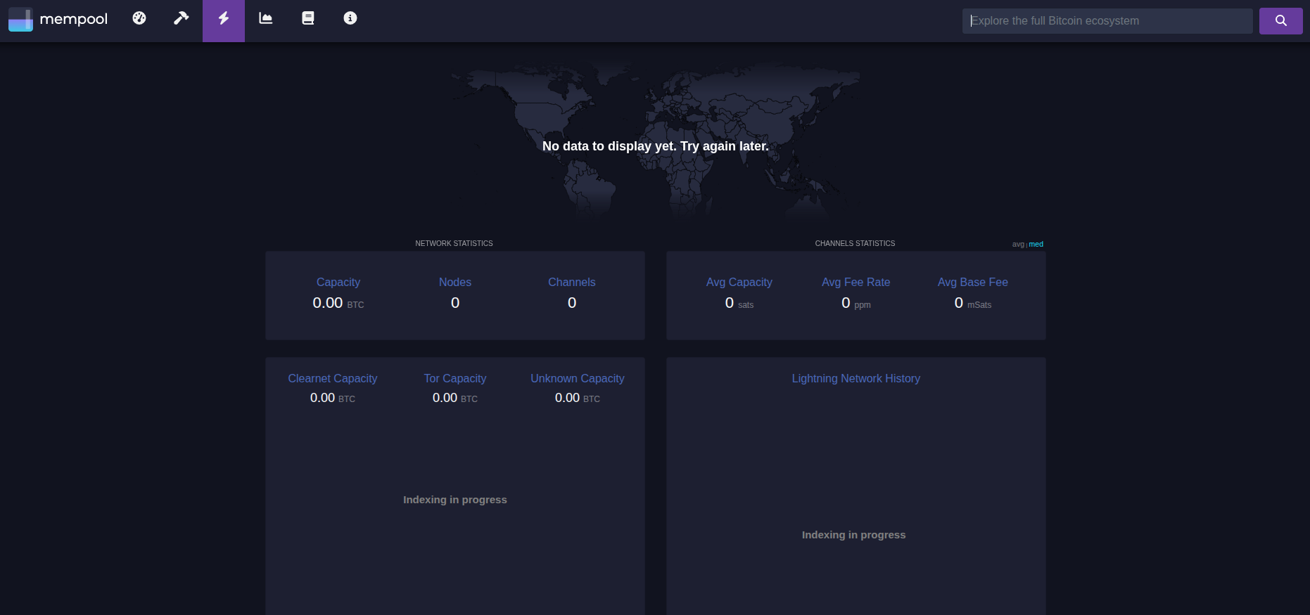

There’s just one thing I’m not able to make it work => the lightning stats on Mempool.
=> On mempool configuration I selected LND and activated Electrs.
Here is the result when I visit the page :
I already tried “System Rebuild”, uninstall/reinstall Mempool, restart LND in various combination with no success.
Am I the only one experiencing this ?
Could please someone help me to understand what causes this problem ?

2025-05-23T21:00:19+02:00  May 23 19:00:19 [358] INFO: <lightning> Latest BTC fiat averaged price: {"time":1748026820,"USD":108822,"EUR":95796,"GBP":80396,"CAD":149362,"CHF":89342,"AUD":167510,"JPY":15517500,"BGN":-1,"BRL":-1,"CNY":-1,"CZK":-1,"DKK":-1,"HKD":-1,"HRK":-1,"HUF":-1,"IDR":-1,"ILS":-1,"INR":-1,"ISK":-1,"KRW":-1,"MXN":-1,"MYR":-1,"NOK":-1,"NZD":-1,"PHP":-1,"PLN":-1,"RON":-1,"RUB":-1,"SEK":-1,"SGD":-1,"THB":-1,"TRY":-1,"ZAR":-1}
2025-05-23T21:04:11+02:00  May 23 19:04:11 [358] ERR: <lightning> Cannot fetch tx f808f1758e9c72e254a279fb9e927396b6e7b169b057a546083bfed35b7cfe37. Reason: ETIMEDOUT
2025-05-23T21:04:21+02:00  May 23 19:04:21 [358] ERR: <lightning> Cannot fetch tx d6f8f1023ba5cfe1a568121d0a5c19c8848f39d229cd0874cb581e16b65b2b31. Reason: ETIMEDOUT
2025-05-23T21:26:10+02:00  May 23 19:26:10 [358] ERR: <lightning> Cannot fetch tx f603591d96e4135bde08669bddbc62ab14ed487941b8c40465c311694e2f0427. Reason: ETIMEDOUT
2025-05-23T21:26:35+02:00  May 23 19:26:35 [358] ERR: <lightning> Cannot fetch tx 790bdf68106b3f73a467700b9a45a714918d232e88873ae041c62e30409a1047. Reason: ETIMEDOUT
2025-05-23T21:27:10+02:00  May 23 19:27:10 [358] ERR: <lightning> Cannot fetch coinbase tx f603591d96e4135bde08669bddbc62ab14ed487941b8c40465c311694e2f0427. Reason: ETIMEDOUT
2025-05-23T21:27:10+02:00  May 23 19:27:10 [358] ERR: <lightning> [Mining] Block indexing failed. Trying again in 10 seconds. Reason: Cannot fetch coinbase tx f603591d96e4135bde08669bddbc62ab14ed487941b8c40465c311694e2f0427. Reason: ETIMEDOUT
2025-05-23T21:27:10+02:00  May 23 19:27:10 [358] ERR: <lightning> Indexer failed, trying again in 10 seconds. Reason: Cannot fetch coinbase tx f603591d96e4135bde08669bddbc62ab14ed487941b8c40465c311694e2f0427. Reason: ETIMEDOUT
2025-05-23T21:27:28+02:00  May 23 19:27:28 [358] ERR: <lightning> $updateBlocks stalled at "getting block data for 898045"
2025-05-23T21:27:35+02:00  May 23 19:27:35 [358] ERR: <lightning> Cannot fetch tx 790bdf68106b3f73a467700b9a45a714918d232e88873ae041c62e30409a1047. Reason: ETIMEDOUT
2025-05-23T21:28:27+02:00  May 23 19:28:27 [358] INFO: <lightning> Core index 'txindex' is synced. Best block height is 898045
2025-05-23T21:28:27+02:00  May 23 19:28:27 [358] INFO: <lightning> Core index 'coinstatsindex' is synced. Best block height is 898045
2025-05-23T21:28:27+02:00  May 23 19:28:27 [358] INFO: <lightning> Core index 'basic block filter index' is synced. Best block height is 898045
2025-05-23T21:28:27+02:00  May 23 19:28:27 [358] INFO: <lightning> [Mining] Indexing 3127 blocks from #898045 to #888046
2025-05-23T21:28:32+02:00  May 23 19:28:32 [358] INFO: <lightning> [Mining] Indexing coinstatsindex data for block #898039. Indexed 7 blocks.
2025-05-23T21:28:33+02:00  May 23 19:28:33 [358] INFO: <lightning> [Mining] Indexing missing coinstatsindex data completed. Indexed 13
2025-05-23T21:38:50+02:00  May 23 19:38:50 [358] ERR: <lightning> [Mining] Block indexing failed. Trying again in 10 seconds. Reason: ETIMEDOUT
2025-05-23T21:38:50+02:00  May 23 19:38:50 [358] ERR: <lightning> Indexer failed, trying again in 10 seconds. Reason: ETIMEDOUT
2025-05-23T21:39:15+02:00  May 23 19:39:15 [358] ERR: <lightning> Cannot fetch tx 08da9276511d3f220f8cebcee44b070b108098ba24cd4320b43a23b62ac4b4cc. Reason: ETIMEDOUT
2025-05-23T18:47:03+02:00  May 23 16:47:03 [358] ERR: <lightning> [Lightning] $runTasks() error: timeout of 10000ms exceeded
2025-05-23T18:47:03+02:00  May 23 16:47:03 [358] INFO: <lightning> [Lightning] Starting Lightning Stats service
2025-05-23T18:47:08+02:00  May 23 16:47:08 [358] NOTICE: <lightning> [Mining] Inserted 168 MtGox USD weekly price history into db
2025-05-23T18:47:13+02:00  May 23 16:47:13 [358] ERR: <lightning> Exception in $logStatsDaily. Reason: timeout of 10000ms exceeded
2025-05-23T18:47:13+02:00  May 23 16:47:13 [358] INFO: <lightning> Starting lightning network forensics service
2025-05-23T18:47:14+02:00  May 23 16:47:14 [358] INFO: <lightning> [Lightning] Caching funding txs for currently existing channels
2025-05-23T18:47:14+02:00  May 23 16:47:14 [358] INFO: <lightning> Lightning topology folder is not set. Not importing historical LN stats
2025-05-23T18:47:46+02:00  May 23 16:47:46 [358] INFO: <lightning> [Mining] Inserted 608 Kraken EUR, USD, GBP, JPY, CAD, CHF and AUD weekly price history into db
2025-05-23T18:48:54+02:00  May 23 16:48:54 [358] ERR: <lightning> $updateBlocks stalled at "getting block data for 898028"
2025-05-23T18:46:52+02:00  May 23 16:46:52 [358] WARN: <lightning> Failed to parse rbf cache. Skipping. Reason: ENOENT: no such file or directory, open './cache/rbfcache.json'
2025-05-23T22:10:49+02:00  May 23 20:10:49 [358] ERR: <lightning> [Mining] Block indexing failed. Trying again in 10 seconds. Reason: ETIMEDOUT
2025-05-23T22:10:49+02:00  May 23 20:10:49 [358] ERR: <lightning> Indexer failed, trying again in 10 seconds. Reason: ETIMEDOUT

Ok LND is perfectly synced on both blocks and graph but the problem on mempool persists :
2025-05-29T22:09:50+02:00  May 29 20:09:50 [359] ERR: <lightning> [Lightning] $runTasks() error: timeout of 10000ms exceeded
2025-05-29T22:09:50+02:00  May 29 20:09:50 [359] INFO: <lightning> [Lightning] Starting Lightning Stats service
2025-05-29T22:10:00+02:00  May 29 20:10:00 [359] ERR: <lightning> Exception in $logStatsDaily. Reason: timeout of 10000ms exceeded
2025-05-29T22:10:00+02:00  May 29 20:10:00 [359] INFO: <lightning> Starting lightning network forensics service
2025-05-29T22:10:00+02:00  May 29 20:10:00 [359] INFO: <lightning> [Lightning] Caching funding txs for currently existing channels
2025-05-29T22:10:00+02:00  May 29 20:10:00 [359] INFO: <lightning> Lightning topology folder is not set. Not importing historical LN stats
Mempool doesn’t display any Lightning statistics.

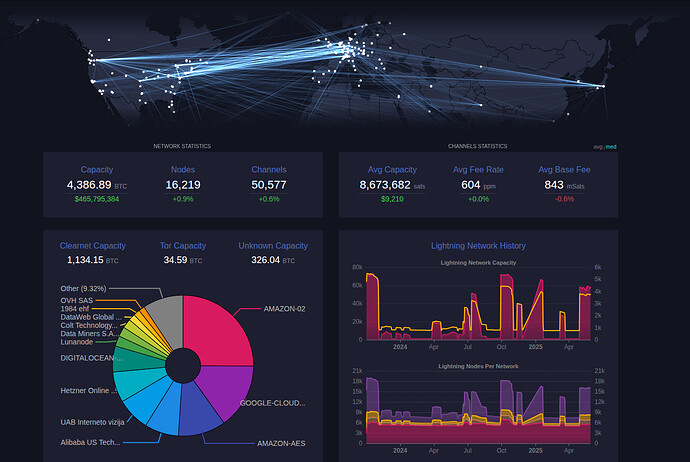

This is a StartOS problem, on my Umbrel stack on the same proxmox cluster with the VM having the same settings I can visualise lightning stats without any issue without the need to open any channel (see below) :
I’m not entirely convinced its a StartOS problem – if it was, other users would experience the same issue. That said, I haven’t met anyone using LND without channels or peers. I’d be interested to know if you do every open a channel if the issue goes away.
I can’t speak to what exactly those two Mempool log errors mean… that’s purely a Mempool thing. Perhaps the next step is to contact them.
Hello StuPleb,
I just realized that Mempool on Umbrel doesn’t have LND as a dependency service, just Bitcoin Knots and Electrs.
I suppose they pull the graph stats from an external source like mempool.space API or whatever.
This behavior could be configured on the mempool application.
