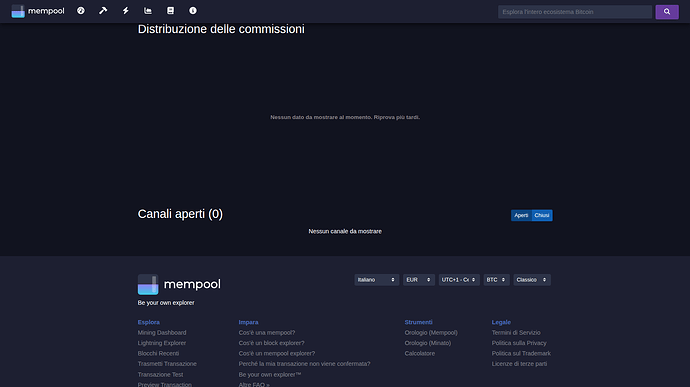

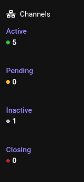

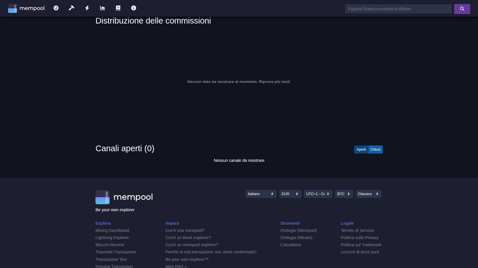

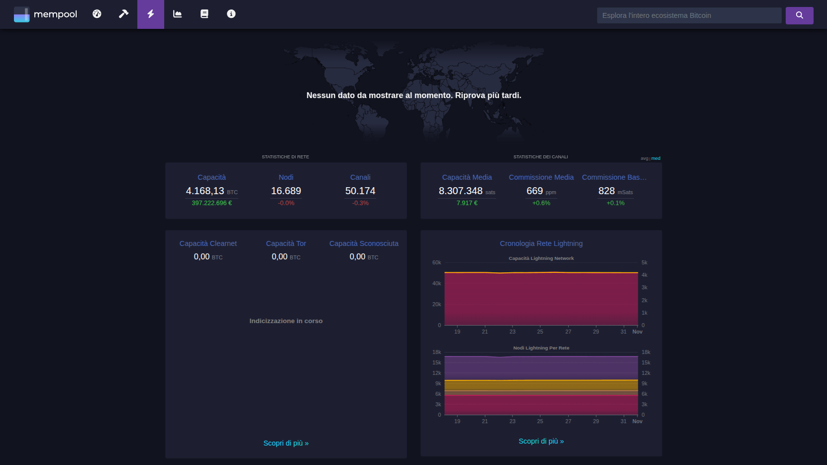

Hello,
I’m running into an issue with my Mempool service on StartOS and I’m hoping someone can point me in the right direction.

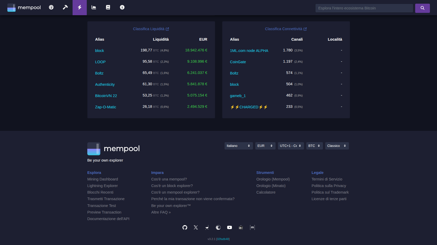

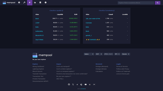

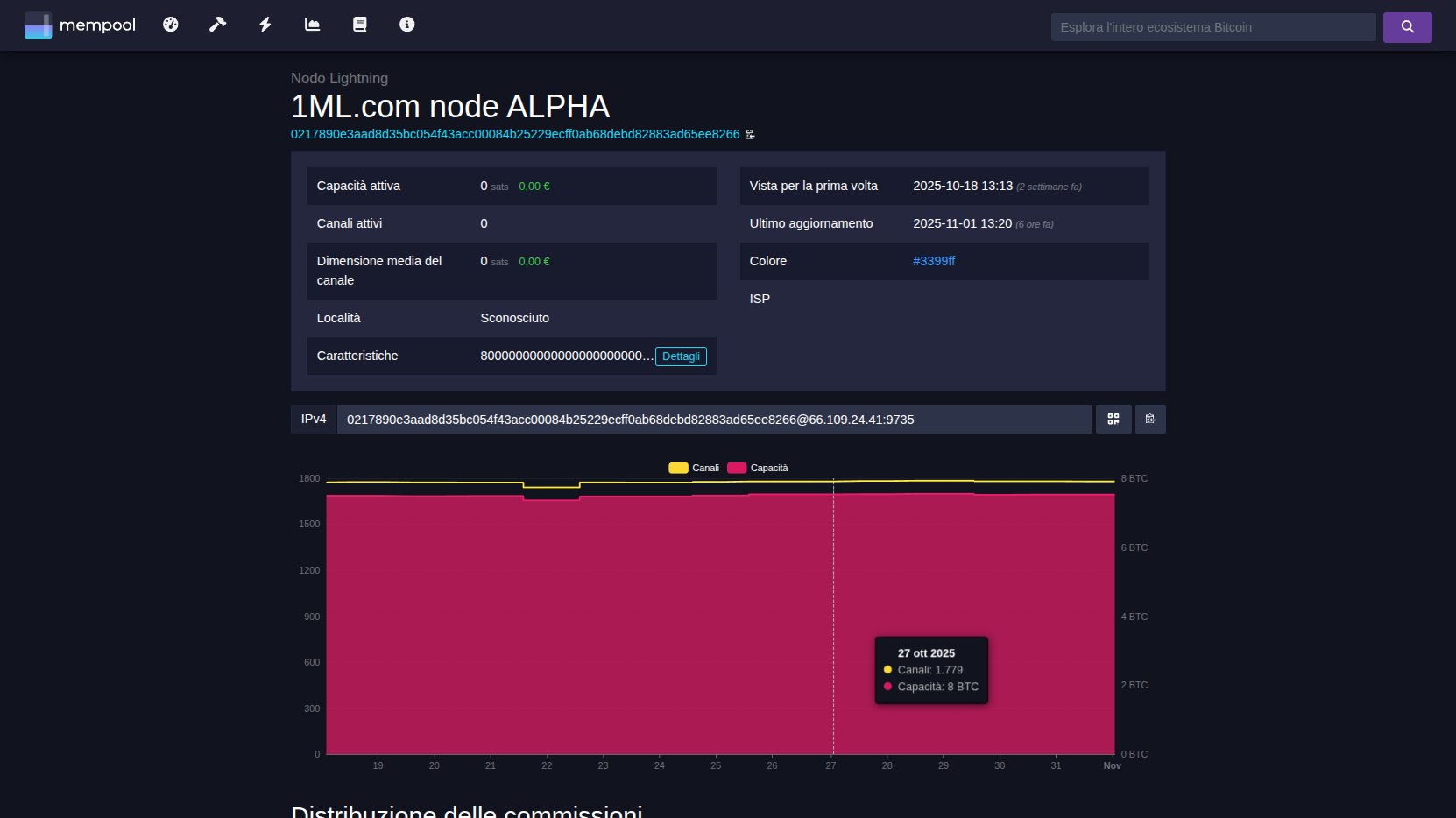

The Lightning Network section of my Mempool instance is no longer updating. I can’t see new nodes, and looking up existing node information doesn’t work. The data seems to be completely stale. The rest of the service (blockchain explorer, mining info, etc.) is working perfectly fine.
After checking the service logs, I found these recurring error messages:
ERR: <lightning> Could not connect to https://api.kraken.com/0/public/Ticker?pair=XBTUSD. All 1 attempts failed
WARN: <lightning> Could not connect to https://api.kraken.com/0/public/Ticker?pair=XBTEUR (Attempt 1/1). Reason: Request failed with status code 403
I’m not sure, but is it possible that these logs are connected with the fact that some information in the lightning section doesn’t work?
Has anyone had the same problem and knows how to solve it?
Thanks for your help!

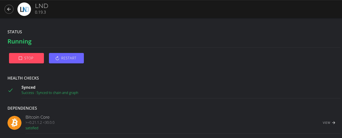

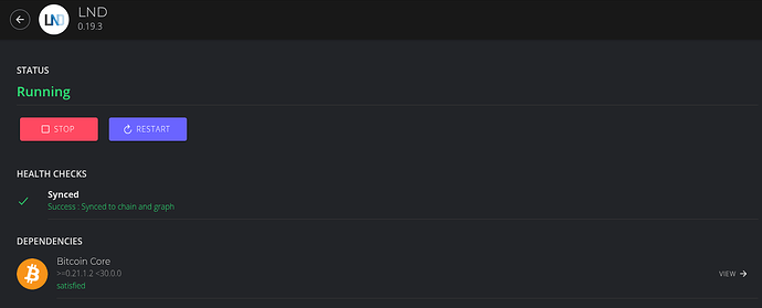

Thanks for the suggestion! I already tried restarting all the related services, and even the full node itself, but unfortunately nothing changed. Below are some excerpts from the logs you mentioned.

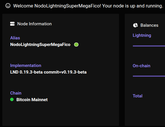

#LND

The only time I’ve seen something similar is when someone had LND installed, with no channels and failing to sync to graph.
Can you confirm the status of your channels in LND and of LND more generally?
I checked the LND app on my system, and everything looks fine. The node is running, synced to the graph, and the channels all appear to be in good condition. I also checked through Ride The Lightning, and everything looks okay there as well.
Schermata del 2025-11-04 16-27-07
Schermata del 2025-11-04 16-27-30
Well there’s nothing of any use in that snippet of the logs either.
