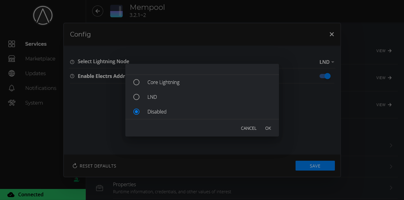

If you click config in Mempool there are 2 options (1) Enable Electrs address - Electrs is showing as satisfied & running (2) Select Lighning Node where the options are Disabled, Core and LND . I do not have Core or LND installed separately as when I installed Alby hub I chose to let it use its own node
There are no other Config options I can see. Selecting Core or LND gives an obvious error as they are not installed. Selecting Disable just leaves me with Mempool not working in a Needs Config state

Gotcha. I now realize I got confused by your typo on the mempool version number. If you are now on the latest available version, which is 3.2.1~2, but it says needs config, just open the config, save, and then start the service. This is common if something gets wonky during the update progress. No biggie.
What I was saying though is, if you want the mempool service to show lightning stats, it needs a lightning node to pull data from. So I recommend installing one. It cannot connect to the embedded light node provided by Alby Hub.

Sadly because when I didn’t know what to do I amended the config to try one of the settings to see if it worked & pressed save & it then went into stopping mode
If you don’t want to install CLN, or LND, just switch it back to disabled. If it still says stopping, restart the server:
System>restart
