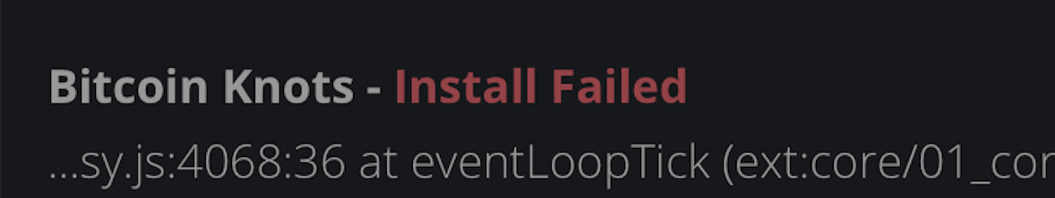

Need help after attempting updates- search error messages and could not find similar post

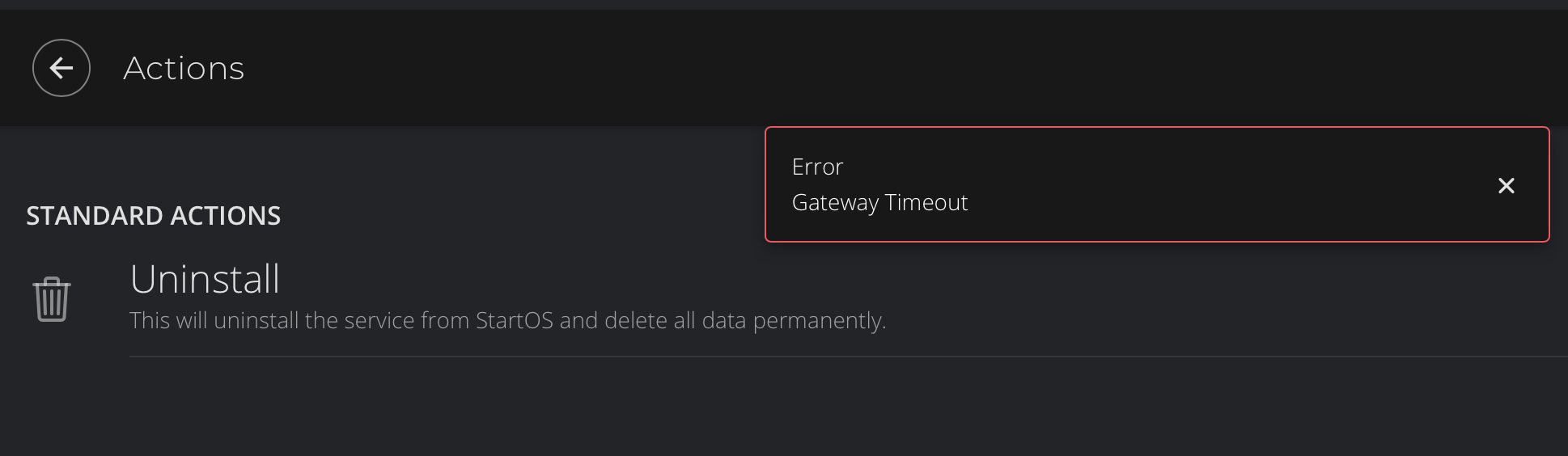

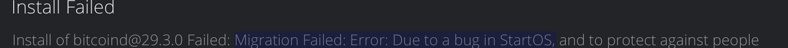

Running 0.3.5~1 Have Bitcoin Core and knots. I updated both Knots and Core, maybe should have just updated Knots. Any assistance would be appreciated. Also getting Gateway error while trying to uninstall a service.
You definitely haven’t “updated both Knots and Core” since you can’t run both at the same time. You can’t also upgrade one to the other accidentally. You’d need to upgrade the one you’re running or follow the guide to switch: Guide: Switching from Bitcoin Core to Bitcoin Knots on StartOS v0.3.5.1
Gateway Timeout means the server is not there… it’s turned off, restarting, or you’re on a different network. A hard refresh should show the current state.
Ctrl + Shift + R (Win/Lin)
Cmd + Shift + R (Mac)

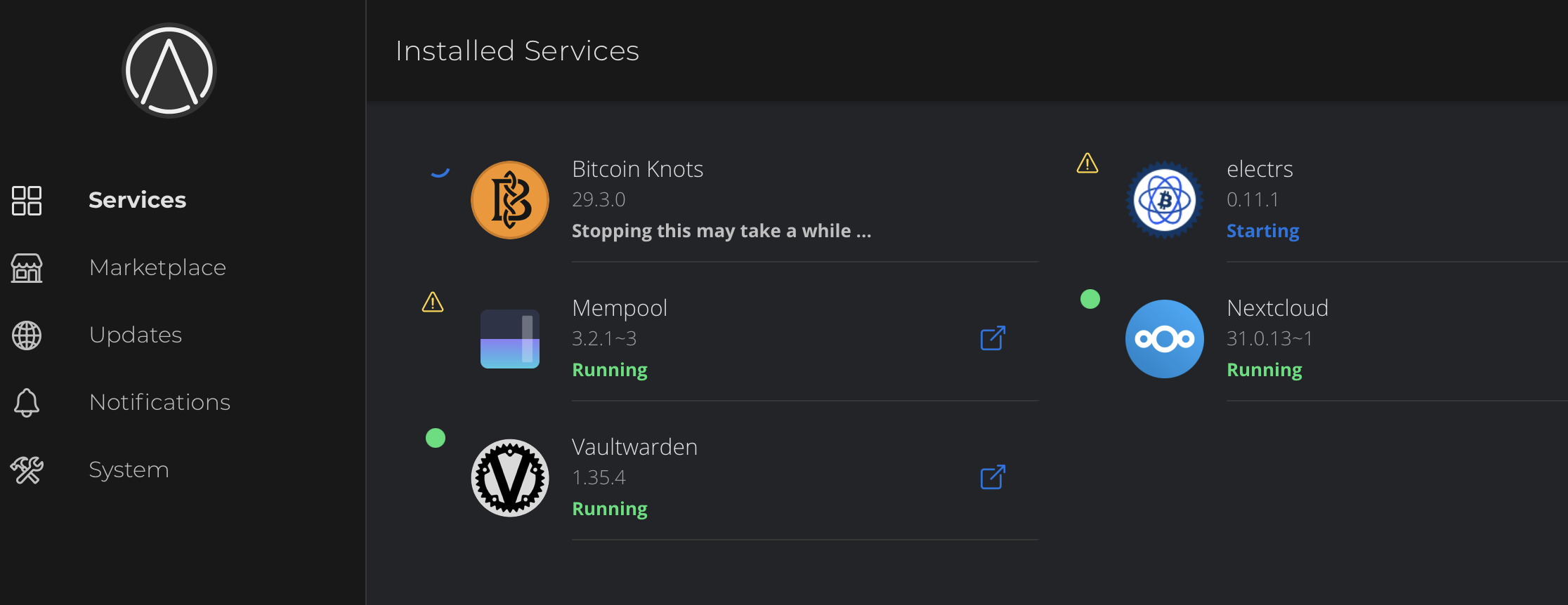

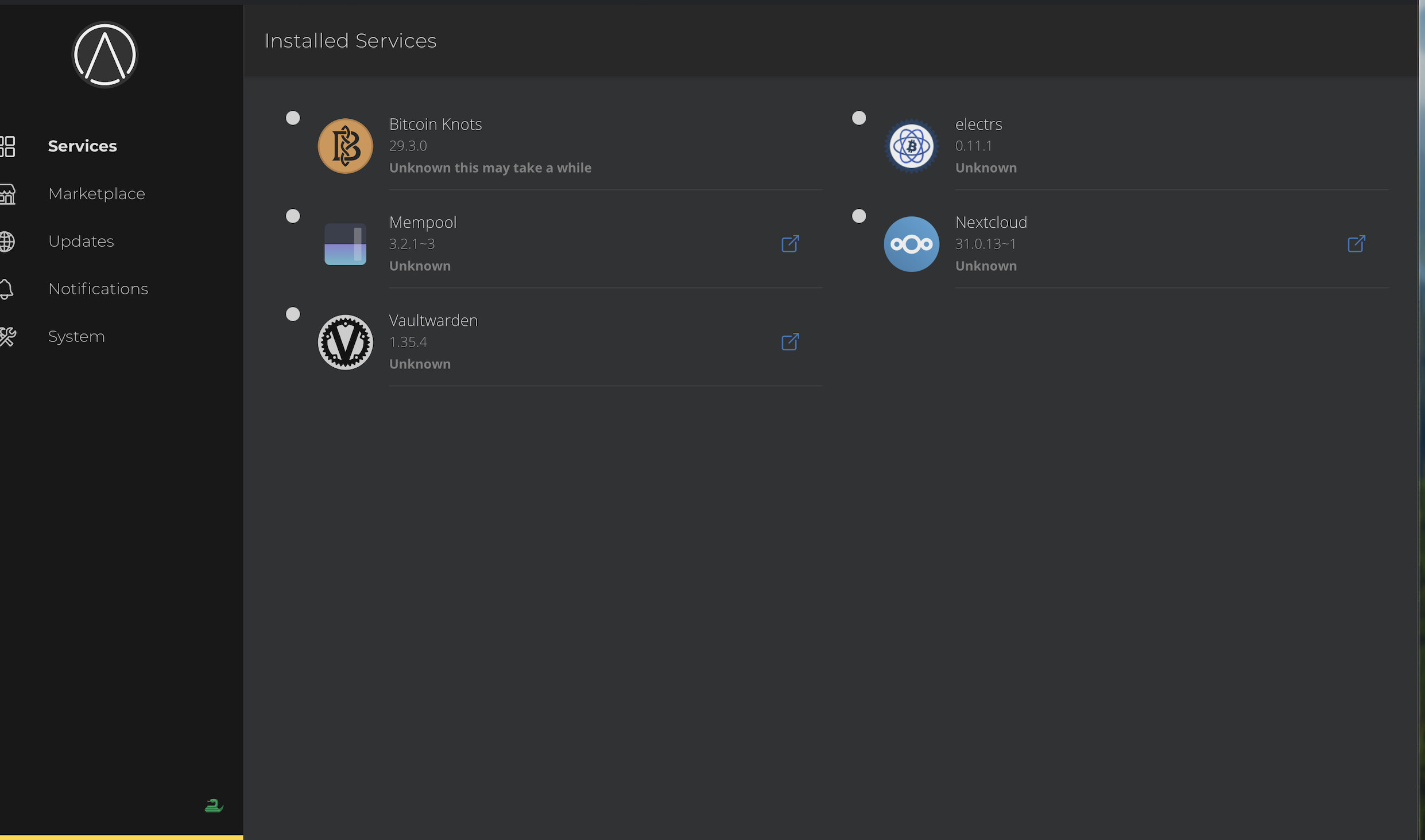

Stu- issue accessing my services is an issue again…Was working great for a long time. Server is up and running well but now it is not. I can get this far on Safari but cannot on Brave. Any assistance would be appreciated.
Stu: Turns out my certificate was not trusted on my new mac. I am working now Safari but for some reason cannot get Firefox or Brave to access. Any ideas why Safari is better to access? Thanks again for all of your help.
Got it working on Firefox I am all good now. Thanks…Never got it running on Brave but that it fine. Thanks again.
