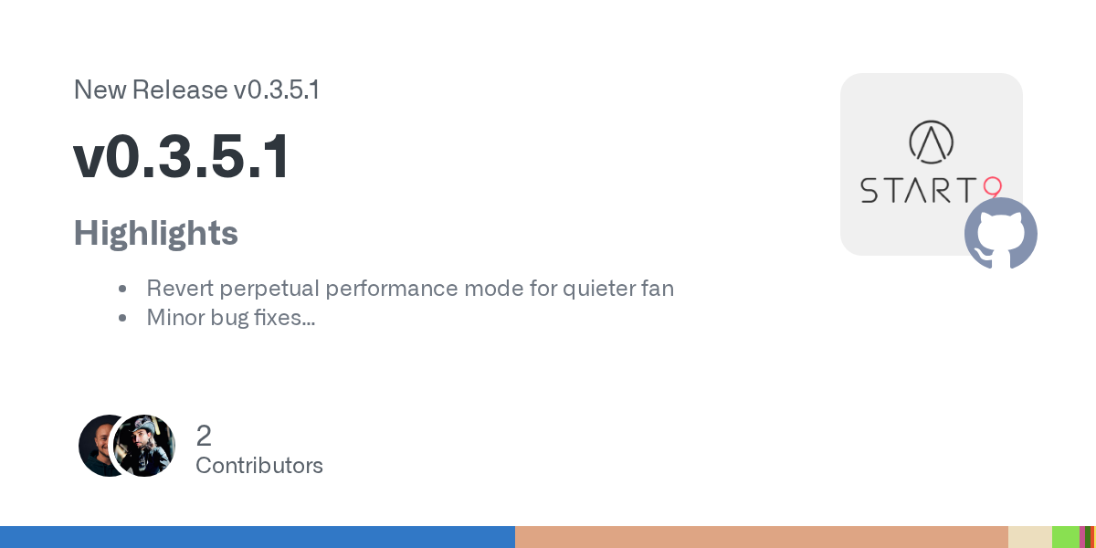

I messed up the install for 0.4.0 and need to restart at 3.5.1. I can’t seem to find the download for this on the github page
I’ll provide the link, but I encourage you to pause here a moment, and let’s figure out what’s going on. Restoring 0.3.5.1 may or may not be the best option. There are a lot of moving parts to consider. We’re here to help. Let’s discuss.
