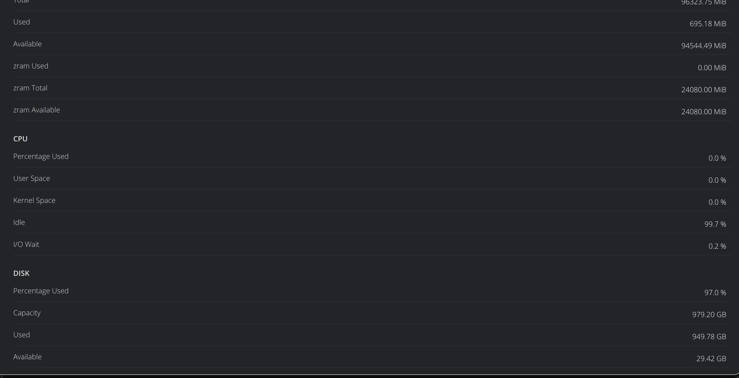

Im using a beelink gti with 2TB(1TB*2) after a day bictoin knots have synced and everything was running smooth until my first drive got full. Now bitcoing knots keep starting, synching, stop all over again. same issue is going on with electrum server.
Is there a way to make useful the other TB i have?
thanks for your help!!
this is a picture of my monitor in which there is only 1tb as disk space
StartOS doesn’t have a means to spread data across multiple drives. You’ll have to purchase a drive the meets your needs. 2TB is a good minimum.
If you’d like to migrate your data from your 1TB drive to your new 2TB drive, you can follow this guide: Start9 | Transfer Data to a New Drive

so just to be clear the solution is to buy a bigger drive because there is no way to use different drives with start9 software… Right?
Correct, you can’t spread data across different drives, using multiple drives as one large one, or picking and choosing which services go on which drives.
