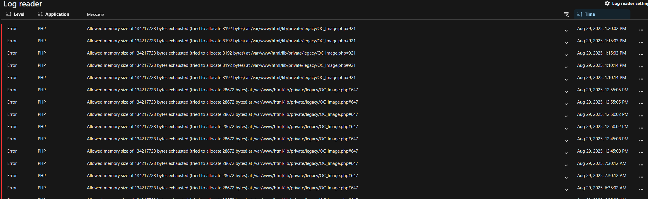

I recently installed Nextcloud on my device through the marketplace and installed the apps Memories, Recognition, and Preview Generator.
At some point index jobs for memories stopped running and when I check Basic Settings tab it tells me last background job execution was 18 hours ago. I believe this is related to Cron or a php file memory limit issue, but I don’t know how to fix this issue.
My logs give me the following error, but I’m unsure how to resolve it and get things running smoothly / background jobs executing as they should normally.

Hmm, Going to need a little more info please.
  1. What version of NextCloud are you using?
  2. Are you uploading a great big pile of stuff initially?
  3. Could you give us a screenshot of “Basic Settings” > “Background Jobs”? please
I was on the somewhat latest version of Nextcloud (30.0) and yes I started by trying to upload 1000+ photos on the first day.
At this moment I kind of gave up and Uninstalled Nextcloud then Installed again for a fresh start. I am now going through very systematically to try and avoid issues.
