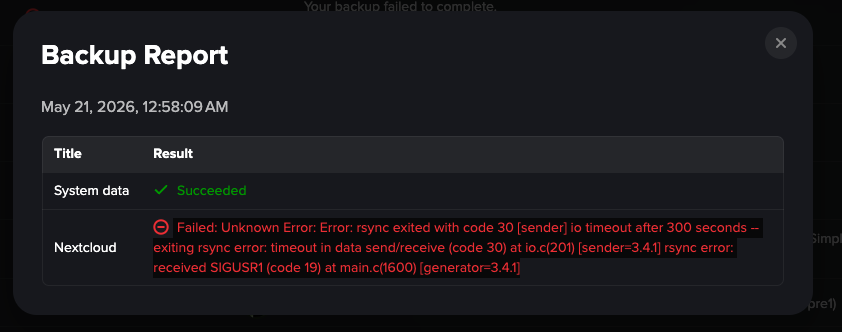

They run for a day or two and then fail with this error. I’ve tried turning off all services except nextcloud but still have the same issue.
Other services (Jellyfin, Vaultwarden etc) back up without issue
Failed: Unknown Error: Error: rsync exited with code 30 [sender] io timeout after 300 seconds – exiting rsync error: timeout in data send/receive (code 30) at io.c(201) [sender=3.4.1] rsync error: received SIGUSR1 (code 19) at main.c(1600) [generator=3.4.1]
Still USB drive? Odd for the USB drive to simply stop responding and interrupt the process. We’re working on improvements to the process, but it’s also worth pointing out that you’re one beta behind. I think Beta9 included slight improvements.
