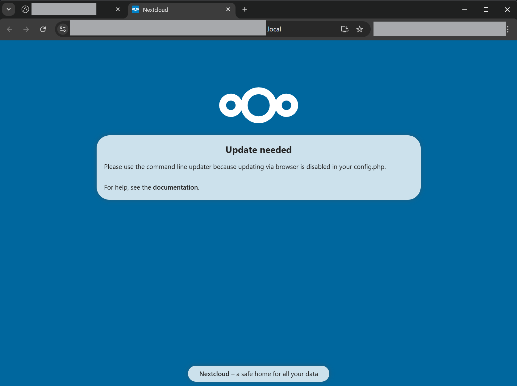

Recently I did the 28.0.14~1 update and since then the NextCloud instance is borked.
When I open the web interface it always shows the Maintenance Screen (couple of weeks now).
I tried the " Disable Maintenance Mode" and that results in a screen that shows:
" Update needed"
Please use the command line updates because updating via browser is disabled in your config.php.
For help, see documentation

From your description, since 28.0.14~1 hasn’t been out for the couple of weeks you say you’ve had the problem, I think what you actually did was…
  1. Upgraded to 28.0.14 – upgrade failed and error started
  2. Later upgraded to 28.0.14~1 and the error wasn’t fixed
I think you’ll next need to make sure you have SSH set up so you can access the command line. To do that, follow this guide here: Start9 | Using SSH
When ready, this is the plan…
The fix for users with a broken 28.0.14 installation is:
  1. SSH into the server.
  2. Exec into the nextcloud container (nextcloud needs to be running)
sudo podman exec -it nextcloud.embassy bash
  1. Disable non-default apps by running this command from within the NC container:
sudo podman exec -it nextcloud.embassy bash nextcloud:/var/www/html# declare -A default_map; default_apps=('activity' 'calendar' 'circles' 'cloud_federation_api' 'comments' 'contacts' 'contactsinteraction' 'dashboard' 'dav' 'federatedfilesharing' 'federation' 'files' 'files_pdfviewer' 'files_reminders' 'files_rightclick' 'files_sharing' 'files_trashbin' 'files_versions' 'firstrunwizard' 'logreader' 'lookup_server_connector' 'nextcloud_announcements' 'notifications' 'oauth2' 'password_policy' 'photos' 'privacy' 'provisioning_api' 'recommendations' 'related_resources' 'serverinfo' 'settings' 'sharebymail' 'support' 'survey_client' 'systemtags' 'text' 'theming' 'twofactor_backupcodes' 'updatenotification' 'user_status' 'viewer' 'weather_status' 'workflowengine'); for app in "${default_apps[@]}"; do default_map["$app"]=1; done; enabled_apps=($(sudo -u www-data -E php /var/www/html/occ app:list | awk '/^Enabled:/ {f=1; next} /^Disabled:/ {f=0} f && /^[[:space:]]+-/ {sub(/:$/, "", $2); print $2}')); for enabled_app in "${enabled_apps[@]}"; do if [[ -z "${default_map[$enabled_app]}" ]]; then echo "Disabling non-default app: $enabled_app"; sudo -u www-data -E php /var/www/html/occ app:disable $enabled_app; fi; done
The user should see an output like this:
Disabling non-default app: mail
mail 3.7.24 disabled
Disabling non-default app: richdocuments
richdocuments 8.3.13 disabled
Disabling non-default app: richdocumentscode
richdocumentscode 24.4.1302 disabled
The nextcloud server should now be accessible in the UI (no need to restart).

2025-04-28T14:51:27+02:00  2025-04-28 12:51:27.004 UTC [66203] STATEMENT: SELECT "appid", "configkey", "configvalue", "type" FROM "oc_appconfig" WHERE "lazy" = $1
2025-04-28T14:51:27+02:00  127.0.0.1 - 28/Apr/2025:12:51:26 +0000 "GET /index.php" 503
2025-04-28T14:55:02+02:00  2025-04-28 12:55:02.020 UTC [66252] ERROR: column "type" does not exist at character 45
2025-04-28T14:55:02+02:00  2025-04-28 12:55:02.020 UTC [66252] STATEMENT: SELECT "appid", "configkey", "configvalue", "type" FROM "oc_appconfig" WHERE "lazy" = $1
2025-04-28T14:57:59+02:00  2025-04-28 12:57:59.015 UTC [66292] ERROR: column "type" does not exist at character 45
2025-04-28T14:57:59+02:00  2025-04-28 12:57:59.015 UTC [66292] STATEMENT: SELECT "appid", "configkey", "configvalue", "type" FROM "oc_appconfig" WHERE "lazy" = $1
2025-04-28T14:57:59+02:00  127.0.0.1 - 28/Apr/2025:12:57:58 +0000 "GET /index.php" 503
2025-04-28T15:00:01+02:00  2025-04-28 13:00:01.154 UTC [66322] ERROR: column "type" does not exist at character 45
2025-04-28T15:00:01+02:00  2025-04-28 13:00:01.154 UTC [66322] STATEMENT: SELECT "appid", "configkey", "configvalue", "type" FROM "oc_appconfig" WHERE "lazy" = $1
2025-04-28T15:03:51+02:00  2025-04-28 13:03:51.053 UTC [66372] ERROR: column "type" does not exist at character 45
2025-04-28T15:03:51+02:00  2025-04-28 13:03:51.053 UTC [66372] STATEMENT: SELECT "appid", "configkey", "configvalue", "type" FROM "oc_appconfig" WHERE "lazy" = $1
2025-04-28T15:03:51+02:00  127.0.0.1 - 28/Apr/2025:13:03:50 +0000 "GET /index.php" 503
2025-04-28T15:05:01+02:00  2025-04-28 13:05:01.289 UTC [66389] ERROR: column "type" does not exist at character 45
2025-04-28T15:05:01+02:00  2025-04-28 13:05:01.289 UTC [66389] STATEMENT: SELECT "appid", "configkey", "configvalue", "type" FROM "oc_appconfig" WHERE "lazy" = $1
2025-04-28T15:10:01+02:00  2025-04-28 13:10:01.443 UTC [66458] ERROR: column "type" does not exist at character 45
2025-04-28T15:10:01+02:00  2025-04-28 13:10:01.443 UTC [66458] STATEMENT: SELECT "appid", "configkey", "configvalue", "type" FROM "oc_appconfig" WHERE "lazy" = $1
2025-04-28T15:10:19+02:00  2025-04-28 13:10:19.526 UTC [66462] ERROR: column "type" does not exist at character 45
2025-04-28T15:10:19+02:00  2025-04-28 13:10:19.526 UTC [66462] STATEMENT: SELECT "appid", "configkey", "configvalue", "type" FROM "oc_appconfig" WHERE "lazy" = $1
2025-04-28T15:10:19+02:00  127.0.0.1 - xxxxxxxxx 28/Apr/2025:13:10:19 +0000 "GET /ocs/v1.php" 503
2025-04-28T15:11:14+02:00  2025-04-28 13:11:14.202 UTC [66476] ERROR: column "type" does not exist at character 45
2025-04-28T15:11:14+02:00  2025-04-28 13:11:14.202 UTC [66476] STATEMENT: SELECT "appid", "configkey", "configvalue", "type" FROM "oc_appconfig" WHERE "lazy" = $1
2025-04-28T15:11:14+02:00  127.0.0.1 - 28/Apr/2025:13:11:14 +0000 "HEAD /index.php" 503
2025-04-28T15:11:20+02:00  2025-04-28 13:11:20.848 UTC [66477] ERROR: column "type" does not exist at character 45
2025-04-28T15:11:20+02:00  2025-04-28 13:11:20.848 UTC [66477] STATEMENT: SELECT "appid", "configkey", "configvalue", "type" FROM "oc_appconfig" WHERE "lazy" = $1
2025-04-28T15:11:20+02:00  127.0.0.1 - 28/Apr/2025:13:11:20 +0000 "GET /status.php" 200
2025-04-28T15:11:21+02:00  2025-04-28 13:11:21.042 UTC [66479] ERROR: column "type" does not exist at character 45
2025-04-28T15:11:21+02:00  2025-04-28 13:11:21.042 UTC [66479] STATEMENT: SELECT "appid", "configkey", "configvalue", "type" FROM "oc_appconfig" WHERE "lazy" = $1
2025-04-28T15:11:21+02:00  127.0.0.1 - 28/Apr/2025:13:11:21 +0000 "POST /index.php" 503
And this after restarting the service
2025-04-28T15:20:42+02:00  Running nextcloud...
2025-04-28T15:20:42+02:00  Starting PostgreSQL db server...
2025-04-28T15:20:42+02:00  waiting for server to start....2025-04-28 13:20:42.945 UTC [69] LOG: starting PostgreSQL 15.12 (Debian 15.12-0+deb12u2) on x86_64-pc-linux-gnu, compiled by gcc (Debian 12.2.0-14) 12.2.0, 64-bit
2025-04-28T15:20:42+02:00  2025-04-28 13:20:42.945 UTC [69] LOG: listening on IPv6 address "::1", port 5432
2025-04-28T15:20:42+02:00  2025-04-28 13:20:42.945 UTC [69] LOG: listening on IPv4 address "127.0.0.1", port 5432
2025-04-28T15:20:42+02:00  2025-04-28 13:20:42.953 UTC [69] LOG: listening on Unix socket "/run/postgresql/.s.PGSQL.5432"
2025-04-28T15:20:42+02:00  2025-04-28 13:20:42.970 UTC [72] LOG: database system was interrupted; last known up at 2025-04-25 04:44:46 UTC
2025-04-28T15:20:43+02:00  2025-04-28 13:20:43.246 UTC [72] LOG: database system was not properly shut down; automatic recovery in progress
2025-04-28T15:20:43+02:00  2025-04-28 13:20:43.256 UTC [72] LOG: redo starts at 2/418A0598
2025-04-28T15:20:43+02:00  2025-04-28 13:20:43.256 UTC [72] LOG: invalid record length at 2/418A05D0: wanted 24, got 0
2025-04-28T15:20:43+02:00  2025-04-28 13:20:43.256 UTC [72] LOG: redo done at 2/418A0598 system usage: CPU: user: 0.00 s, system: 0.00 s, elapsed: 0.00 s
2025-04-28T15:20:43+02:00  2025-04-28 13:20:43.273 UTC [70] LOG: checkpoint starting: end-of-recovery immediate wait
2025-04-28T15:20:43+02:00  2025-04-28 13:20:43.334 UTC [70] LOG: checkpoint complete: wrote 3 buffers (0.0%); 0 WAL file(s) added, 0 removed, 0 recycled; write=0.001 s, sync=0.015 s, total=0.069 s; sync files=2, longest=0.008 s, average=0.008 s; distance=0 kB, estimate=0 kB
2025-04-28T15:20:43+02:00  2025-04-28 13:20:43.346 UTC [69] LOG: database system is ready to accept connections
2025-04-28T15:20:43+02:00  done
2025-04-28T15:20:43+02:00  server started
2025-04-28T15:20:43+02:00  Starting nginx server...
2025-04-28T15:20:43+02:00  2025-04-28 13:20:43.555 UTC [103] ERROR: column "type" does not exist at character 45
2025-04-28T15:20:43+02:00  2025-04-28 13:20:43.555 UTC [103] STATEMENT: SELECT "appid", "configkey", "configvalue", "type" FROM "oc_appconfig" WHERE "lazy" = $1
2025-04-28T15:20:43+02:00  Nextcloud or one of the apps require upgrade - only a limited number of commands are available
2025-04-28T15:20:43+02:00  You may use your browser or the occ upgrade command to do the upgrade
2025-04-28T15:20:43+02:00  Nextcloud 29.0.14
2025-04-28T15:20:43+02:00  2025-04-28 13:20:43.758 UTC [119] ERROR: column "type" does not exist at character 45
2025-04-28T15:20:43+02:00  2025-04-28 13:20:43.758 UTC [119] STATEMENT: SELECT "appid", "configkey", "configvalue", "type" FROM "oc_appconfig" WHERE "lazy" = $1
2025-04-28T15:20:43+02:00  Starting Nextcloud frontend...
2025-04-28T15:20:43+02:00  Configuring Nextcloud frontend...
2025-04-28T15:20:43+02:00  Warning: /var/www/html/config/redis.config.php differs from the latest version of this image at /usr/src/nextcloud/config/redis.config.php
2025-04-28T15:20:43+02:00  Warning: /var/www/html/config/reverse-proxy.config.php differs from the latest version of this image at /usr/src/nextcloud/config/reverse-proxy.config.php
2025-04-28T15:20:43+02:00  Warning: /var/www/html/config/s3.config.php differs from the latest version of this image at /usr/src/nextcloud/config/s3.config.php
2025-04-28T15:20:43+02:00  Warning: /var/www/html/config/smtp.config.php differs from the latest version of this image at /usr/src/nextcloud/config/smtp.config.php
2025-04-28T15:20:43+02:00  => Searching for scripts (*.sh) to run, located in the folder: /docker-entrypoint-hooks.d/before-starting
2025-04-28T15:20:44+02:00  [28-Apr-2025 13:20:44] NOTICE: fpm is running, pid 131
2025-04-28T15:20:44+02:00  [28-Apr-2025 13:20:44] NOTICE: ready to handle connections
2025-04-28T15:20:53+02:00  Starting background tasks...
2025-04-28T15:22:09+02:00  2025-04-28 13:22:09.088 UTC [195] ERROR: column "type" does not exist at character 45
2025-04-28T15:22:09+02:00  2025-04-28 13:22:09.088 UTC [195] STATEMENT: SELECT "appid", "configkey", "configvalue", "type" FROM "oc_appconfig" WHERE "lazy" = $1
2025-04-28T15:22:09+02:00  127.0.0.1 - 28/Apr/2025:13:22:08 +0000 "GET /index.php" 503
