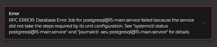

During initialization after re-flashing, the following message popped up and initialization “froze.”
What is your suggestion for the next steps?

Hi Hugo!
We’ve seen this error before. It’s most likely caused by database corruption. To fix it, you’ll need to reflash your system with a development build of StartOS. Use SSH to clean the corrupted directory and flag that the migration needs to be redone. After that, reflash with the standard StartOS build. If the data on your StartOS isn’t critical, it’s best to wipe everything and start fresh.
