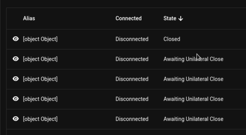

Also in RTL there are 15 channels awaiting unilateral close, but it has been 2 months.

The only thing is that the 15 channels were openend by CLBoss, never properly openend but were all still stuck pending for a long time, so I forced closed them. But there are now stuck in awaiting unilateral close for a while (longer than expected >2 months). I’m properly connected to the internet, blockchain is synced, have reinstalled CLN and performed a rescan.
In CLN it just shows the 25k sats, but in RTL it shows this, with disconnected peers, even though I am connected to other peers.

1 confirmed closed channel, closing complete, but peer is not connected
15 channels are awaiting unilateral close, but the peer is not connected
All funding transactions cannot be found in the mempool or a block explorer. Even from the confirmed closed channel!
If I try to connect to the peers I get error 401, error connecting, tor server reply host unreachable, connection refused
I don’t think it’s my connection, because all blocks are coming in, I succesfully openend and closed other channels before. These channels are the remnant of CLBoss.
Tried to reset my tor connection, but having the same error.
They’ll await unilateral close forever since they don’t exist. No funding TX means the funds never left your server.

Solved.
lightning-cli dev-rescan-outputs solved my UTXO problem, the incorrect non confirmed UTXO got removed
after that I still got the min_emergency_sat error, but after forgetting the onconfirmed channels with lightning-cli dev-forget-channel $NODEID, CLN accepted the sending of the remaining UTXO’s.
