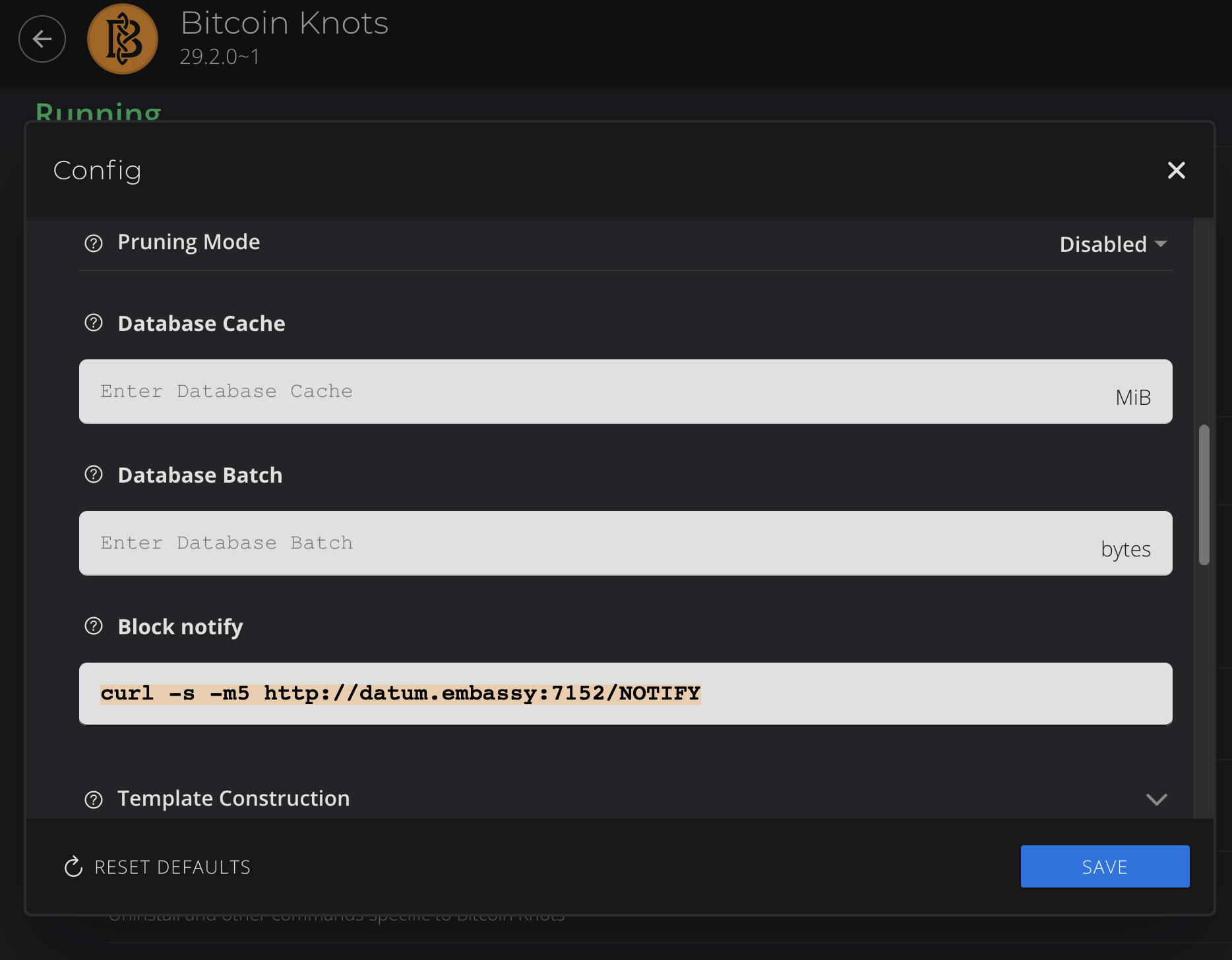

Do you actually have Knots installed? This is the error you get when you try to use the Datum with Core and try to autoconfig.
In any case, if you go to Config you can add the required field.
curl -s -m5 http://datum.embassy:7152/NOTIFY
Yes it is knots, and that has been added into blocknotify, that is why im confused by the error.
Mine did this as well on the initial attempt to run DATUM, was resolved simply by restarting Knots and then DATUM.
Hi All, the issue has been resolved
I believe it was an issue with my router settings. Once i updated them i uninstalled datum, restarted knots and resaved the blocknotify address
I then reinstalled datum, inserted my wallet address. Then started the process. Then worked
