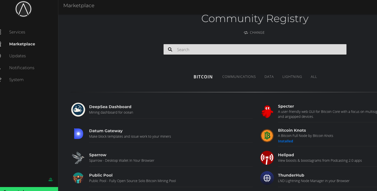

Thank you Alvaro! When you say that Jam is on the "main Marketplace (on the Bitcoin tab), I’m not seeing it. I’m guessing that when you say “main Marketplace” you are referring to the left side of my home dashboard on my Server One. Here’s what I’m seeing. I pasted a screen shot, but it’ not showing up in this message.
Anyhow, there are 8 items and Jam is not one of them. Am I missing something?

Your screenshot shows you are currently in the “Community Registry”. Click the “change” icon/button and switch back to the “Start9 Registry”. It’s there.
